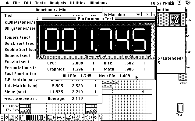

I did some tests and I confirm I cannot reproduce the pattern you see (before/after sleep).
Before / after has no impact and for some reasons I also get better scores than you get.

Mac OS 6.0.8 with my old 3MB card
After sleep:
Hmmm maybe the psram on 7MB is being set into a low power/low performance state during sleep and doesn't recover.
