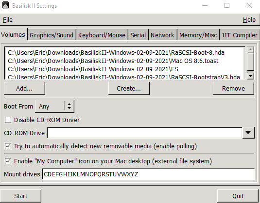

Basilisk II doesn't care about the file name - I just hit add or drag the file into the Volumes window. If for some reason your BasiliskIIGUI does, rename the file to something it accepts. There are no standards. Version 1.1+ of BlueSCSI ignores file extensions because of this. You can even see the drive `ES` has no extension and it was created with the create button in the GUI.

Maybe a difference between windows and Mac version of Basilisk II. On my Mac version, when I go to the file browser and cannot select .hda files.

Actually, it's looking like some sort of bug, because I just moved all my hard drive images to a separate folder (I was embarrassed at the state of my Basilisk II directory taking screenshots of it), and now some allow me to select them, but not others.
Odd. Maybe I'll post in the Basilisk forums to see if the creator has an explanation for what I'm doing wrong. It always threw me because for RaSCSI and BlueSCSI, people kept telling me I could use the disk images in Basilisk and I couldn't figure out what I was doing wrong. Anyway, it seems like I have a workaround in the meantime. Thanks!

See my latest on other odd behavior. There's certainly some odd behavior with Basilisk's file dialog on the Mac. I've tried renaming some of the .hda files to .img and they can load fine in Basilisk. However, when I change them back to .hda I can no longer select them. Unlike some of the other files, which I renamed, loaded in Basilisk, then renamed back to .hda, and now they are selectable. Very odd. The good news is it's easy enough to name them .hda.img and then rename them to a .hda when I throw them on an SD card for BlueSCSI.
