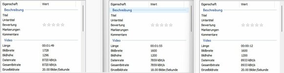

I have tried your January firmware first than reloaded the stock firmware D. All this proceeded with no problems at all. I was able to scan a film with your firmware and after that with the stock firmware D. Since I encountered no problem I take it that I have version D for serial K2225148BK00779. Or do I have an even newer kind of firmware? In the attached image you can see the on the left the basic data after scanning a film with my original firmware. In the middle is the result using your firmware. 18 pic/sec works and the resolution is as described - but lower than on the original firmware. Reverting to the stock D firmware (on the right) returns to 20 pic/sec but the marginally better original resolution is not reset. Exposure seems to be better in your firmware but sharpness is not visibly improved. Bitrate has even decreased slightly. What do you make of this information?

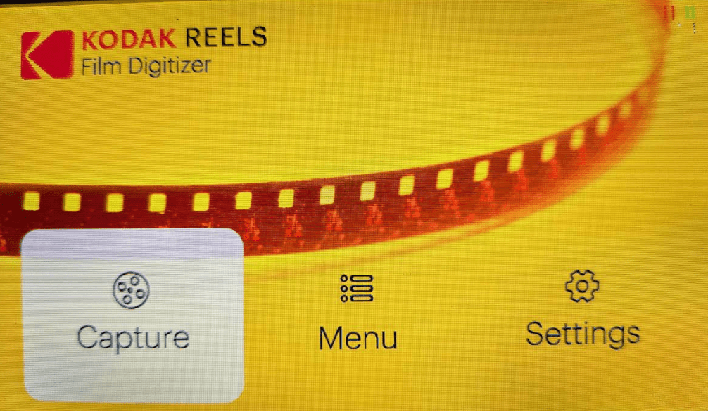

I wanted to take another shot at the post #509 firmware to make sure what I saw wasn't operator error on my part. For the load I did in my post #510, I used a 128GB SD formatted to FAT32 which has been working for me but the guidance here recommends 32GB or less formatted to FAT32. I downloaded a fresh copy of the post #509 version to a 16GB card formatted to FAT32 and flashed the Reels again. Unfortunately I had the same outcome but I did grab some pics of the screen. Not sure if they are helpful but @videodoctor asked about the debug rectangles.
On power-up, the film "initializes" or advances a frame or so as you would expect before the screen goes inactive. I also rapidly pushed the OK button to get it to capture before the screen locked up and it did mechanically behave as expected, advancing the film and appearing to capture frames. The only way to stop though, is to long press the power button and no file was saved.
I was again able to revert back to the post #225 firmware and scan a reel with results that are still better than stock.

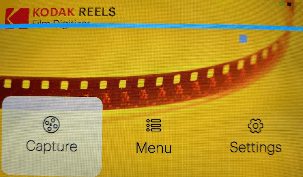

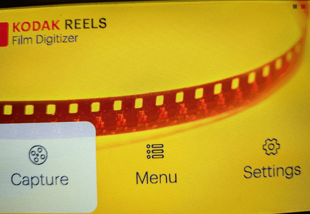

I apologize if my last few posts confused some. For clarification, I have a type D unit, serial number H2825 and I'm trying the @videodoctor new drops. This post is to report on the drop from post #513
For this drop, after initialization, the expected screen displays but the unit is unresponsive with no mechanical advance and no response when trying to quickly press the OK button before it locks up.
As far as the debug squares, I'm seeing vertical lines at the top right, two green at the far right, and two red to the left of the green. There is also something below the green but I'm not sure what that is. A picture of the screen is below, and again, reverting back to post #225 firmware was successful.
Is there a limit to the number of times the unit can be flashed or a risk that flashing too many times will brick the unit?

I apologize if my last few posts confused some. For clarification, I have a type D unit, serial number H2825 and I'm trying the @videodoctor new drops. This post is to report on the drop from post #514
I too received these exact same results with the colored bars showing up in the top right corner. The machine was locked up and unresponsive to any button presses except a long press on the power button to turn it off. Serial # H2825148BK01686

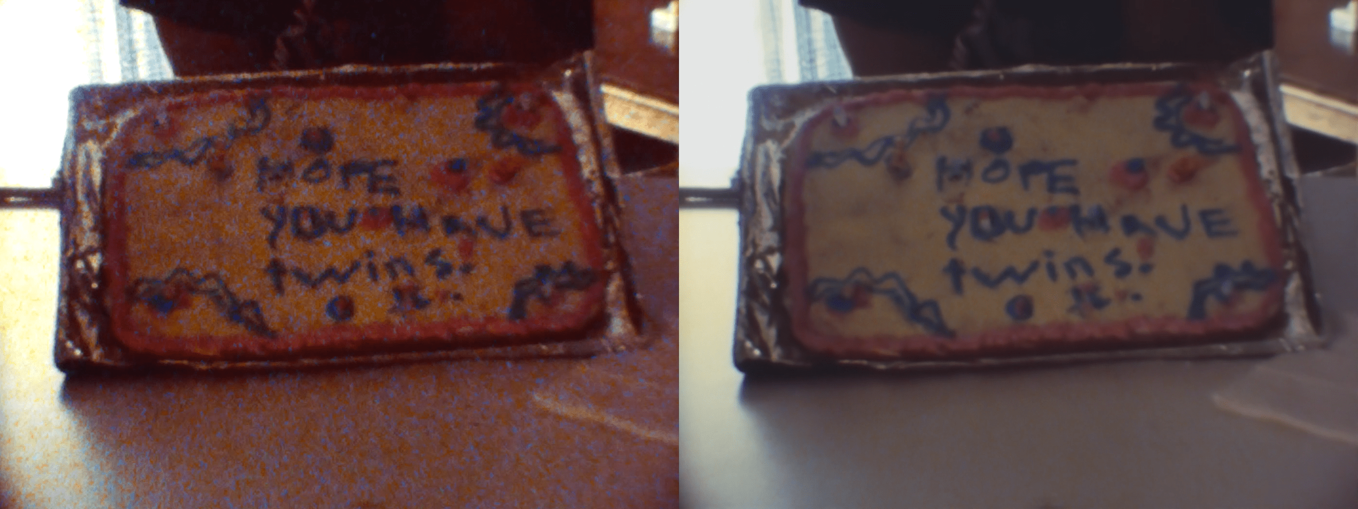

Hello everyone,
Just before the New Year, I received the components necessary for upgrading the lens on my Type C system. Since then, I've finished all of the physical upgrades, and thought everyone might find my process informative. My first approach was to utilize the part files 0dan0 had graciously provided, but as I progressed, I decided to design my own parts. I've got FDM and MSLA part printing capabilities at home, so iterating the designs was relatively simple and they did the job I needed.
At the end, I've put together a comparison image attempting to show the detail improvements I see with all of the physical upgrades. I hadn't seen this type of comparison before, and I found it helpful to qualify the investment I've put into this humble consumer scanner. I hope that it helps answer questions about whether or not upgrading the lens is worth it (I'm convinced!). Note however that I've only been using V6.6 firmware up to this point and that's reflected in the comparison image. I'm looking forward to trying the newest FW versions in the coming weeks!
Thank you so much for all of this @Deano !! Very useful and helpful!! 👍

Thank you for trying to improve the Kodak Reels for version D users. I have tried your new build and this is what I found:
1. It boots and shows the normal screen, but apart from the on/off button nothing can be executed
2. Yes! At position top + right there are 2 small squares, the left one is green and the right one black
3. See 1
4. No, not even before recording
5. I can not start recording
Reverting to the stock version D works fine.
Looking forward to a new release...
Thank you for testing! Without the UART serial connection, it's hard to say where / why the lockup is happening. AFAIK, you shouldn't have issues the number of reflashing attempts. Just make sure you never power down the unit while flashing. :) I'll be back at home with my D unit in a couple of days, and I'll do more testing on my own before posting more builds to the forum. Thank you again for testing!
