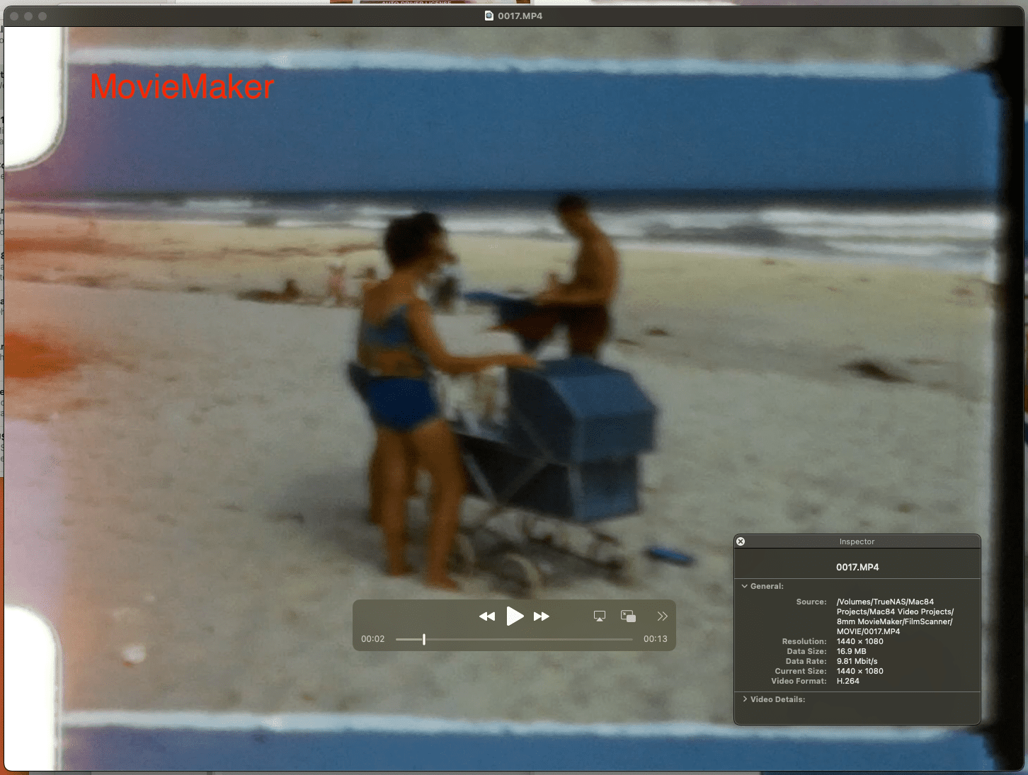

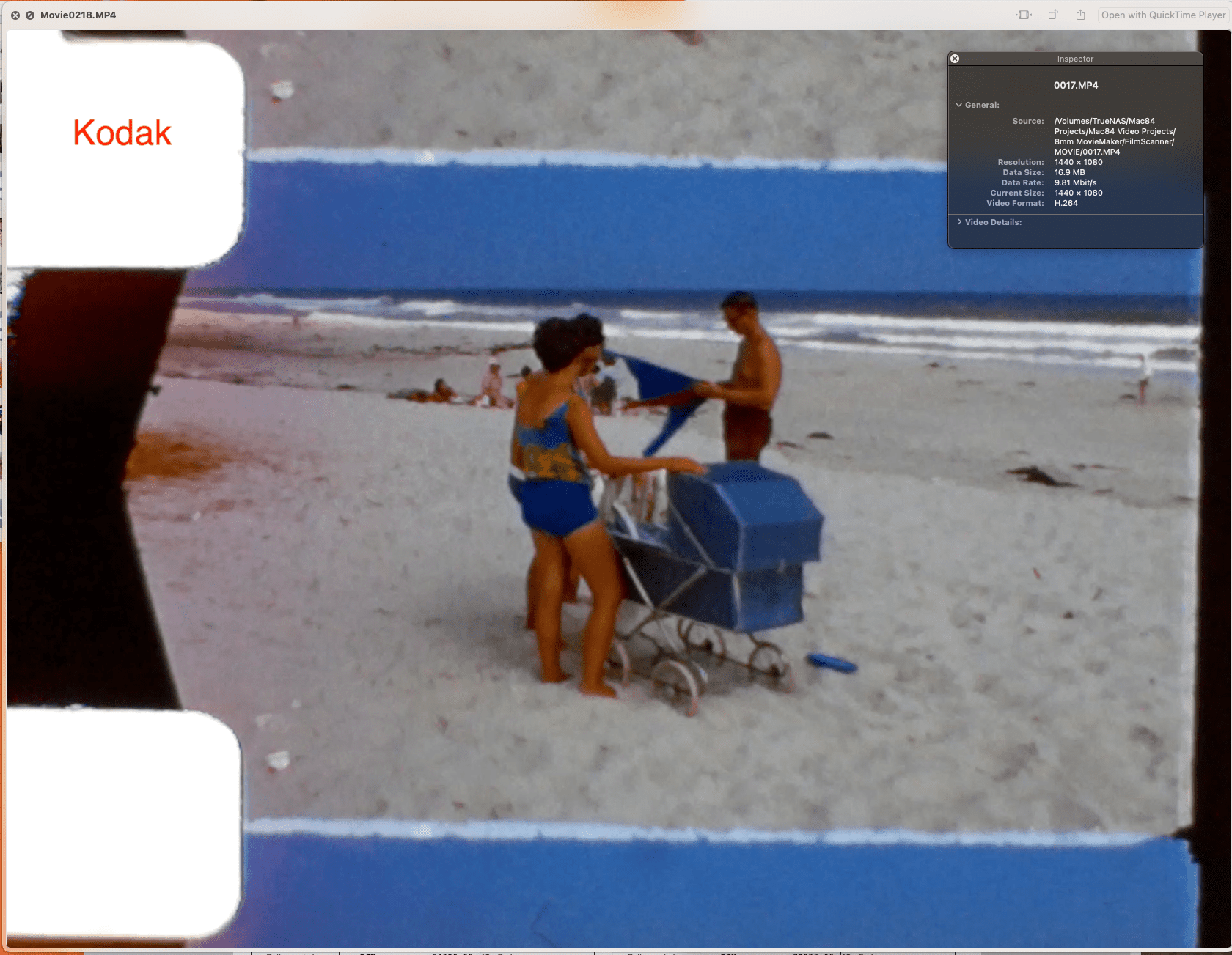

I just thought I'd share something briefly. A company reached out to send me a Movie Maker Pro for review. I just took it out of the box and was curious how the capture quality compares with the Kodak.
I'm unsure if I got a lemon or what, but the Movie Maker seems to be wildly out of focus!
I hope to do an in-depth review and tear down of this product in a future video, but I thought you'd all appreciate a quick look. The top screen grab is from the Movie Maker, the later from the Kodak.
View attachment 27785View attachment 27784

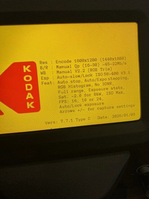

i bought my unit about 12 months ago and copied a number of cines. My serial number indicates it is a type c unit and so i downloaded the latest c firmware which appears to have been sucessfuully installed(see attached picure of the flash screen. everthing seemed to work and when i went to record the display screen seemed to be right but when i pressed ok the attached strange screen appeared ( i now find itt has been saved a .mov file) and nothing happened and a short period it returned to the display screen. i tested the rewind function which worked ok. any suggestions
I remember seeing that before. It could be that you simply need to power it off after the successful firmware update, and power it back on to use it normally. Or if it's not that, please report on what size and format you're using for your SD card for capturing?
edale
Apr 24, 2026
i have tried 3 different sd cards kodak 32gb, kingston 8gb, sandisk 4gb all with the same resuit. i slso treid to load the previous firmware version 7.3 and then turned off with same result. i have read the user guide and i seemed to have followed the guide. however i do not hace osd options on capture but i presume this is because my software has not reached that part of operating instructions. Do youi suggest that I try version 6 or before or eveb download orginal version and start again?

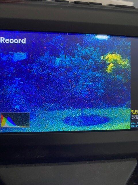

I have now had the chance to set out the new firmware and comeaccross 2 problems i do not seem to able to access some of controls eg setting fps rate . Secondly when i try to replay a recording most of the time nothing happpensd and i cannot then either scroll down the screen or return to the main menu none of buttons seem to work. Occasionally if i hold down to button to replay the screen comes up but ask to restart which takes me back to begining. Any ideas should i reinstall firmware?
What are the first 5 digits of your serial number?
