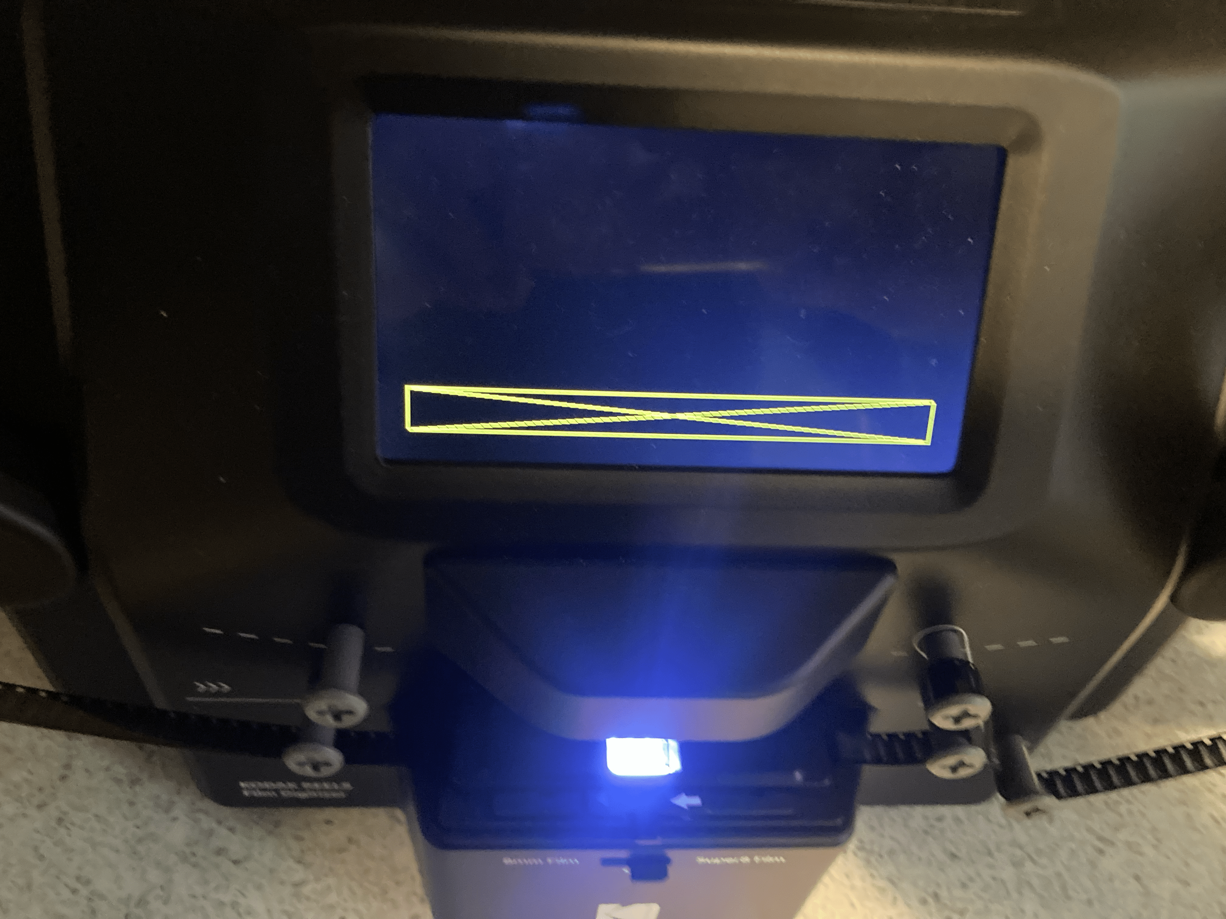

Hello, I hope someone out there can help with this issue. I've got myself into a bit of a downward spiral having tried the firmware updates. Has anyone else experienced this screen before and if so what does it mean? All appears to be fine but this appears when "record" is selected and it's impossible to proceed beyond that. Grateful for any info! And could someone point me towards the link for the original Kodak firmware please; I think I want to try to restore the factory settings, make sure everything works and then start from the beginning again. It's a RODREELSEU model, Serial number is C1725148BK00614, which I assumed to be a "C" model but I'm wondering if this is correct, any thoughts?
Don't you have a firmware file on the card? That's what happened to me with the forgotten file. Or a different card format, it should be FAT32.
Thanks for the reply. Strangely, several hours after installing the firmware, the problem seems to have resolved itself and that strange screen is no longer appearing, no idea why! I do have a few other issues and queries but I'll put these in a new post.
in case anybody else has this problem the answer is erase the sd card with the kodakreels software and then restart it should then work

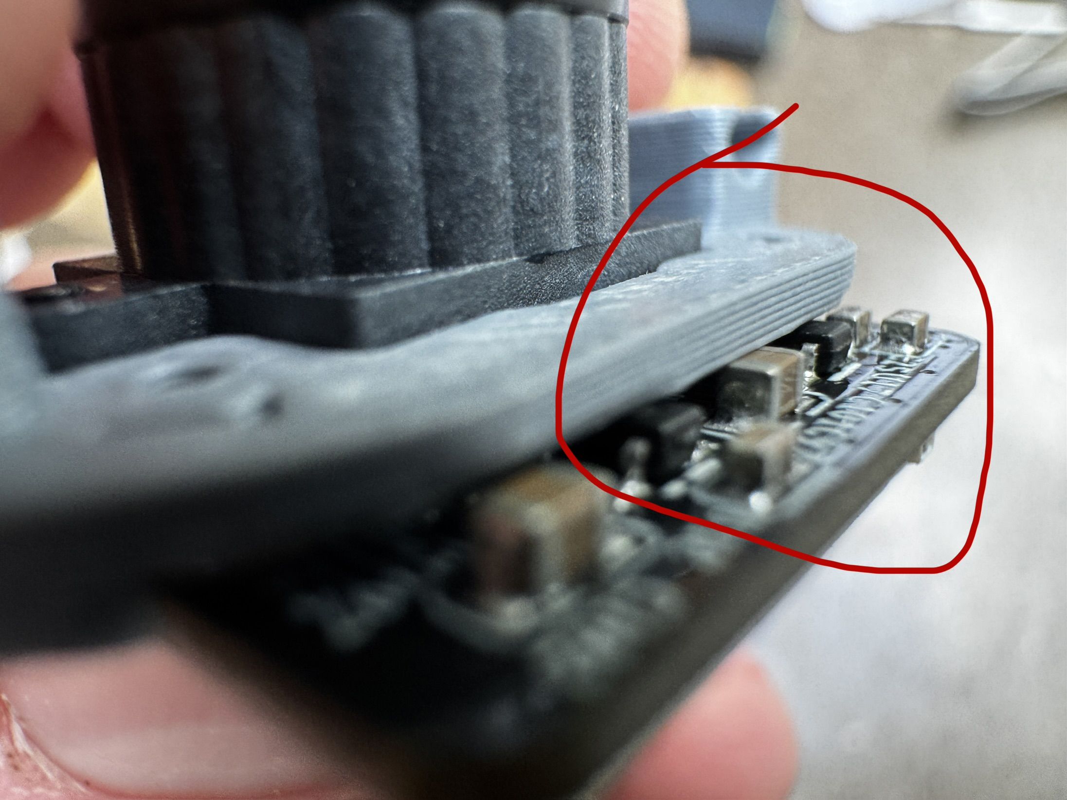

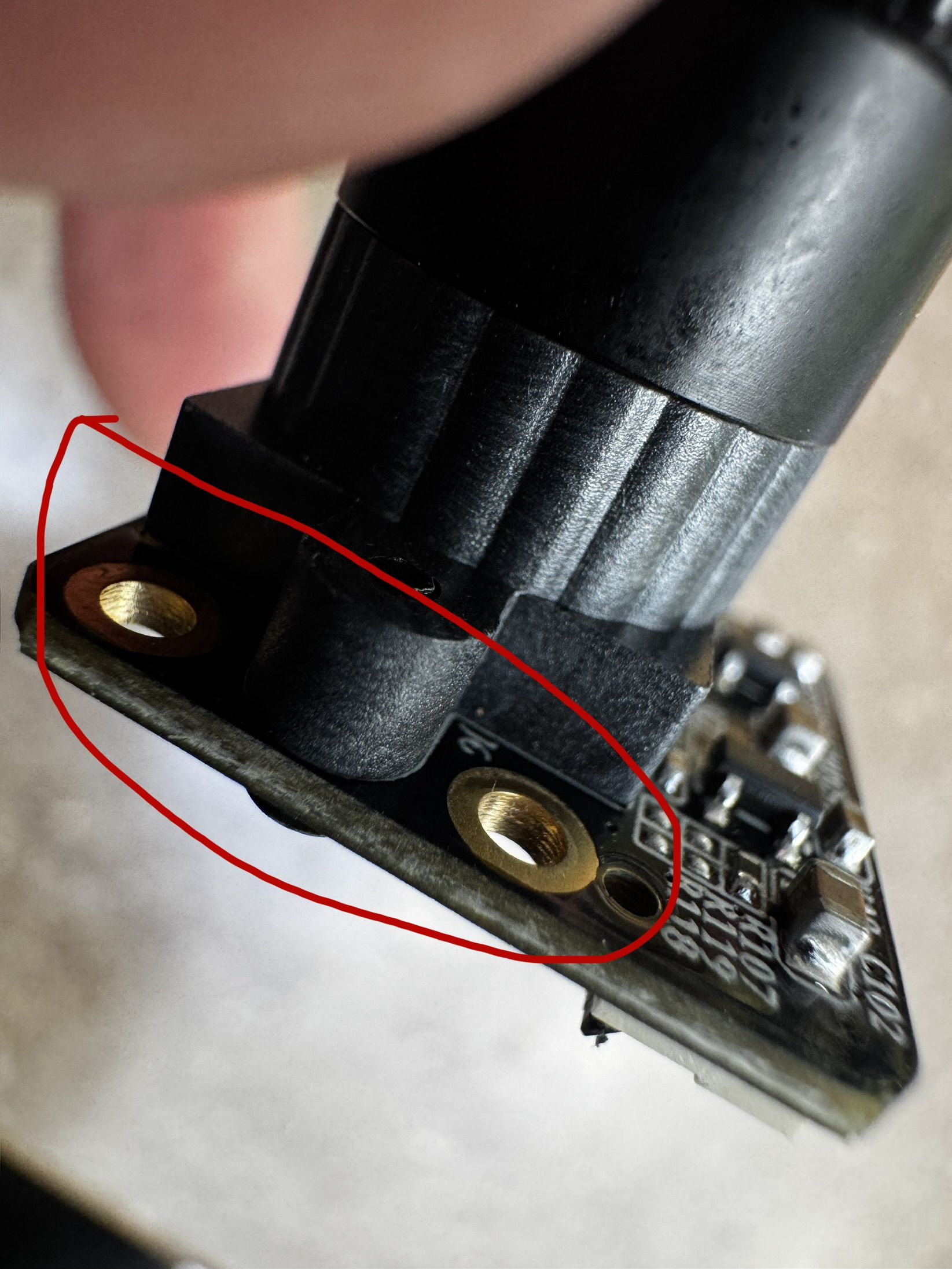

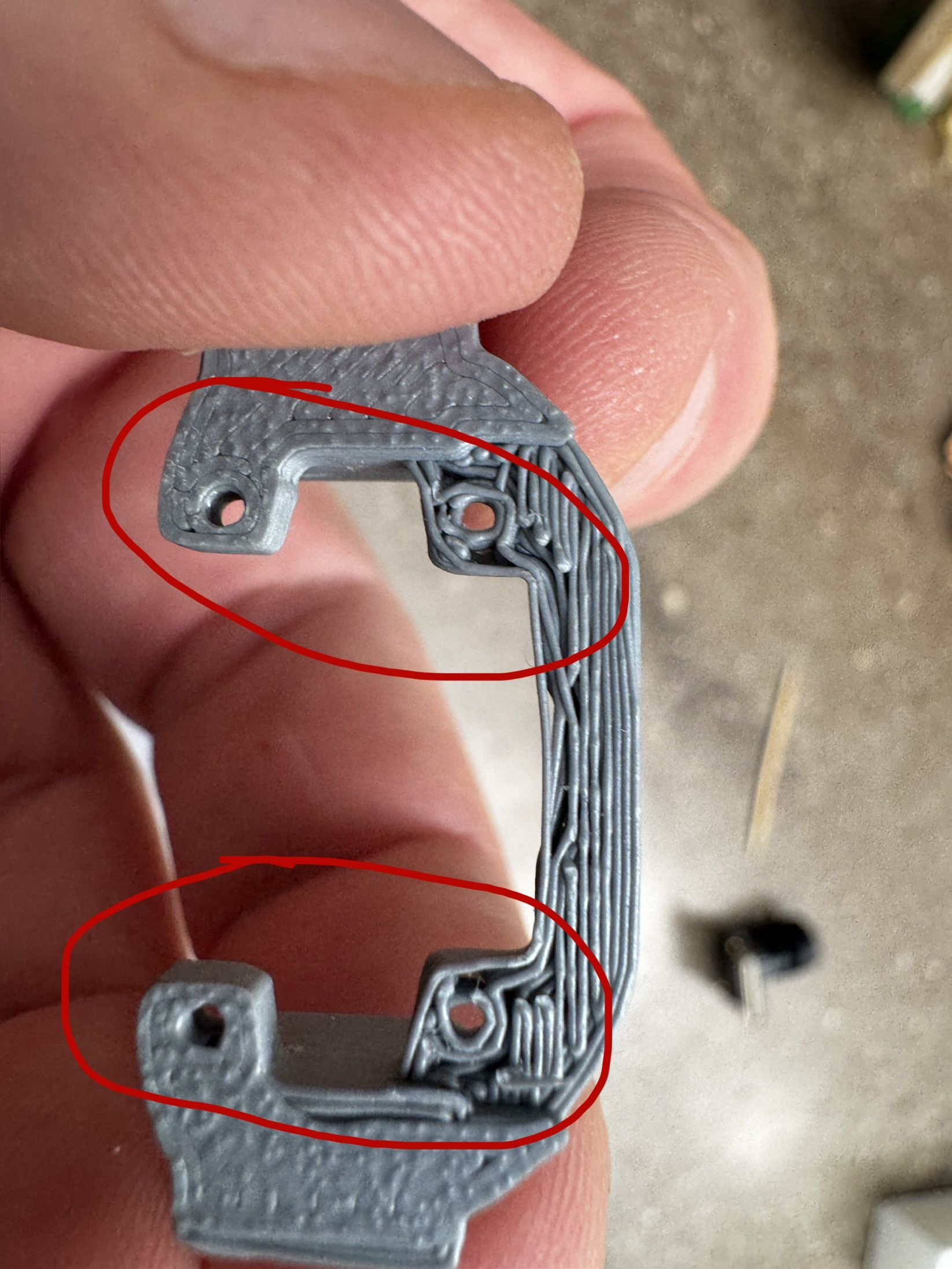

WowIndescribable
Dec 17, 2025
I’m installing the 3D printed spacer for the upgraded lens and have questions.
it seems that the back is resting on one of the board components and this doesn’t look right. If I assume a bit needs to be filed away so this doesn’t happen, then it would seem that the recessed part of the 3D print does not allow for all four screw locations to sit flush on the same plane with the board.
i hope that is clear from these photos. Am I missing something?
Did you print with support?
