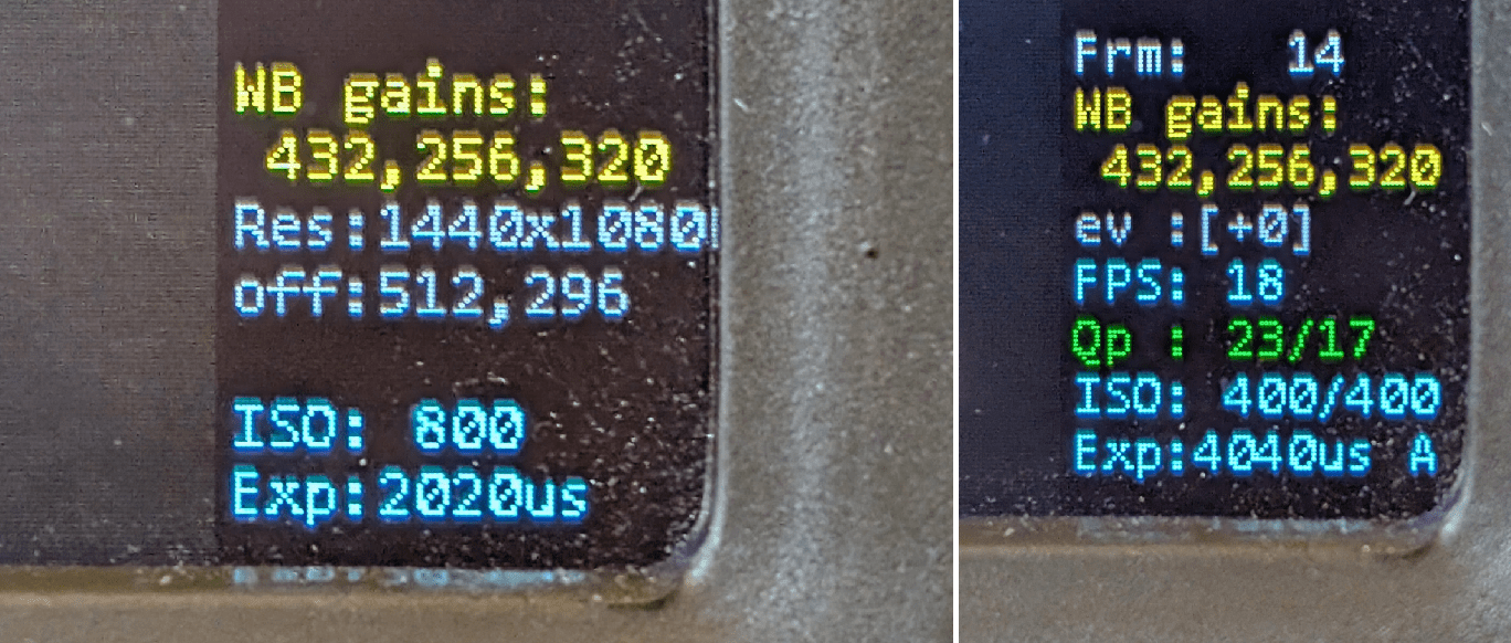

New to v7.7
- stats and controllable field are written off the video image (bottom right corner.)
- there is now an ISO Max control, supporting 100,200 & 400 ISO settings. Defaults to 100.

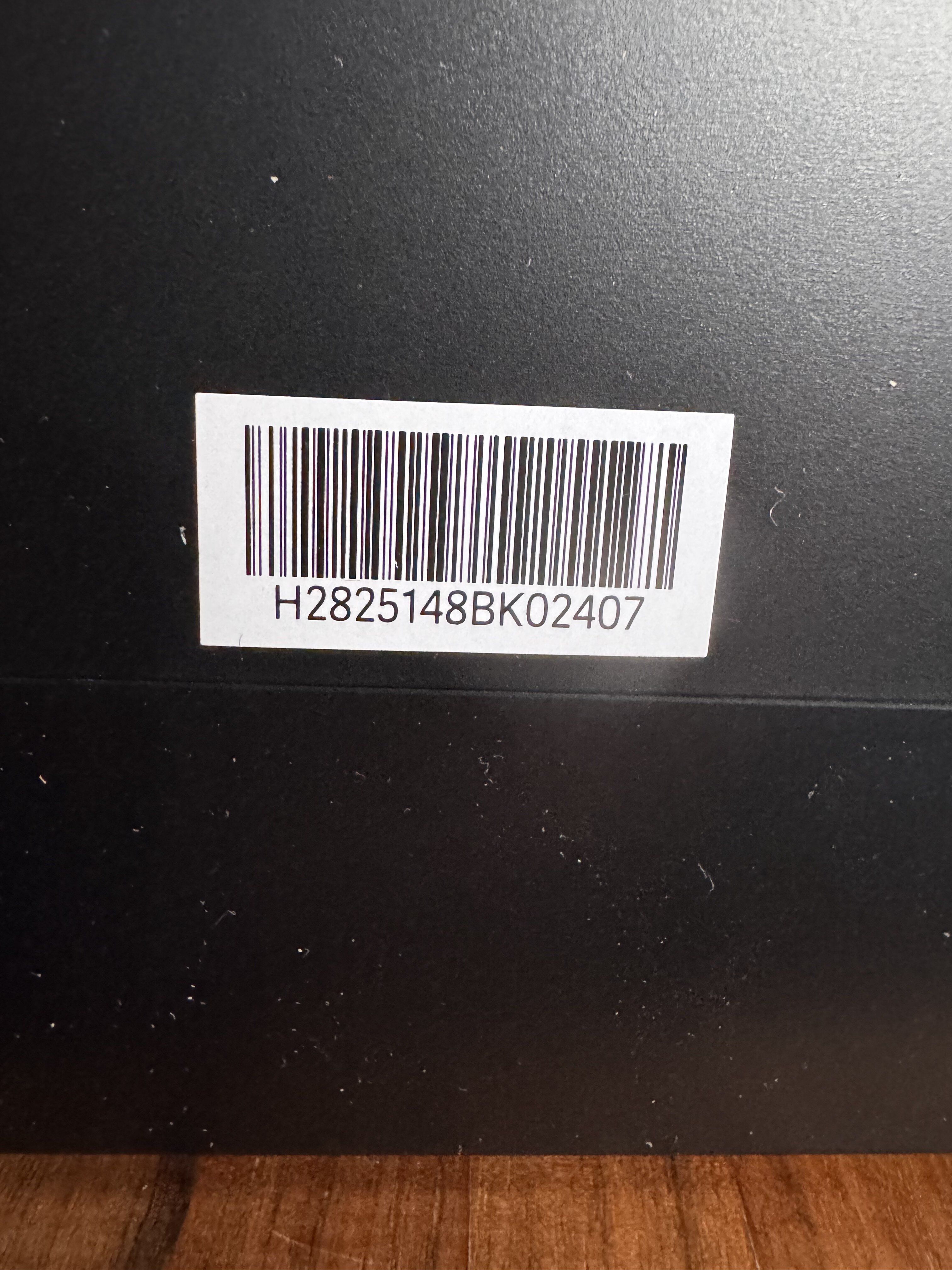

I too am very impressed by this very activ Forum, which inspired me to order a Kodak reel. I am based in Europe and sadly I received a D-Typ yesterday.
(H2825148BKxxxxx). So I guess I will have to wait a while till I can install the new Firmware, is that correct?

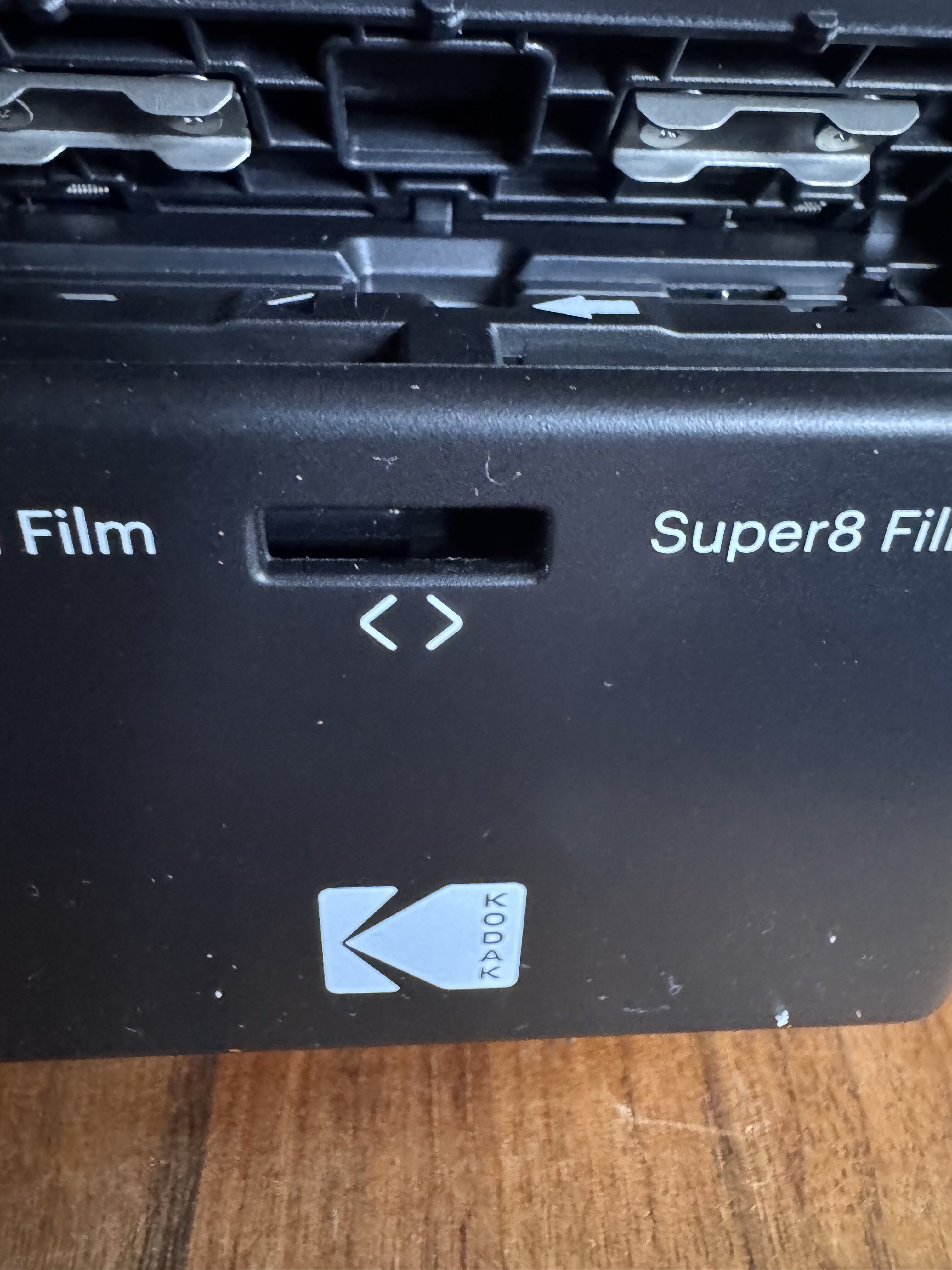

Also after unpacking I noticed that the 8mm to super8mm handle was stuck about 1/2 cm under the opening and also the SD card reader was not aligned with the slit of the cover. After opening everything, I could shift the loose mechanics into the correct position. It works all fine now, but has anyone had the same issue?

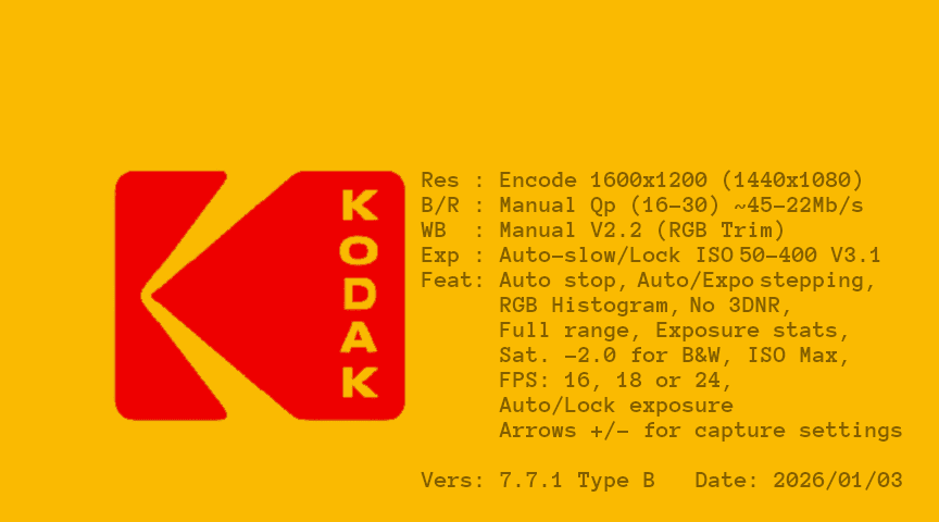

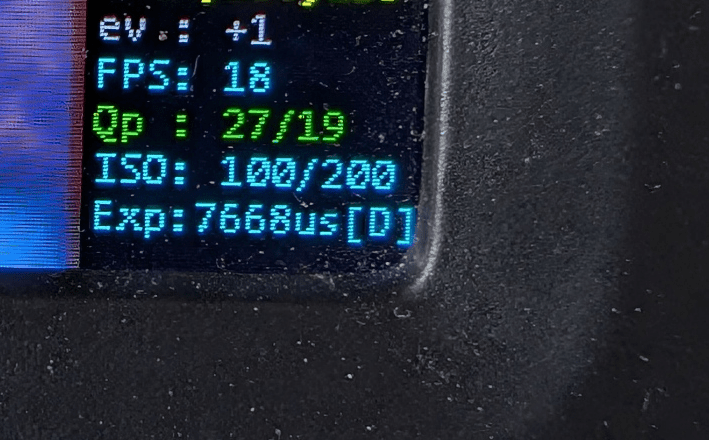

@0dan0, thanks for the v7.7 update. It seems to be working well on my Type C scanner.
I like having the stats/settings over on the right side, to not obscure the scan preview - well done!
ISO Max setting works well. As you you had mentioned previously, the ISO does not exceed 400 during encoding, but I do find it slightly curious that during preview it will register as high as 800. Not sure if that's intentional or useful. I might suggest setting the preview mode ISO to be consistent with the encoding process (do not exceed 400, unless the max setting is lower).
Another minor suggestion is to move the ev setting down in the list, below the Qp since that would fit better with the other exposure-related settings.

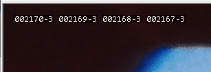

v7.7 is getting close to all the features I would want for MP4 encoding film scanner. The main remaining fix is to either prevent or at least detect the jitter, so that scanning hours aren't wasted. For this I will need your help. This v7.7.1 build only add a hidden debug feature, if not enabled, it will run just like 7.7.0.
To enabled start a capture, navigate to the exposure control [A], and change it to [D] for Debug (by pressing + twice).
Then stop the capture. It is all the next captures that will now contain some debug information written into the two left corner of each MP4 frame (except the first.) This is what the debug looks like:
I looking for all sample captures that have obvious jitter, where the scanner if grabbing while the film is still moving.
Jitter with debug:
I only have this one example (so far) as jitter is rare for me. This is the over-exposed first frame type, but the frame cadence in the debug is also off.
So if you have time, please share some jittery captures with me. I only need 60-80 frames of capture (from the start), just enough to see the jitter, and I can see which frame the scanner encoded (via the metadata).
Let me know if you want an explanation of the metadata.

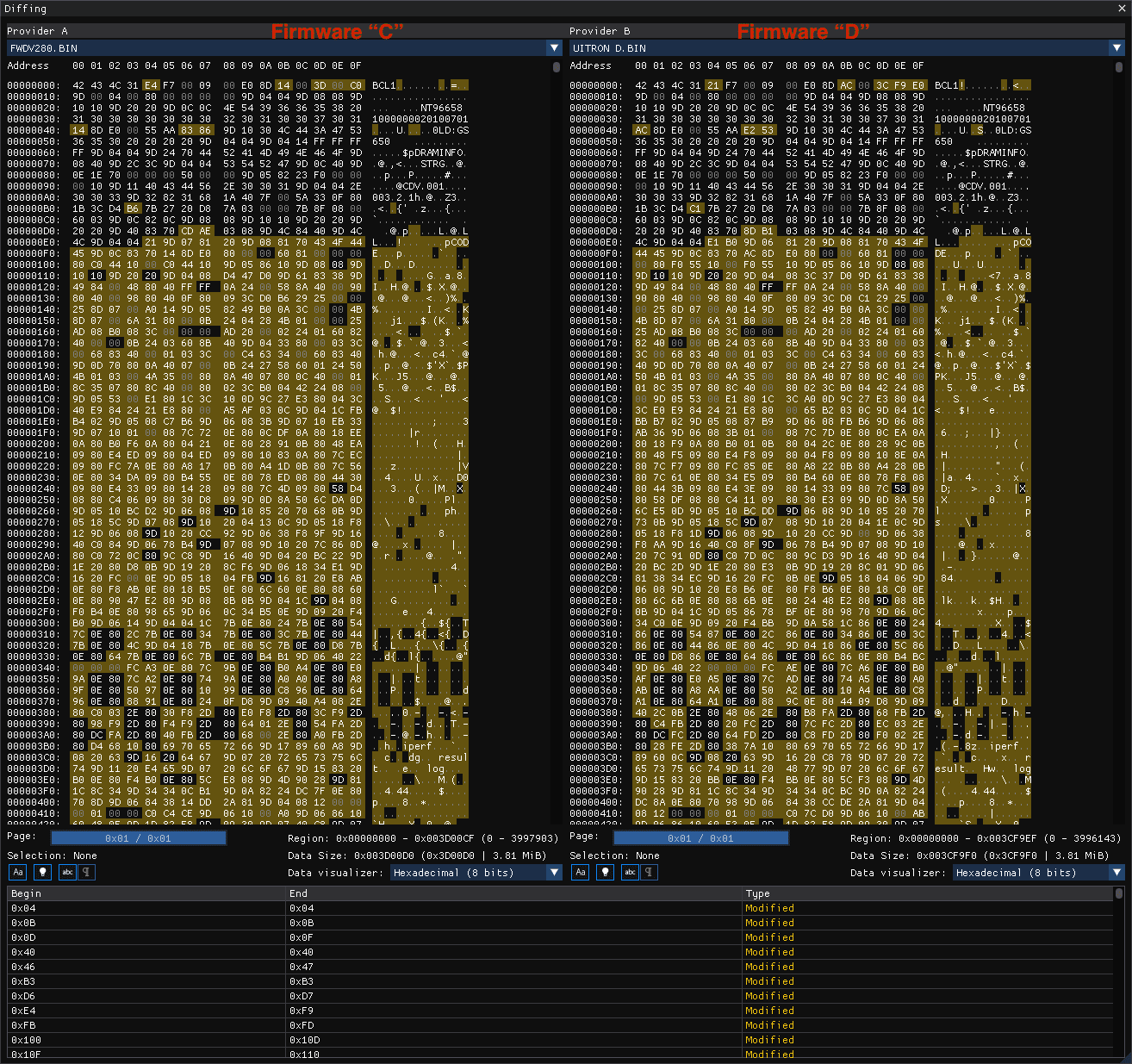

Here's a comparison between C and D, lots of code changes!
Let's see if the above solves the issue for @JKCalhoun 🤞...

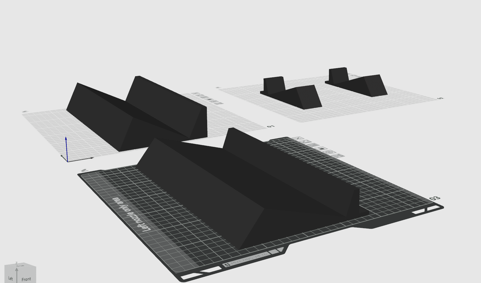

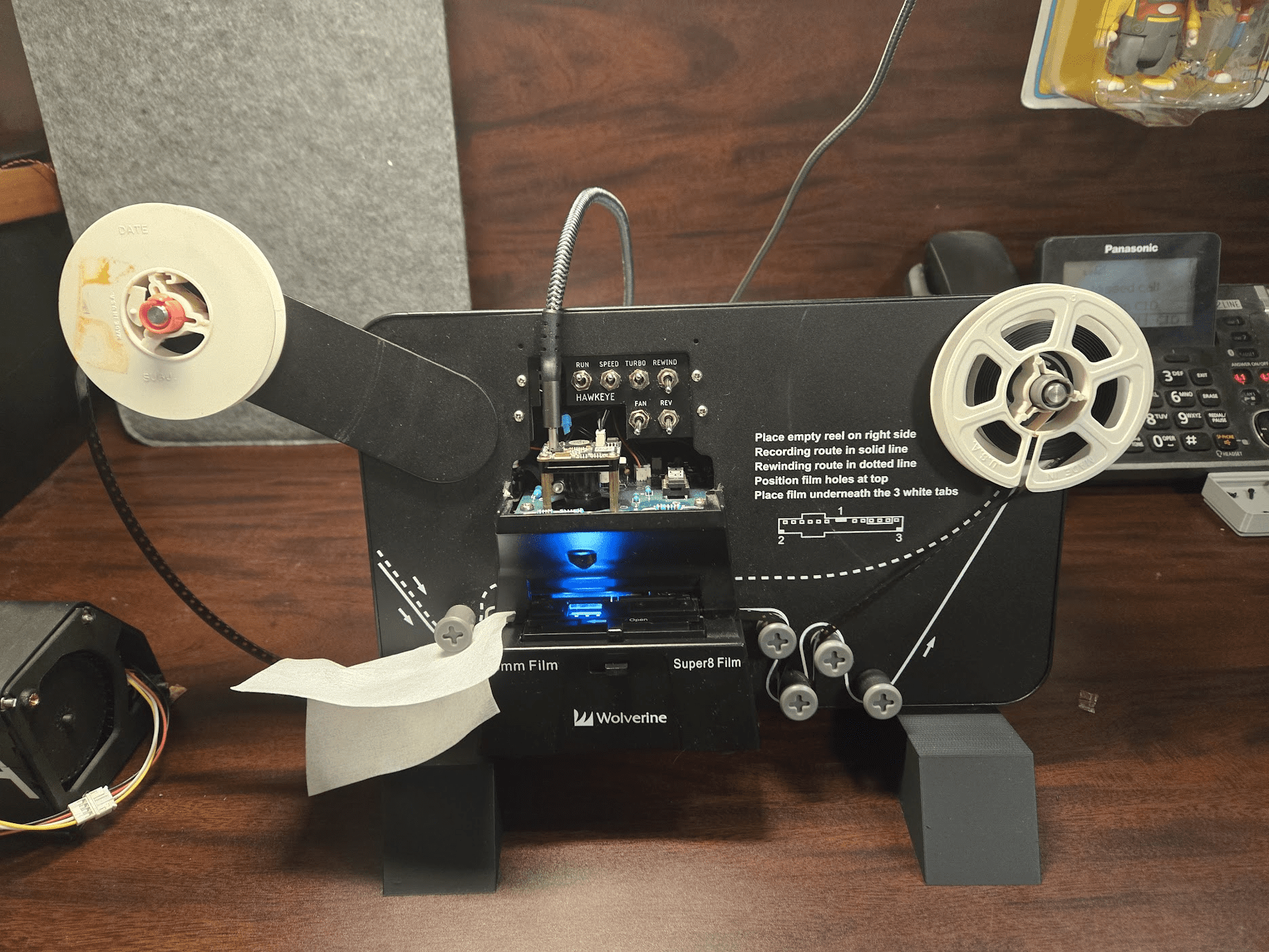

Hey all! I've been working on a stand for the Reelz and Wolverine.. There will be a 3 varients for you to choose from. First one is 2-3 wedges for you to place wherever you see fit. The other 2 are for 300+mm print beds and one angle is about 35 the other is about 20. These wedges make it much easier to face you while working on it. Personally i like the 20 degree one, but if you're taller you may prefer the 35. Pictured below is the 35 and the wedges.. 20 is on the printer now.. Stand by, should have these ready tomorrow or so.
