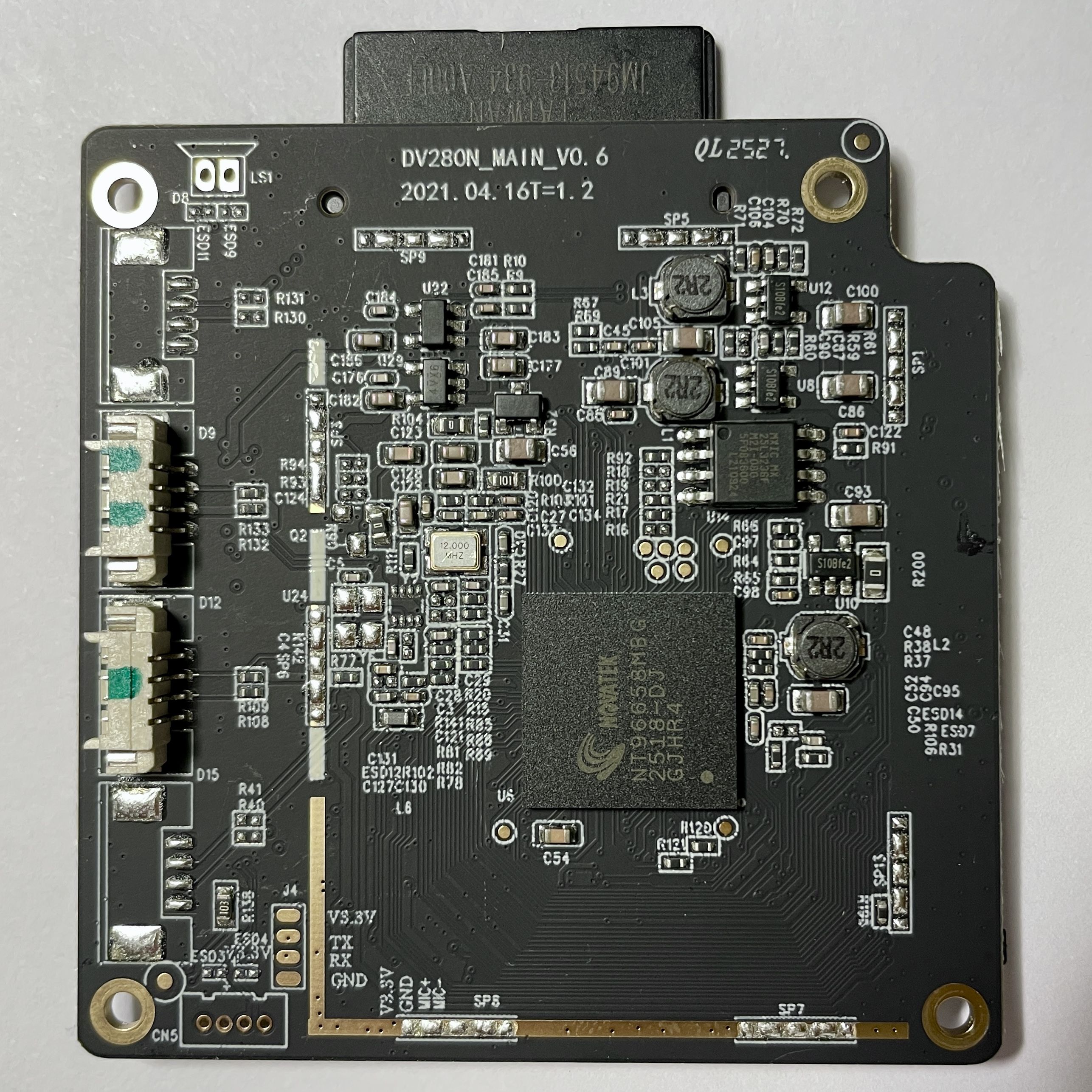

ph4z
May 20, 2025
27
Thanks to the advice here. I got my replacement unit and have no skipping issues anymore.

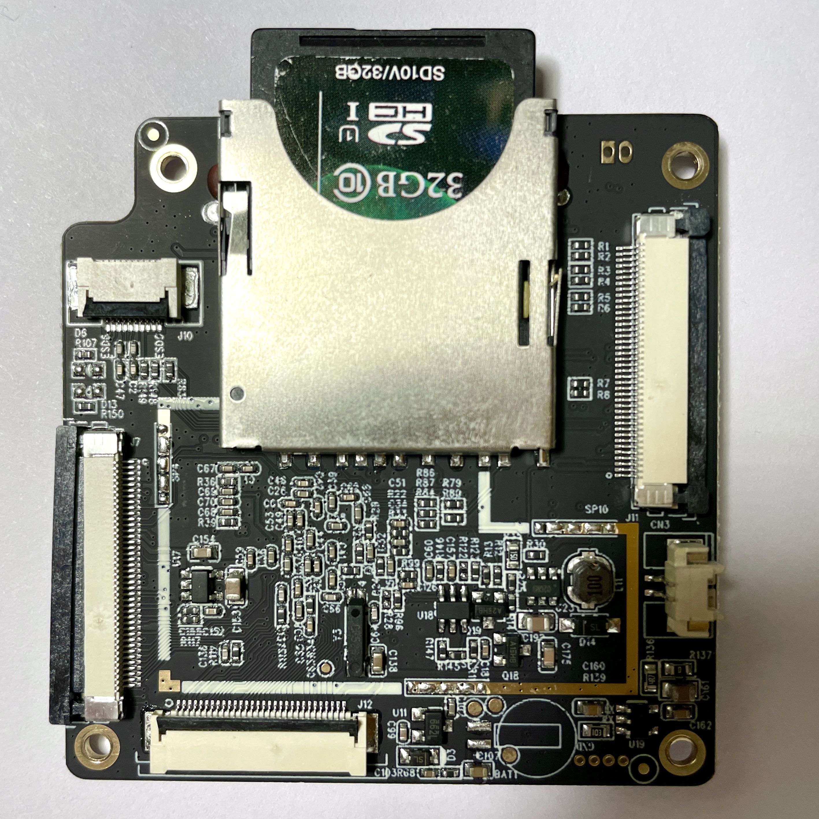

It is also a D variant. I took a stab a disassembling the unit tonight. I’ll do the soldering and dumping later this week.
I followed Mac84’s stream to see what the process entails. I found it quicker to take the LCD and then straight remove the board.
For now, here are some pics of the D variant board, in case that’s interesting to anyone. But it looks like the same board as the other variants to me.
SkipBurg
Dec 28, 2025
Excellent! 🎉
I recently did a live stream (start at the 22 minute mark in this video) where I took apart the device and soldered on three small cables to communicate with it via a UART serial adapter (I'm using an Arduino nano as one) to dump the firmware. Take a look and see if that's something you are comfortable with.
The wires are thin, but if you are experienced it shouldn't be too bad. If you have any questions let me know! :)
Here are also written instructions for opening the device and so on:
https://docs.google.com/document/d/1htmhRHyY_kEjoiTgSInV0PeXvzyXTMaXDYJ_3Ai4A4A/edit?usp=sharing
Also, depending on your location, I'd be happy to have it shipped here to modify for you.
@Mac84 I am interested in shipping my Reels unit to you.
Reactions: Mac84
ph4z
May 20, 2025
27

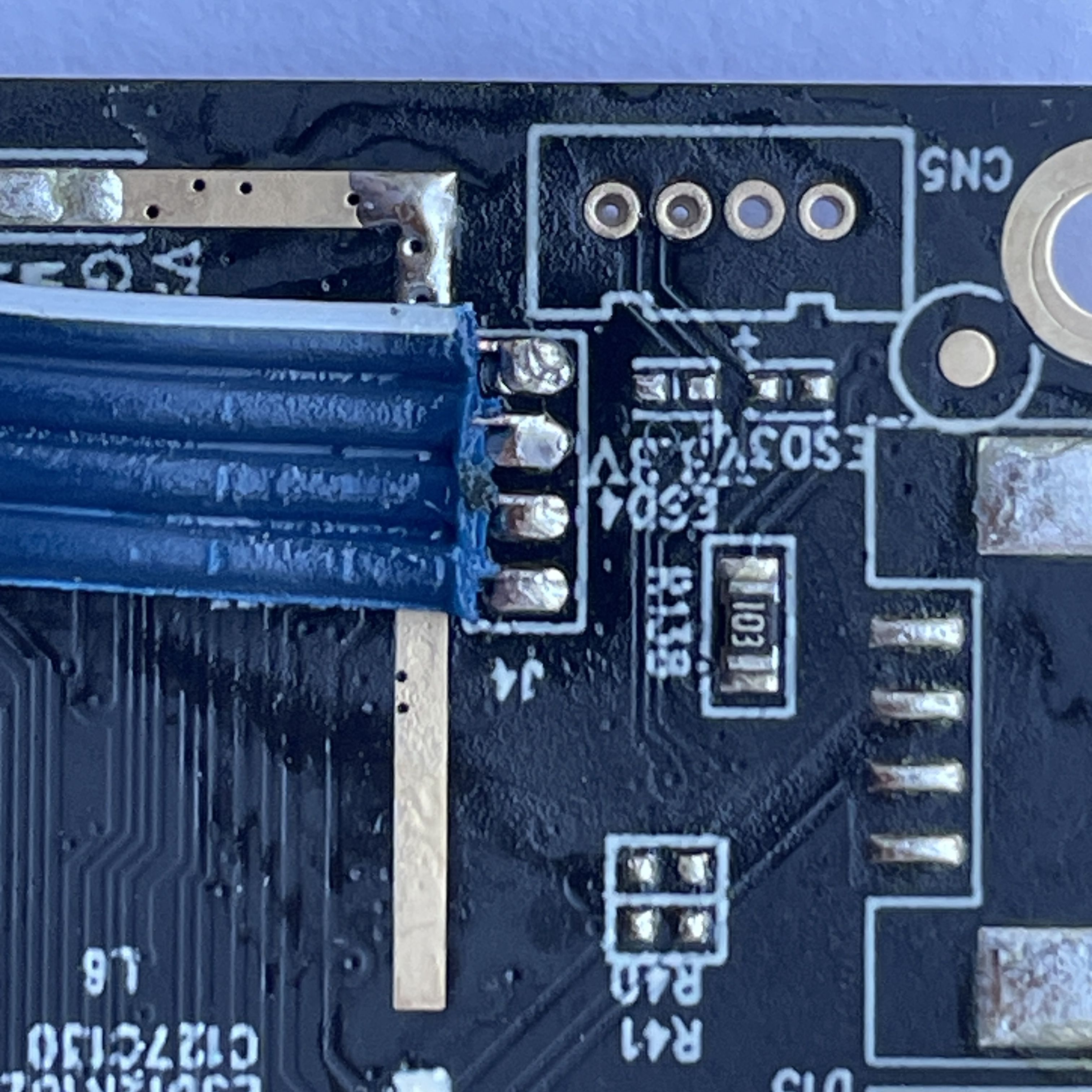

Good news! @0dan0 @Mac84 I have dumped the variant D firmware. My S/N is H2825148BK02147.
One important question: I dumped everything twice and got different md5 hashes for the DUMPCODE.BIN, but not for UITRON.BIN. Is that to be expected? They're in the a and b folders, respectively. I trust "b" more.
Thanks Steve for the good guides on dumping, this made it very easy for me. I did some thing my way, which might help others.
1. For disassembly you don't need to take out the metal assembly, instead you can get at it by removing the LCD w/ bezel.
2. Standard ribbon cable has the perfect pitch for soldering to the GND, RX, TX, (3V3) pads.
3. I used a simple USB2TTL adapter (CH340, which can do 3V3 and 5V logic) and Putty to talk to the Kodak over serial.
(not the neatest job)
Can't wait to try out the firmware ;-).
Cheers!

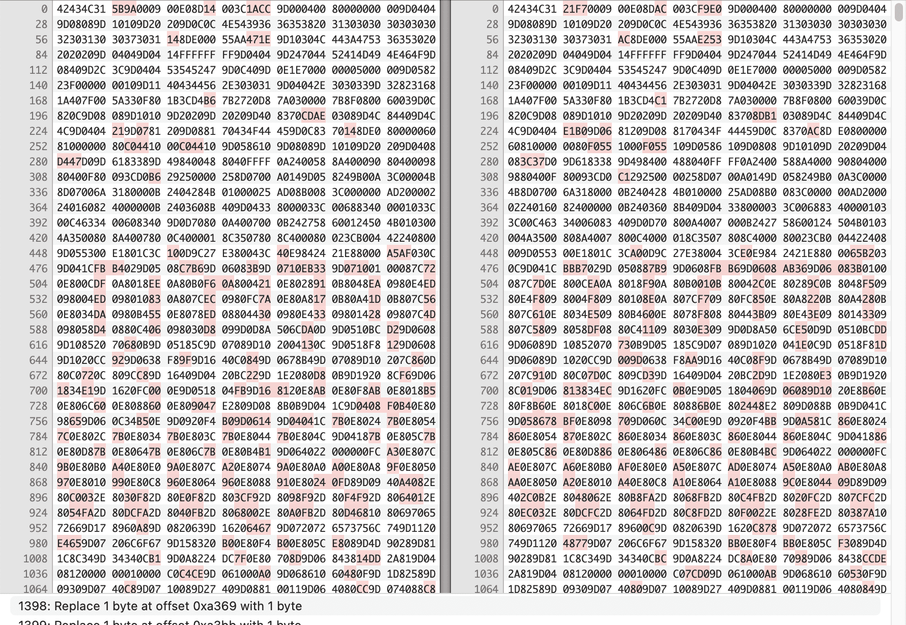

Mac84
Sep 4, 2021
315
459
New Jersey, USA
www.mac84.net
Excellent! Thank you so much for your efforts, this is wonderful! 🎉
That's good to know about the LCD way in, my LCD didn't want to be removed properly, so I assumed other units were just as picky. I've never had to solder the v3.3 pin, but I guess if your adapter supports it, it won't cause you any trouble.

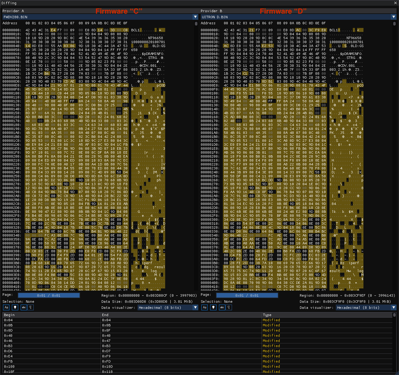

I think the "DUMPCODE.BIN" also dumps any temporary data (settings, etc) stored in the memory chip. So it could be possible that it does differ. Although usually that data is in another partition and can be removed using the unpack/repack firmware tools.
Here's a comparison between C and D, lots of code changes!
Let's see if the above solves the issue for @JKCalhoun 🤞...

JKCalhoun
Dec 25, 2025
Thanks, Steve!
Out of curiosity I'm wondering if there is a smarter "code differ" since I can see the same sequence of bytes shown as different—they instead seem to be out of phase instead. (I'll look around to see if I can find one.)
EDIT: HexFiend (on MacOS) seems to be a little less naive when it diffs.
