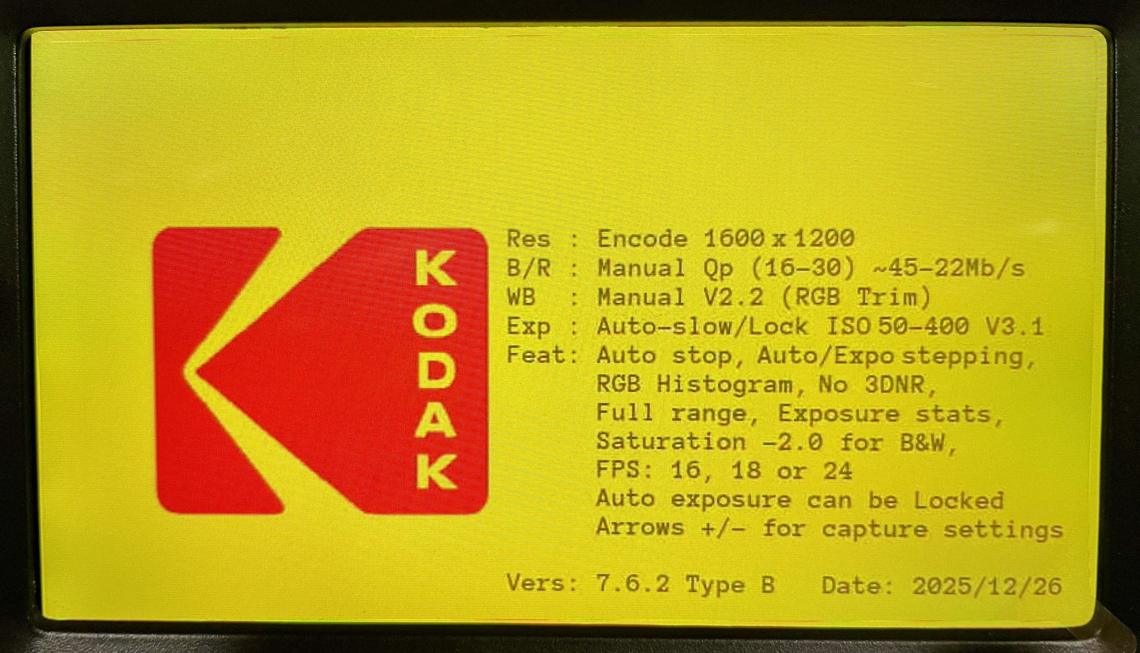

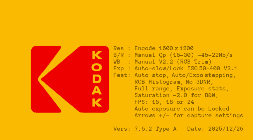

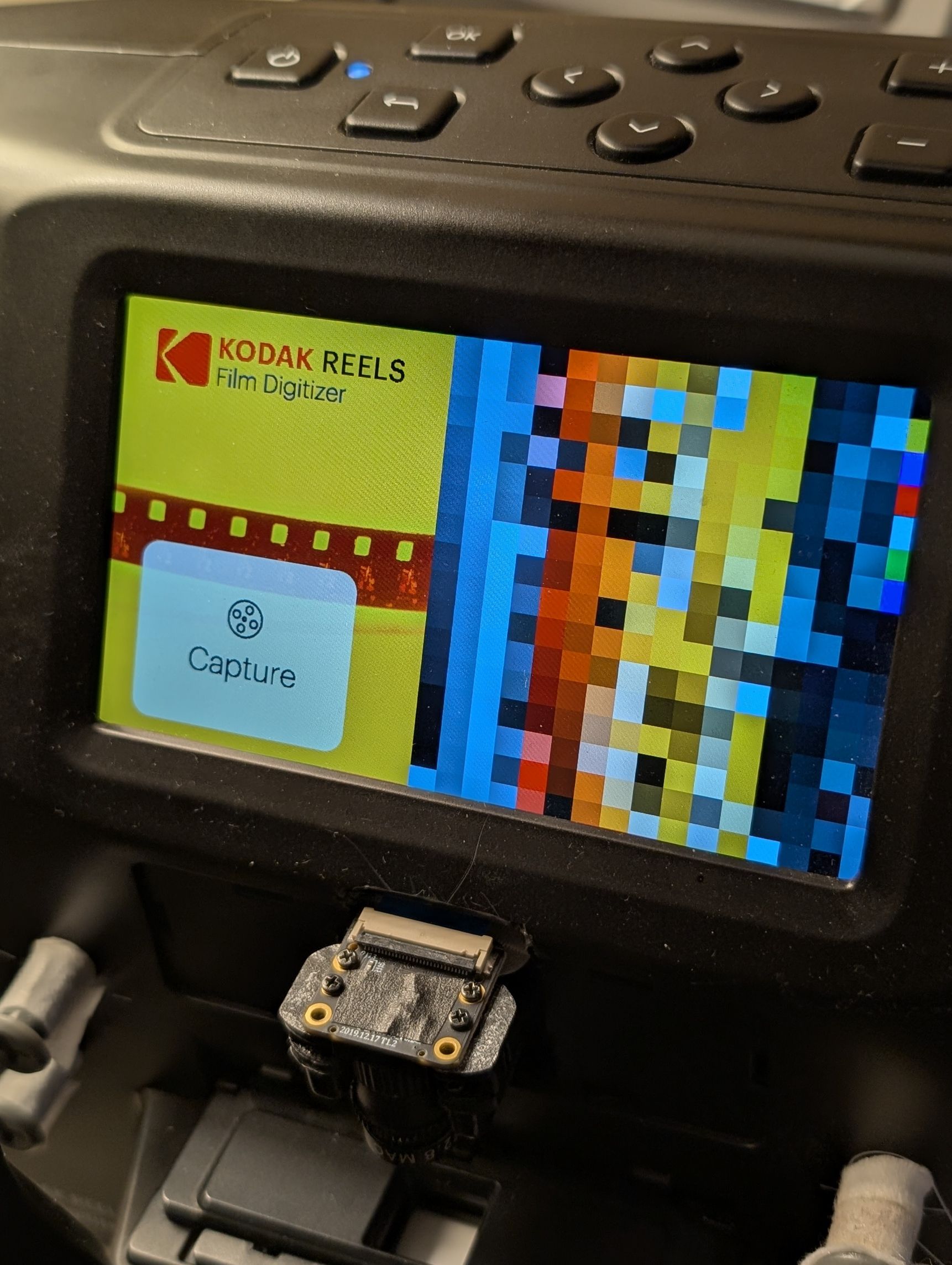

Hi, all—
Just picked up the Kodak REELS. I was able to digitize an old 8mm reel my daughter found at an estate sale—with the shipping firmware.
Trying to install various firmware versions I have found in this thread have failed to work on my device. I also am unable to find a default firmware that will restore the device. Any ideas?
FWIW, S/N: H2825148BK00161
It was not recognized by the lookup tool so suggested version B.
A and C give me a messed up display when the machine powers up to the Home Screen.
B looks good (the Home Screen), but the buttons do not function.
Thanks!

Do the buttons work with type A or C? If this is a new configuration, it would nice to see what it shares with other configurations.

Thanks for uploading the European firmware, but it did not work. The screen was rotated 180 degrees and the colors clearly wrong (as though inverted or just the RGB values shifted or such). The buttons did not work either.
From my experiments with the various A, B, and C versions yesterday, the buttons did not work for any of them. I tried the arrow buttons to see if I could navigate off of the "Capture" button (nope)— I tried the "OK" button to see if it would take me to the next screen (nope).
Maybe Steve has a newer version like mine.
(My S/N: H2825148BK00161)

Based on the posts on this forum, and those that shared serial numbers, it seems there is a fourth hardware configuration and therefore a Type D firmware needed. We have seen two units on this forum with H2825xx serials, that will not support button presses after update, but the LCD driver suggests it is very close to type B. Anyone else with H2825 serials please do not install, but do post here so we can work out how to extract your original firmware before it is erased with any firmware update.
Based on these serials post to this forum and ranges extracted from Mac84 javascript code:
A2021148BKxxxxx A
J2021148BKxxxxx A
M2021148BKxxxxx A
P2021148BKxxxxx A
A2022148BKxxxxx A
M2023148BKxxxxx B
A2724148BKxxxxx B
E3124148BKxxxxx B
H2324148BKxxxxx C
K3124148BKxxxxx C
C1725148BKxxxxx C
D2825148BKxxxxx Unsure (@Xanadude hasn't confirmed)
H2825148BKxxxxx D (Do not install, yet)

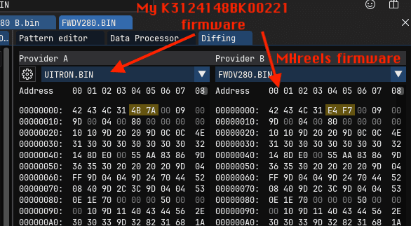

I just opened my K3124148BK00221 unit and dumped the firmware. It seems to be nearly identical (except for a minor change) as @MHreels posted (SN: H2324148BK...). The only difference is on the very first address line.
I think mine maybe a revision C then?

@Mac84 Yep, that is a type C.

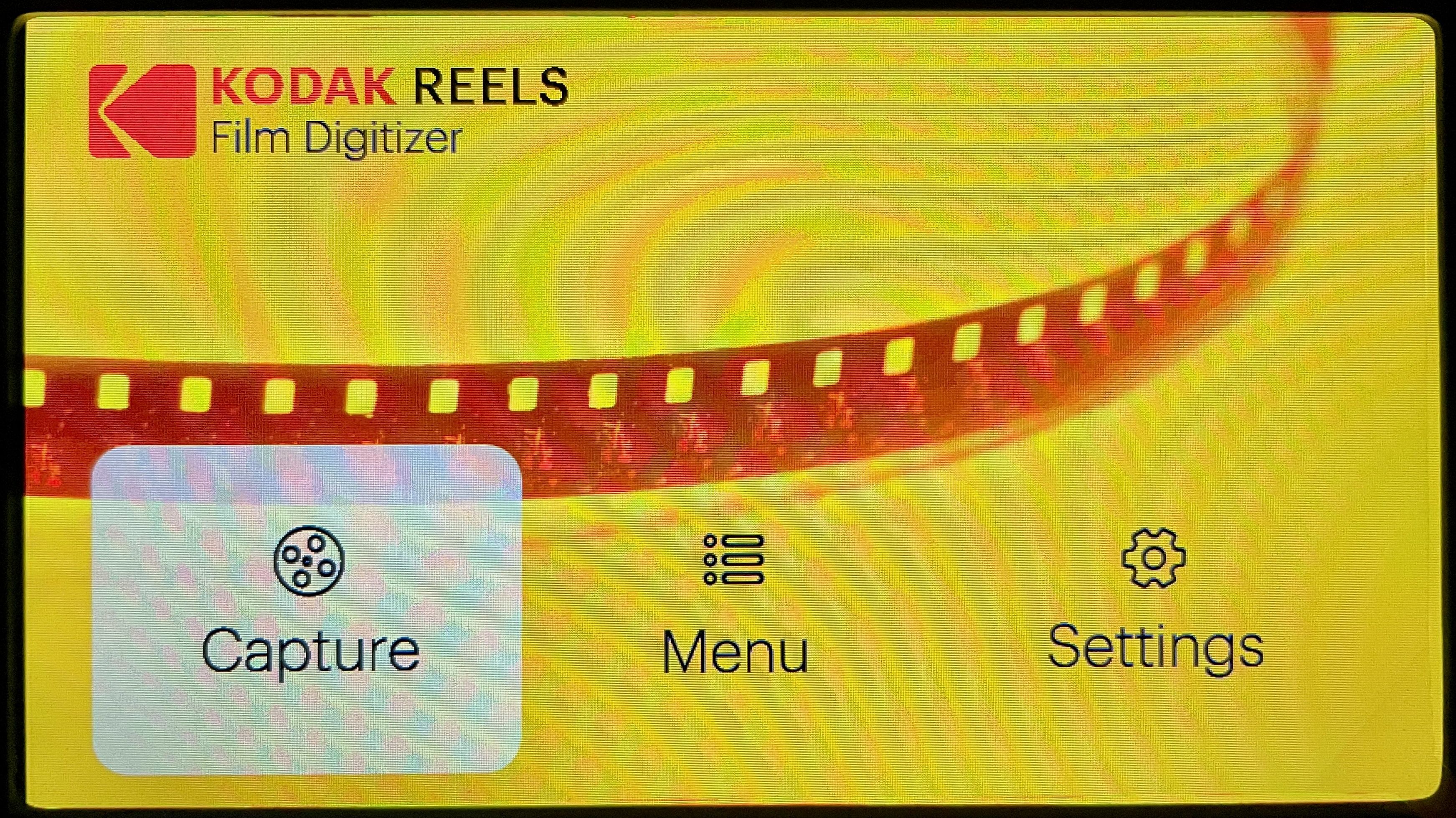

JKCalhoun
Dec 25, 2025
Thanks. It occurred to me that I could return the unit to Amazon where I bought it and exchange it for another unit—and not molest that one. It seems like a rotten thing to do though…
I tested your "D" test version and did not see a "color palette test". In fact it booted to a normal looking Home Screen—non-functional buttons.
Is there a way to enable the color palette test? Or ought it have kicked off itself?
Attached is the (brief) info screen before the Home Screen and the final Home Screen (buttons do not work):
This suggests the unit is crashing, it is not the buttons aren't working. Return it. The manufacture can easily refurb the units, and would have this issue if A) they didn't do a sloppy design, and B) they would provide users installable firmware.
