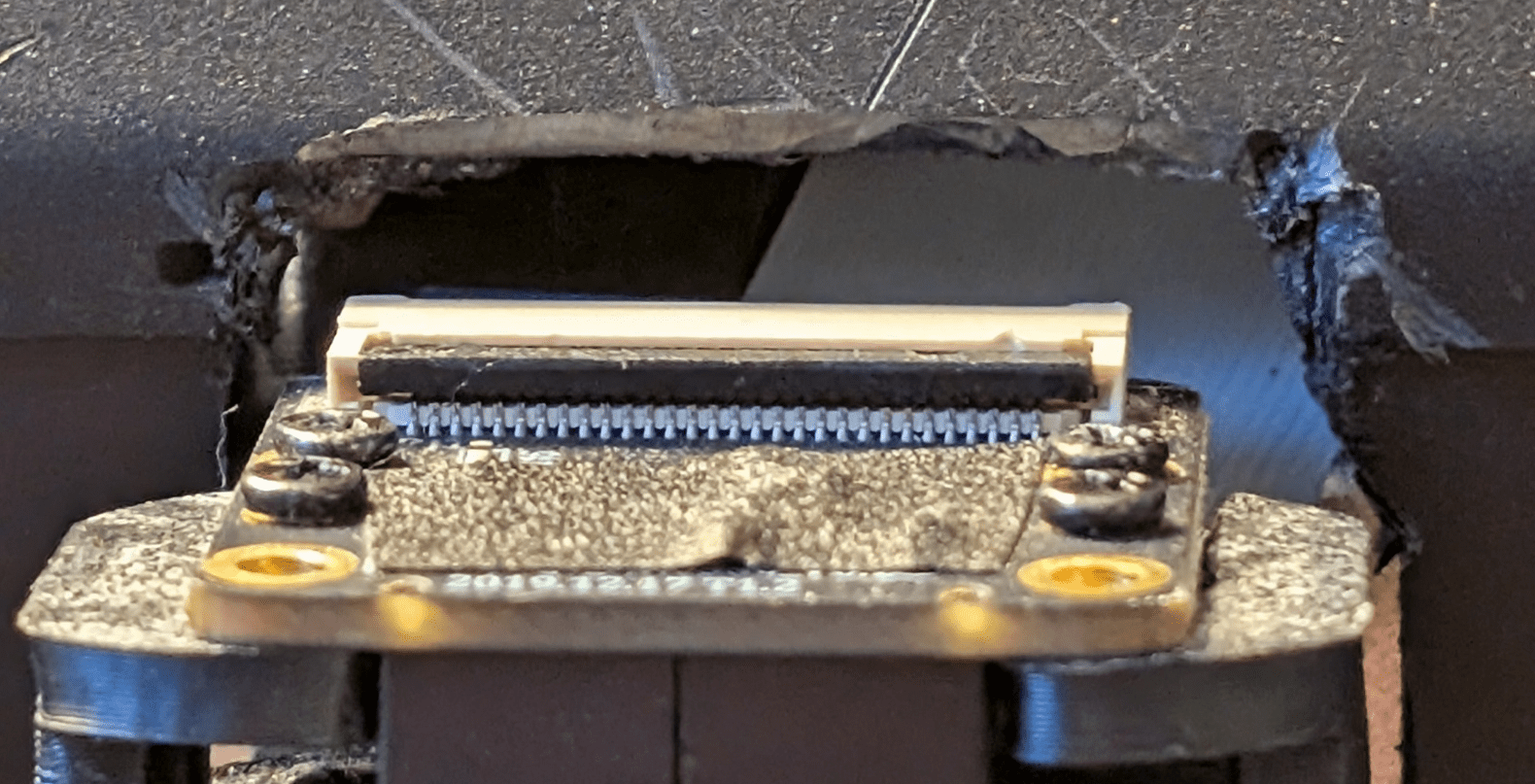

No guide for the case mod, but I've done four now. However, you should begin the hardware modification until the new firmware is available for Type D units.
1) Remove the camera cover, there are two clip on top and two on bottom, it will just pop off with a little work.
2) Unscrew the four screws from camera module from the mount. Save those screws.
3) pull gently on the ribbon cable to have some room to move the camera out of the way.
4) The hard part, cut the plastic above ~5mm by ~25mm, above the camera mount (without hurting the ribbon cable.) I have use the tip of soldering iron to do most of the cutting.
5) then add the 3D print parts (two screws for each layer)
Use https://printathing.com/order/ to order the parts.

Thanks again, @0dan0 , for posting details. I think I might try my Dremel with a 426 wheel to make the cuts--very carefully! I've used this before. I'd like to see if a better plastic cover could be made to accommodate this new height so that the parts aren't left exposed so easily.
Jan 13, 2025
442
623
I have used a dremel too, it will work. 3D printing a new camera housing is something I started to design, never got far on that.

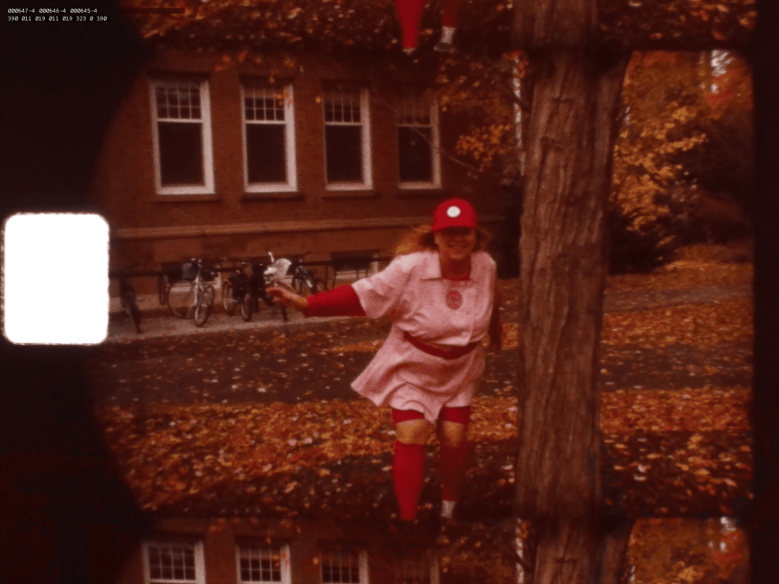

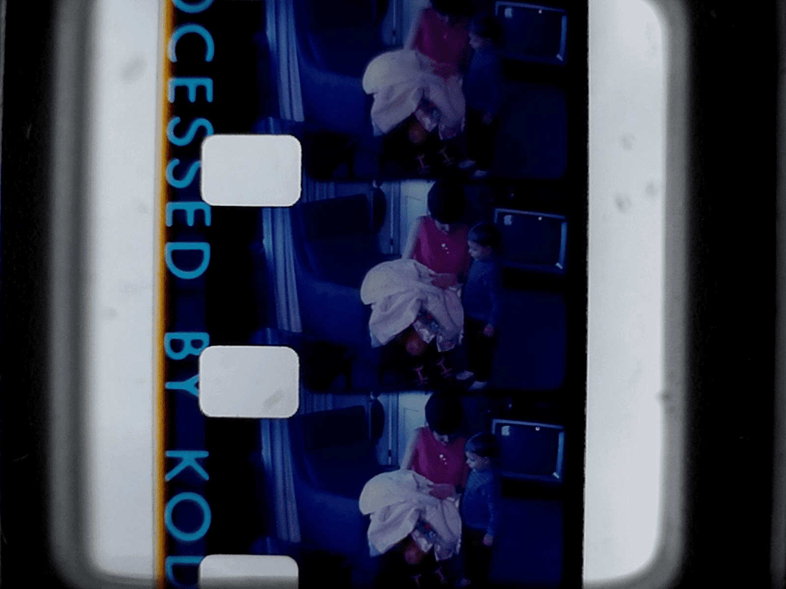

Yes, this has all been explained in detail in the original thread (hours for reading for you.)
This image is from Feb 2025 (https://tinkerdifferent.com/threads...-film-digitizer-firmware-hack.2897/post-35256)
This is what the stock lens sees when using the whole sensor (as much I could get to work.) The lens is crazy wide for an 8mm subject.
I should be now clear that the original lens was not designed to scan 8mm film, although it would be pretty good for 16mm (I completely different hack idea to make this a 16mm scanner.)
This example is with the 12mm lens, using the same sensor readout window (as above):
12mm is pretty ideal, scan around a non-upscaled 1080p for the active picture.
