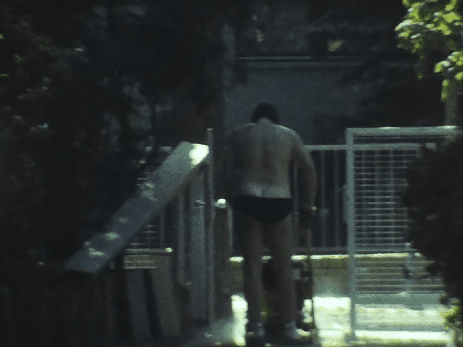

so I got everything set up and did my first capture which went well, it was only a minute long. However my second capture also went dark after about the 1:50 mark. I'm running v 6.6 on model C.
I tried to stop and start the capture but within 5 frames or so it would transition back to dark. Also is the color super washed out? This is my first time dealing with film so i don't know what to expect.
jackmonte1987
Oct 7, 2025
30
Here is a short video where you can quickly see the transition. I power cycled the unit and retried the scan, and it did the same around the 1:50 mark
It happens in the first second, may need to slow playback to see

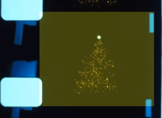

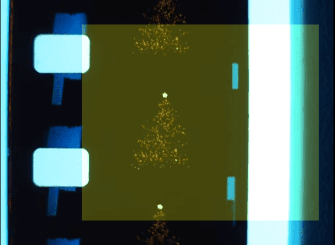

It is the film not, the scanner or firmware, that is getting dark, as the scanner exposure is not changing. The exposure is not changing as the weights are sampled from these pixels in yellow:
So it is sampling pixel to the right of the film, preventing a change the re-expose. This far out view, is intended out for the replacement lens, and should not be used for the stock lens.
If you frame it like so, the image is mostly sampled, improving your exposure.
I do need to move the sampling window further to the right to avoid the large 8mm sprockets.
Thanks so much for the reply @0dan0 and I think you're right. My first capture i ran cropped in quite a way, and that film did not go dark. I ran the second reel zoomed out because thats what I was seeing on this forum. My Mistake! The results look fantastic though, so thank you for all your hard work, my family will love seeing these. Do you have a venmo I can donate to?

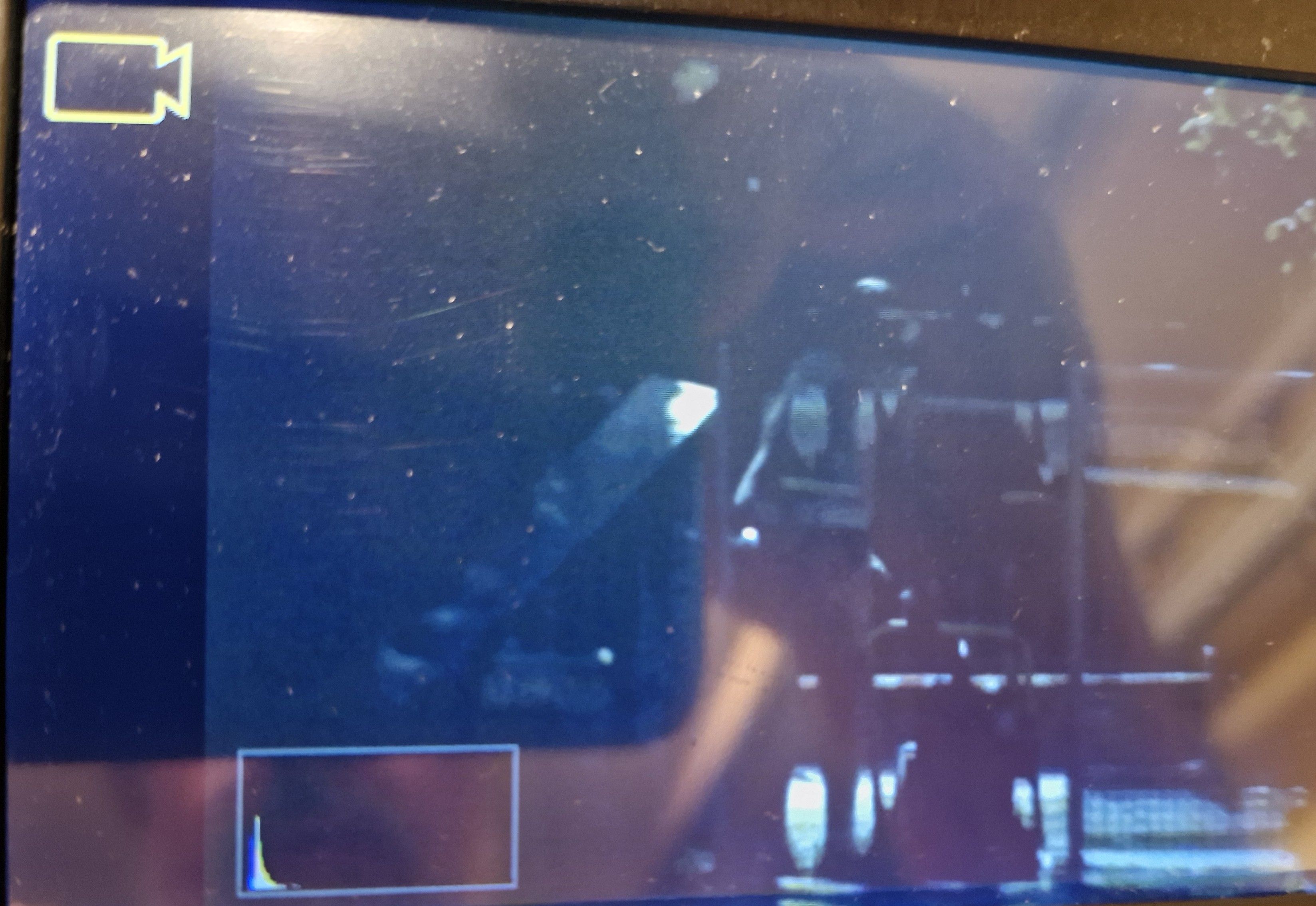

Here is an example of mine during capture. B model v6.8 with a 32GB card. It did the same with 4GB card (just trying anything at this point). I am still willing to hook up a serial reader if I knew what needed to be captured.
