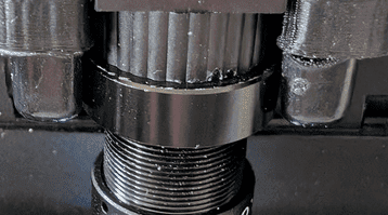

I went through a lot of lenses. It has to be a macro lens, and they are rare (or at least poorly described.) Also with any lens you will need a spacer to move the lens further away from the sensor to focus. Optically a 12mm lens would be 12mm from the sensor to focus at infinity, here we need to be more than 12mm away (mine is ~20mm from the lens front) to focus ~28mm away. 7mm spacers are common-ish, but I found 5mm, which is what I needed.
All purchased from Scorpion Vision in the UK. Shipping is not cheap. The lens I used is the SVL-1228MAC
Lens: https://shop.scorpion.vision/products/m12-lens-12mm-f2-10
Spacer: https://shop.scorpion.vision/collections/optical-accessories/products/m12-extension-ring-5mm
I'm wishing I purchased this several months ago before all the extra taxes hit with more to come. Does this lens have an IR filter on it do you know?
See post #748 above for a US seller of that 12mm macro lens. Regarding your IR filter question, the spec sheet says "Design Wavelength: 400-950nm"... No mention of any filters.
