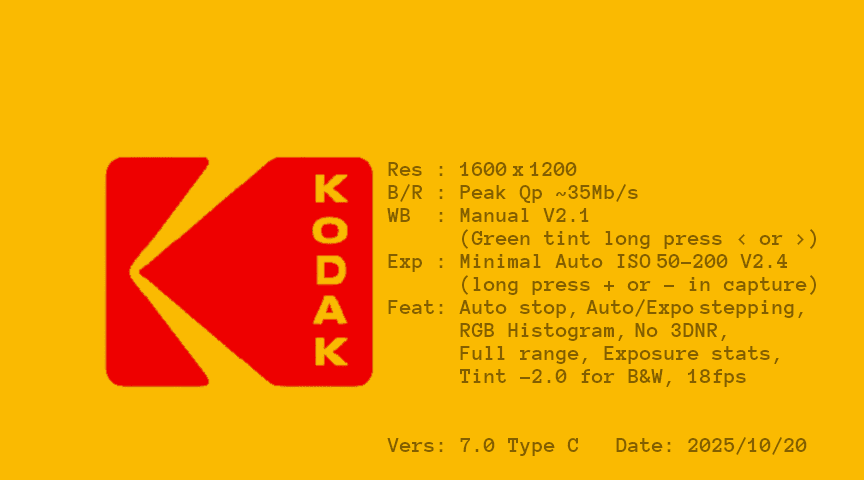

Enough enhancement already to release 7.0.
- Added auto exposure back into preview
- Added ISO 50 back to the exposure range
- Added Tint -2.0 is now true B&W
Let me know if you seeing much jitter in 7.0, as the preview auto exposure was originally disabled to reduce jitter. Now the preview auto exposure biases to a short shutter, hopefully to achieve the same jitter reduction. I'm not seeing any jitter my brief testing.

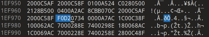

Bummer! I still like the hack idea you proposed way back in February in post #317 of "frame control for 18 or 24, would be nice (20 is weird)". I agree that 20 is weird. Actually, I would prefer 16 fps for my regular 8mm film, to match the original filming speed. However, I can certainly deal with a hardcoded value of 18 (using ffmpeg after encoding to manually convert from 18 fps to 16) if you are unable to add frame control to the UI without access to the fw source code.

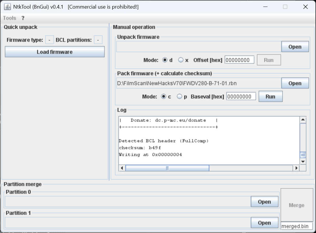

Setting 16fps in your own firmware is straightforward.
Type A/B - offset 0x1fe974
Type C - offset 0x1fe984
0xD2F0 is 54000. 54000 / 3000 = 18fps
For 16fps, 16 * 3000 = 48000 in hex 0xBB80
So change the four characters with the .rbn file to 80 BB (little endian), run the NtkTool Pack Firmware option, and the firmware will now encode 16fps files.

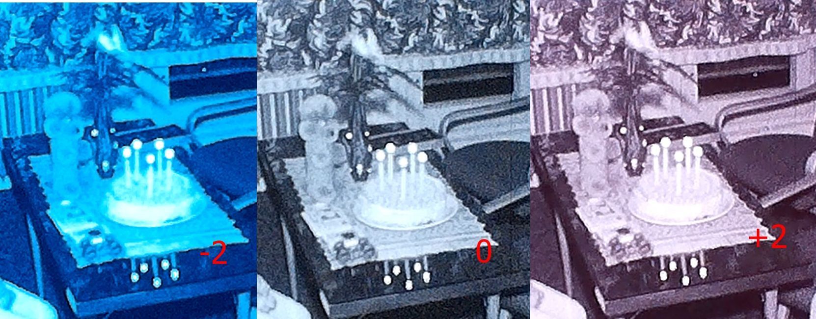

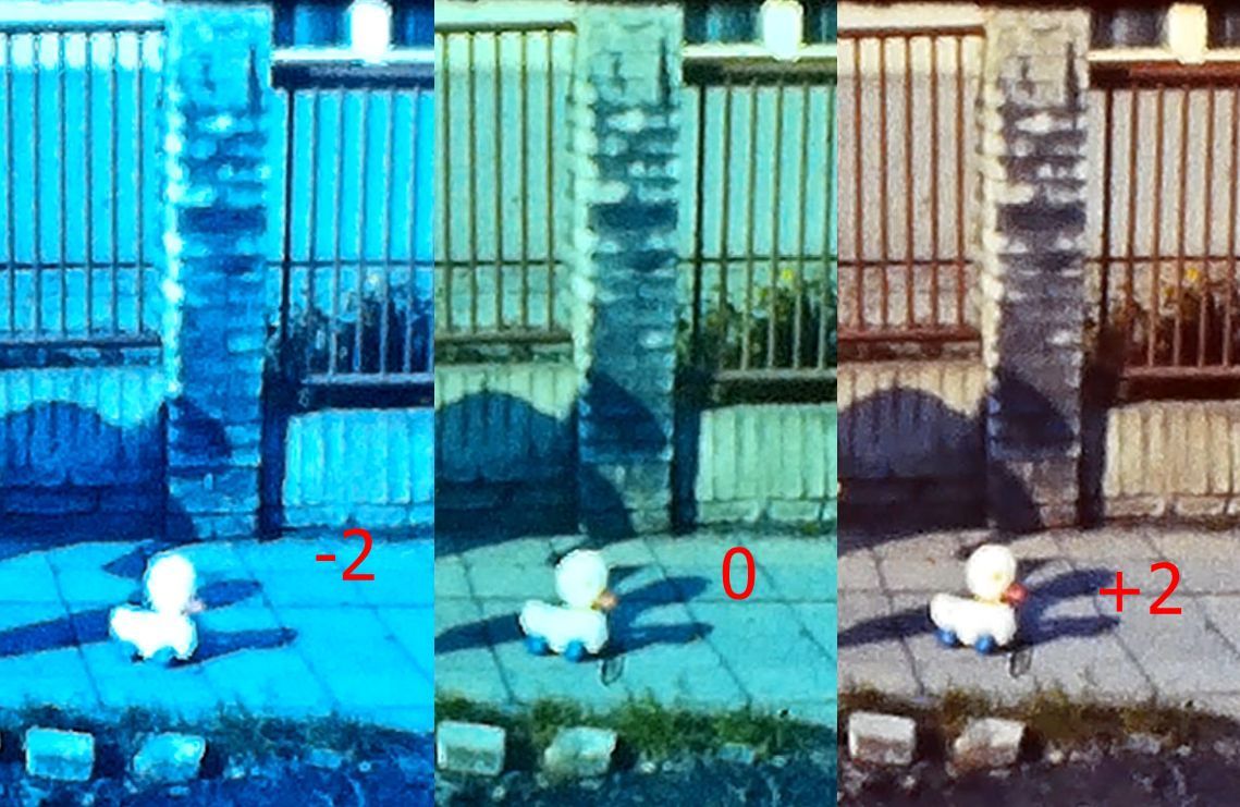

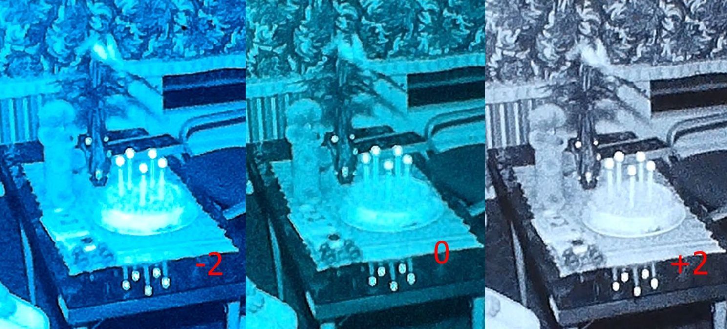

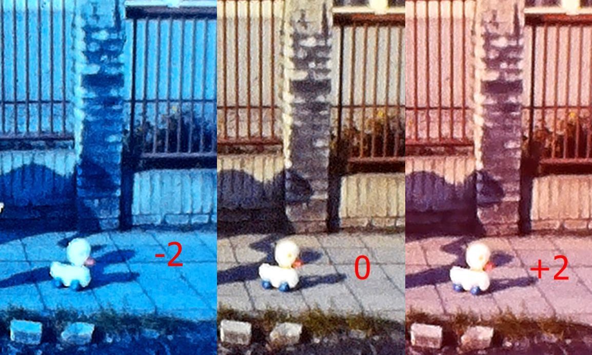

I'm trying out a new version of #7. The first set is from a black and white film, where everything is at 0 and only the white balance changes.
The second set is a color film and like the first set, everything is at 0 and only the white balance changes.
It is firmware version "C".
Reactions: Umba67 and eyeidea

I could bias the the white balance, so 0 is closer to normal. T
// Plus +2.0 to -2.0
if(*whitebal == LVL_P20) { r = 0x1C0; g = 0x100; b = 0x100; } //1.75,1,1
if(*whitebal == LVL_P15) { r = 0x180; g = 0x100; b = 0x100; }
if(*whitebal == LVL_P10) { r = 0x140; g = 0x100; b = 0x100; }
if(*whitebal == LVL_P05) { r = 0x120; g = 0x100; b = 0x100; }
if(*whitebal == LVL_000) { r = 0x100; g = 0x100; b = 0x100; } //1,1,1
if(*whitebal == LVL_N05) { r = 0x100; g = 0x100; b = 0x120; }
if(*whitebal == LVL_N10) { r = 0x100; g = 0x100; b = 0x140; }
if(*whitebal == LVL_N15) { r = 0x100; g = 0x100; b = 0x180; }
if(*whitebal == LVL_N20) { r = 0x100; g = 0x100; b = 0x1c0; } //1,1,1.75
So currently WB of 0 has unity RGB gains (the reason it is as it is.)
Reasons to add bias. The sensor doesn't seem to be very red sensitive, and the back light is very blue. Will address in the next release

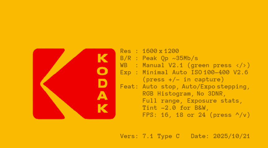

Beta v7.1 for Type B. Please test if I broken anything.
Changes:
Exposure: Went back to ISO 100-400, as was seeing more exposure stepping with ISO 50.
White balance: 0 is now normalized to color of the backlight.
FPS: is now selectable between 16, 18 and 24fps. Long hold on up or down, arrows to increase or decrease the frame rate. You will be remembered, and can be changed during capture, as the value is only unused as the capture is stopped.
I will do Type A & C soon after positive feedback on the Type B build.

"Official" V7.1 for Types A,B & C
Please test if I've broken anything (more, other 64GB+ support and Playback).
Changes:
updated with v7.1.1 (fixing the fps issues)

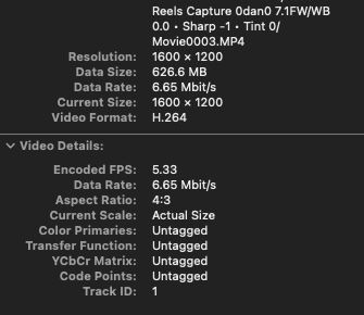

I did new tests and the color matches in my opinion. The speed is worse. With 16 set the real speed is 5.333. With 18 it is 6 and with 24 it is 8. It looks like you need to multiply by 3.
Hopefully this will help you. I really admire your knowledge and selfless help for those of us who can't do this. Many thanks.
