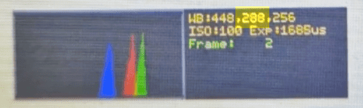

No, green tint for white balance is < and > buttons, EV (exposure bias) is new, and use + and - buttons, but only during capture. These are explained (so briefly) on the boot screen. There is no correct setting, just what looks good to you.
Is there anything I can do to reset the green tint value? It's stuck so far one way and will not move or adjust either way anymore.

623
Your example footage didn't look particular green to me. The green tint is the middle value.
256 is neutral. 114 minimum, 368 maximum.

Your example footage didn't look particular green to me. The green tint is the middle value. View attachment 23833
If you look at the attachment on post 704, that is what my footage currently looks like. When trying to adjust the left and right rockers, it no longer adjusts the green tint either way. It seems to be completely stuck where it is. I'm sorry for being ignorant,
edit: I have re-attached the file to this post. You can see it is heavily tinted green. Also if you go to the minute mark in this youtube video you can see the buttons have no effect anymore. I know i'm only hitting the right arrow, but the left arrow also no longer has an effect

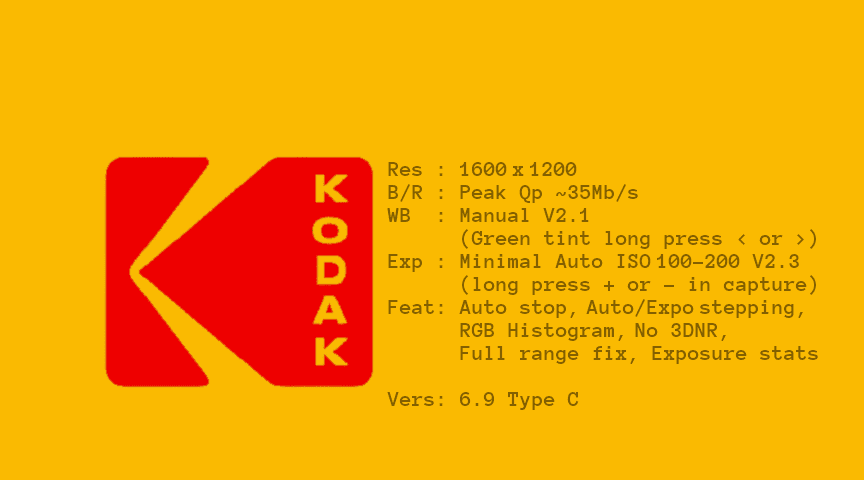

View attachment 23826View attachment 23827View attachment 23828
All updated to V6.9, types A, B and C.
I reduced the EV range to be more subtle, so larger values might be required. I was reacting to this comment "EV1 is a little to dark, ev 2 is too bright". EV +2 now more is like the last EV +1. This does not make the scan brighter or darker directly, instead it biases the input to the auto exposure. As the exposure logic tries to limit unnecessary brightness changes, it is more intended for a scene change, some EV values may no appear to change the brightness, this is normal. You can trick the unit into thinking there is a scene change by temporarily placing your finger between the camera and film.

The changes are documented in the boot screen messaging.
V6.9 adds: Exposure stats (to the LCD), Green Tint < or > (buttons) and EV bias + or - buttons in capture.

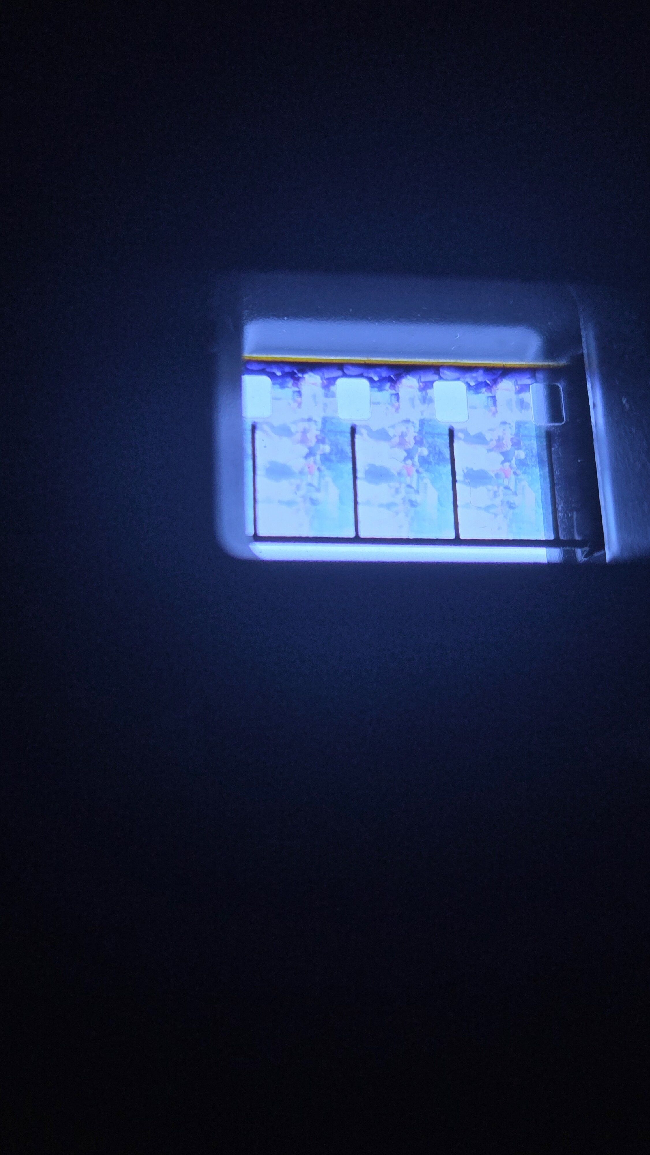

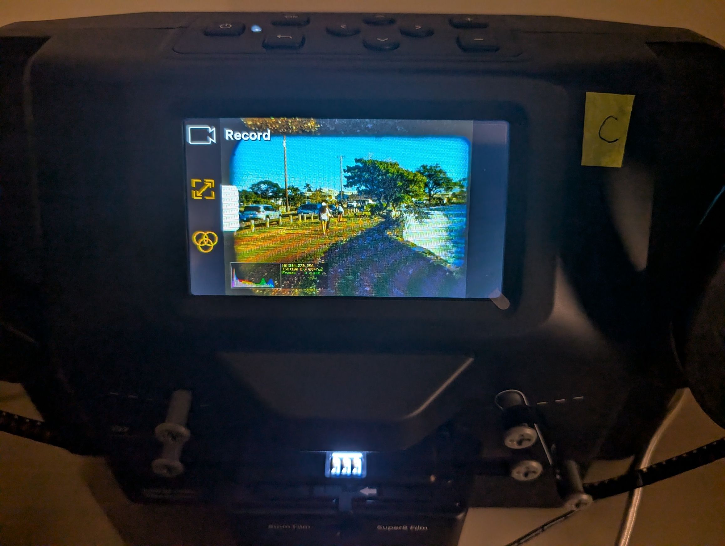

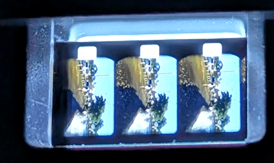

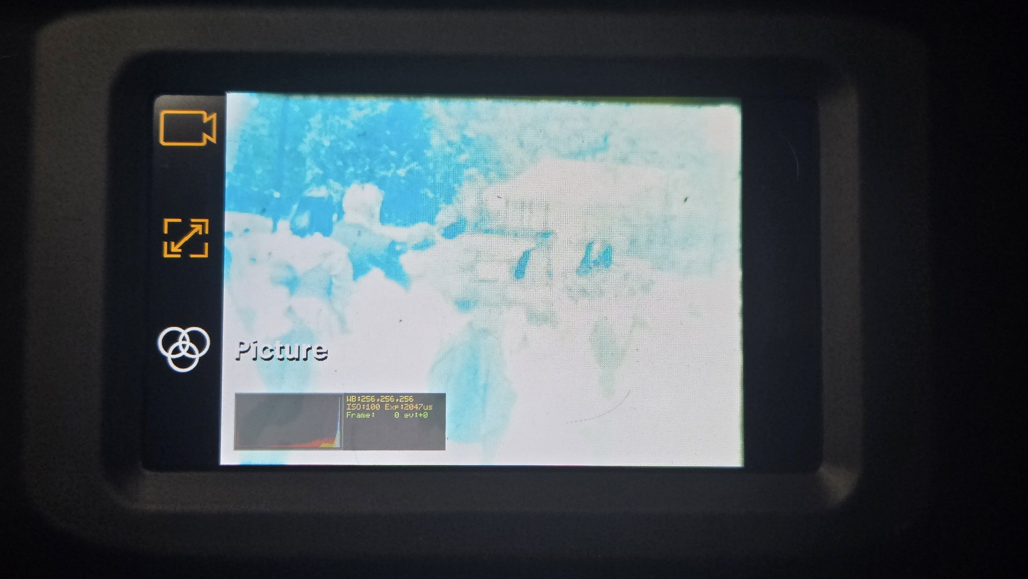

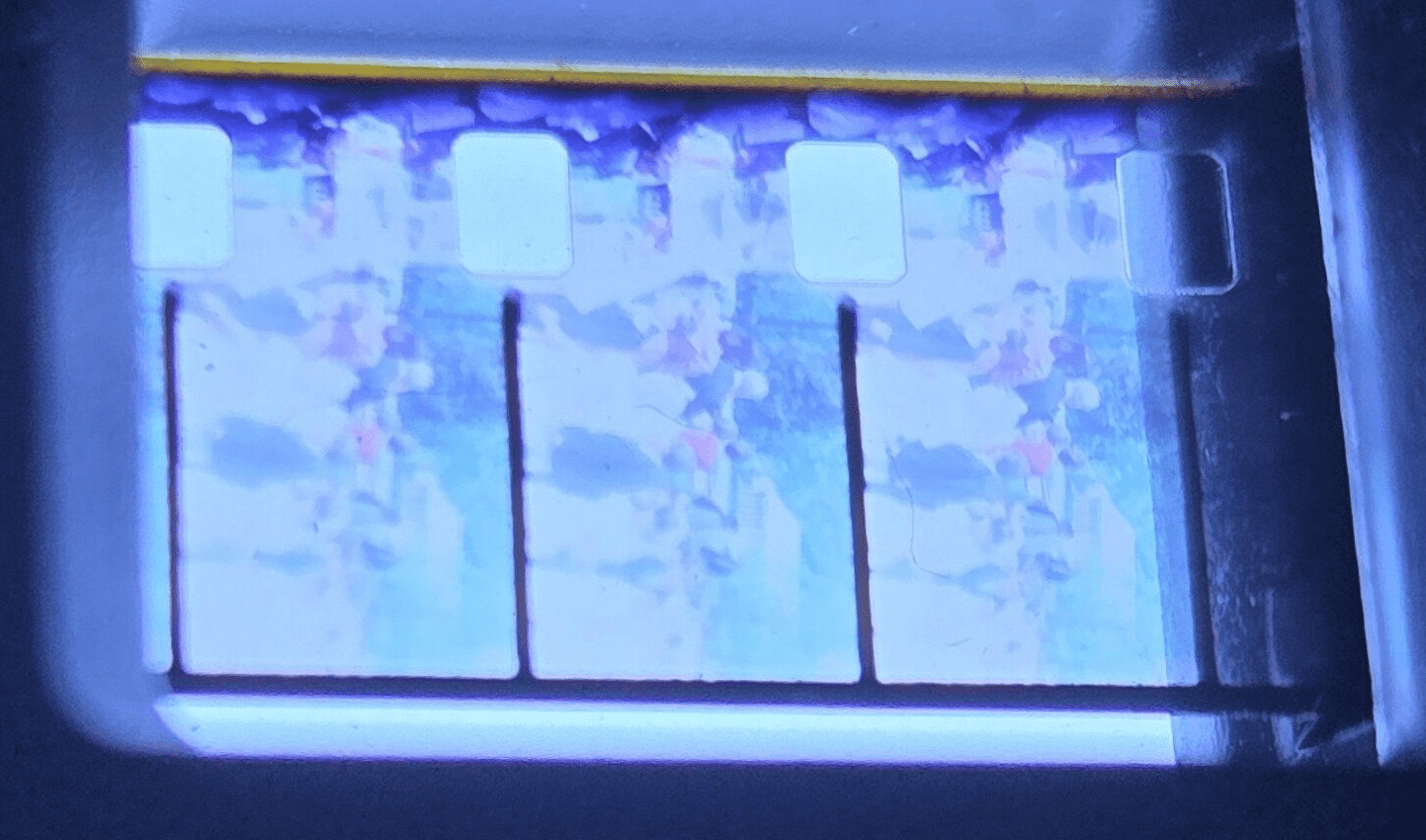

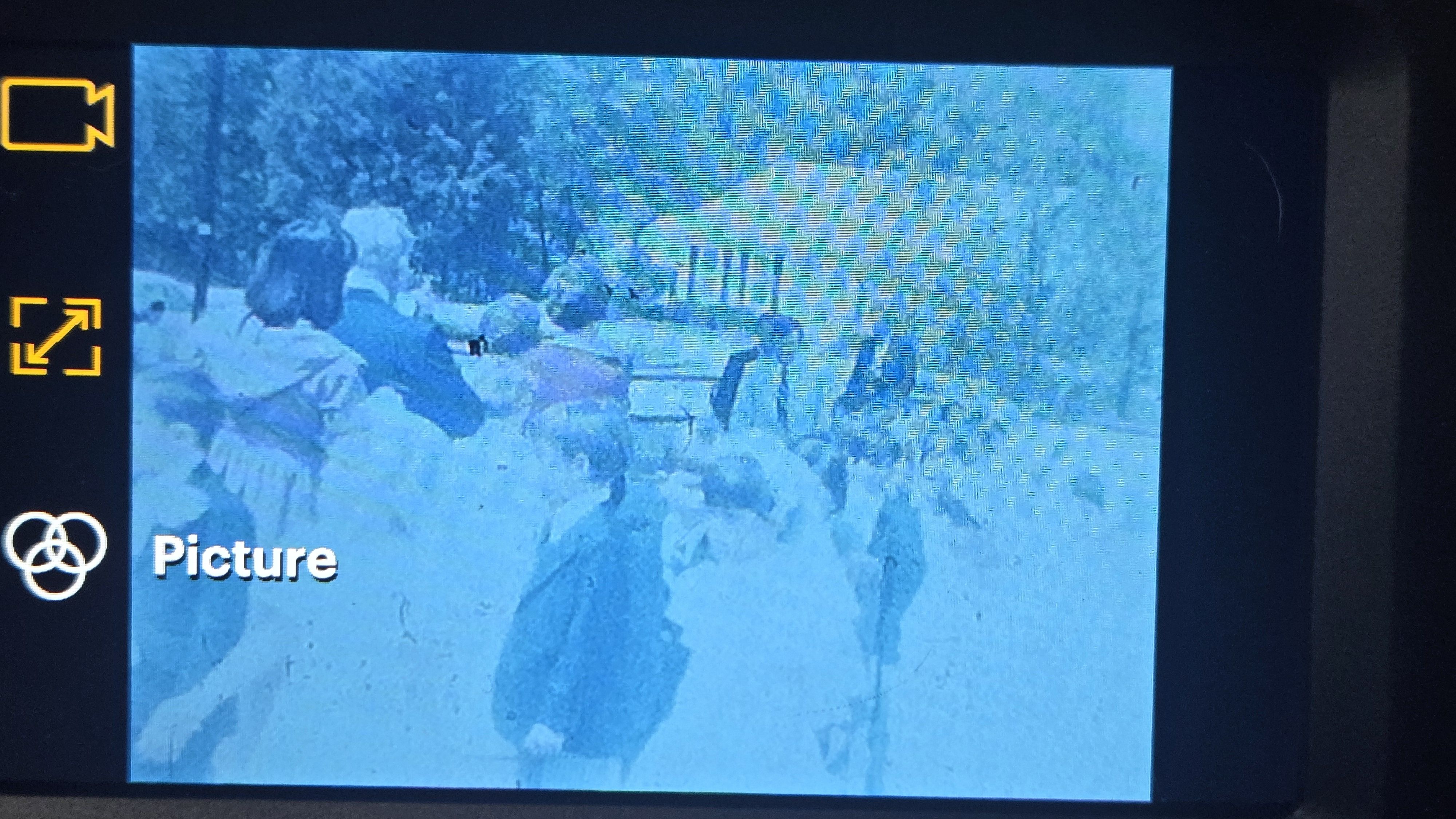

I have an update. I was scanning a reel with 6.9c firmware and I could not get any color into the image. When I looked down at the film with the light behind it I could clearly see color, I decided to go back to stock fw 2.0 to see if I could see a difference and I could! There was actually color In the image. I made sure I had everything set at default in 6.9c. sorry for the paragraph I'm on mobile. I've attached photos.
EDIT: I ran some additional tests, and confirmed that the issue is apparent in the type c model firmwares (at least on my unit) I have tested version 6.3, 6.6 and 6.9. When I flash back to the MAC84 2.0 FW i get accurate color to the frame showing in the viewfinder.
What do the scans look like, overexposed?
Those images look very overexposed at the source, in the film tray and on the LCD. Histogram shows the overexposure. Try a different section as Type C firmware is working fine.
Here is mine Type C with the same ISO 100, 2047us exposure.
I can see it is blow out, as you shows the image is a bright as the sprocket holes
This is more what the film should look like:
I do agree that the scene is overexposed which is causing for a somewhat blown out image. However, I am leaving the film in the tray untouched and I can switch back and forth between the firmwares without touching any settings and the difference in color that is available between the stock and 6.9 is pretty evident.
