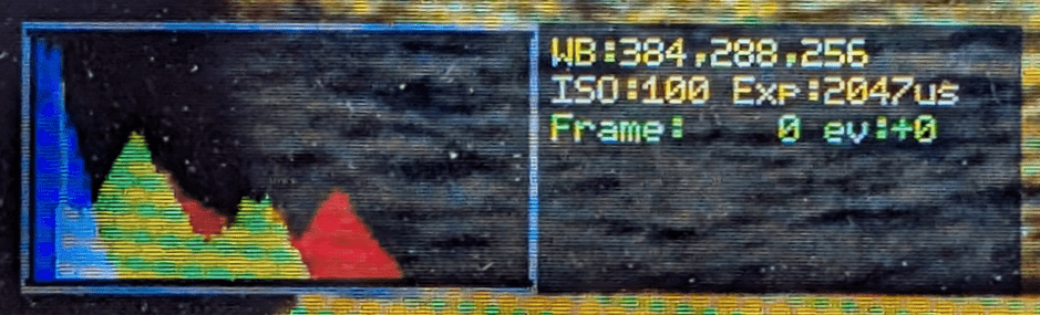

@0dan0 I was able to get the capture to work without the darkening that I experienced in the last version. I was able to adjust white balance to get peaks to line up, and then while capturing, adjusted the EV up to 0 as the default was at -7. It brightened it up! While I am no color expert, I feel like the capture looks flat. Can you tell me what you see in these two test clips? You should be able to download them.

The default of -7 explains why some units went dark. Now that we can see the EV level it is easier to fix. I will find a way to reset any out of range value in the next build.
Those two clips look great, and well exposed. There is not flat or log curves in the Reels scanner, this is likely a standard 2.2 gamma curve. I have yet to find any way to modify the curves. The clips look a tad desaturated, I'm not sure if that is the film stock/age, or you have a negative tint setting.

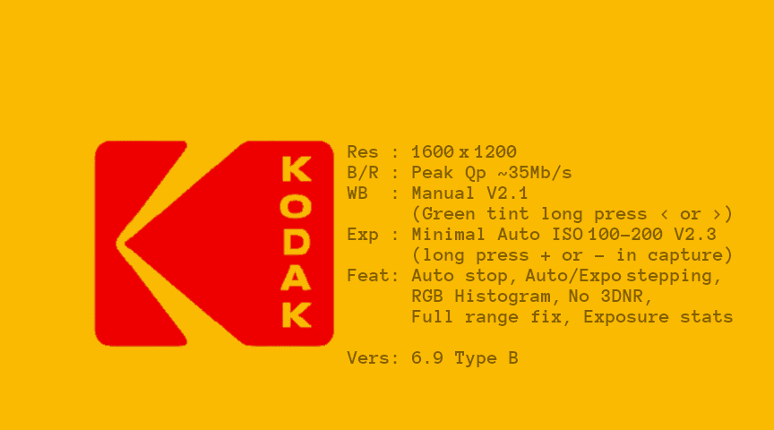

Thank you so much @0dan0 , Now I get back to scanning. I just want to clarify, when you say EV you are talking about the green tint using the left and right arrows correct? Would 0 be considered default or "untouched". Also will this fw update fix my stuck setting? I know you had said that the settings will remain even despite a fw change.
Jan 13, 2025
426
571
No, green tint for white balance is < and > buttons, EV (exposure bias) is new, and use + and - buttons, but only during capture. These are explained (so briefly) on the boot screen. There is no correct setting, just what looks good to you.
