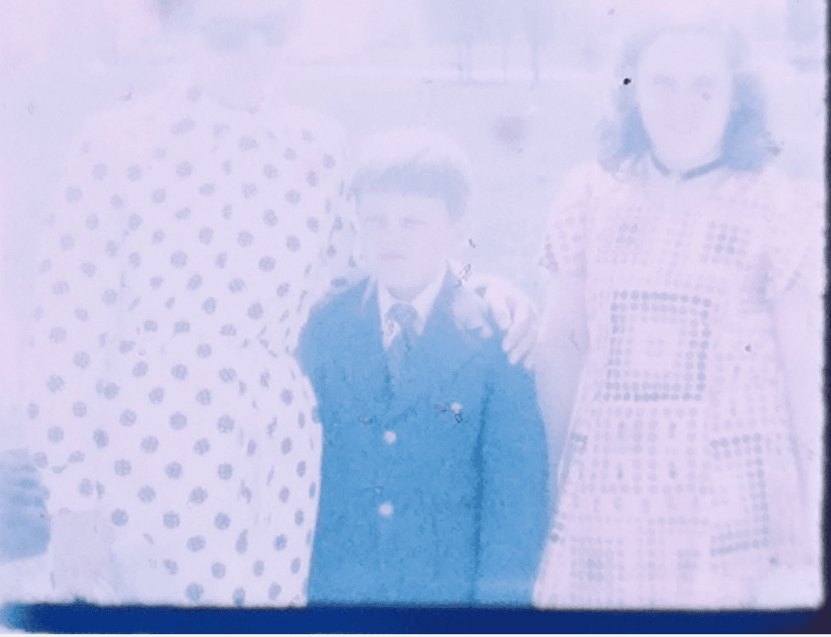

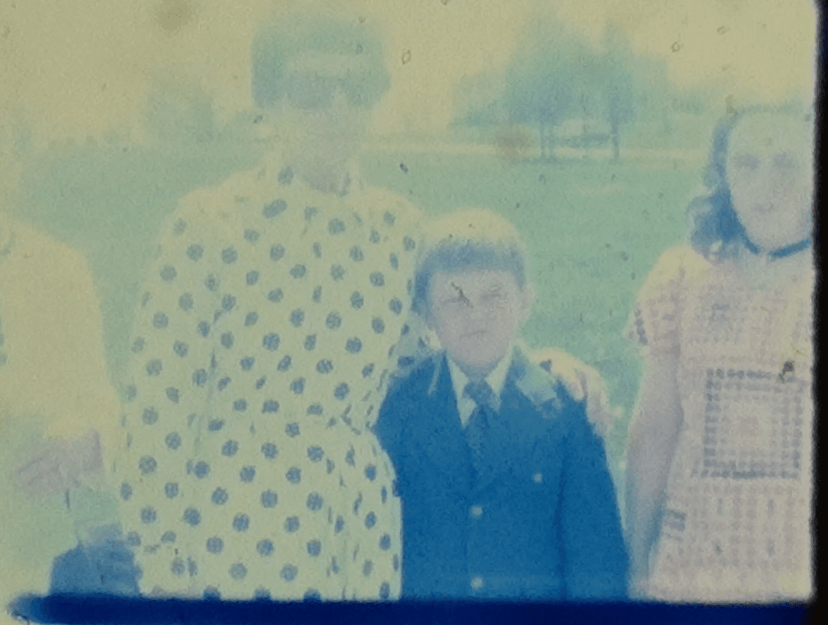

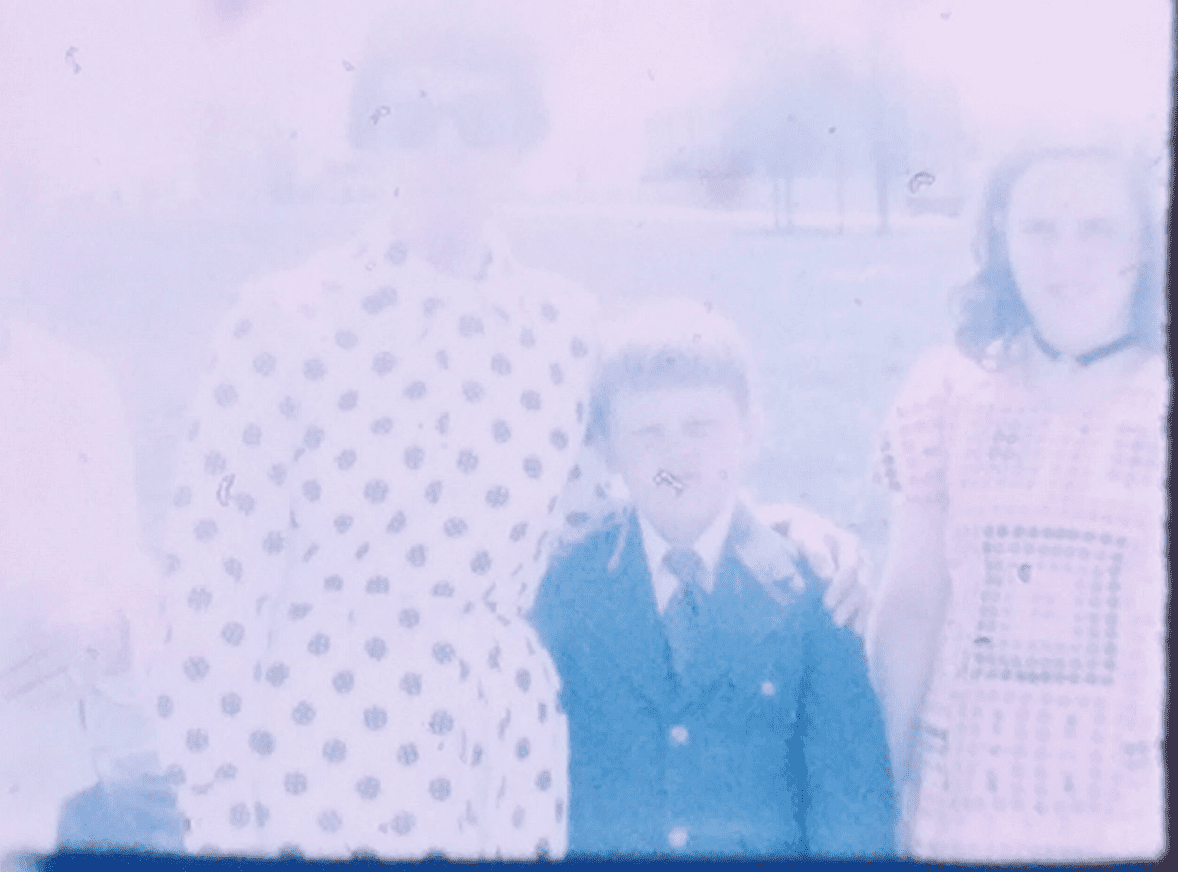

I will say it's mostly on a scene change or outdoor scenes in general. I've had multiple scenes that I had to explicitly scan with the Mac FW because all the brightness just turned blue. I have had some good results in outdoor scenes at dusk and indoor scenes. But as you can see from my screenshots even the indoor scenes sometimes have a blown out look to them. It seems no matter how I mess with the settings there is a "glow" to the bright spots in scenes.

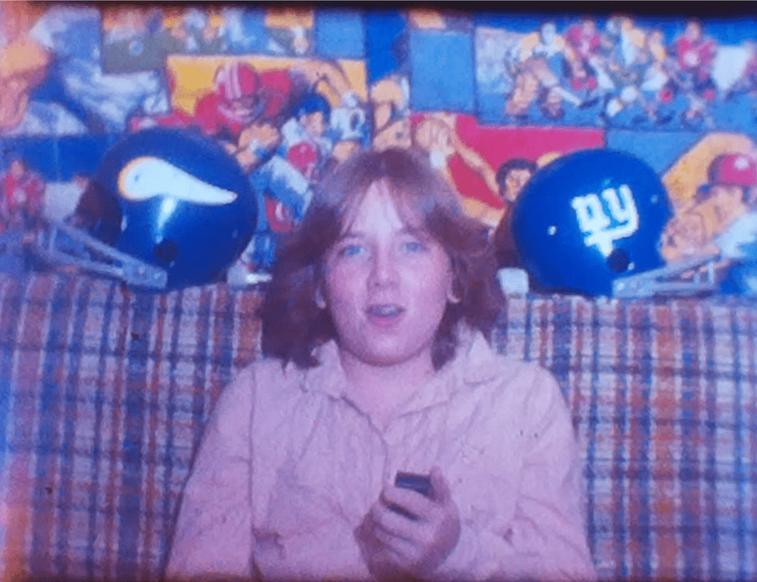

Here is a frame I took from the 6.8FW and this reel turned our great, filmed inside and had consistent color. Did not need to re-record this one
Mac84 FW
0dan0 fw 7.1
If you'd like, you can send me a message and we can do a video chat later on and I will demo my unit for you.
Before the above screenshots, there was about 20 frames of emptiness, meaning fully clear on the film. when it came back with color this is how it looked on both FW's. This section of the film is degraded as you can't see much anymore, but i thought it highlighted the issue. I've messed with all the settings in the 0dan0 fw, and it's easy to say "just up the green!" but I did that and it doesn't have the desired effect

The blueness here doesn't seem to be a white balance issue, as the bright elements are correct. This is more the film response is non-linear. White balance is a linear RGB gain, this could be the nature of this film stock.
Reactions: sheider
I may just be stuck with Mac FW then :(

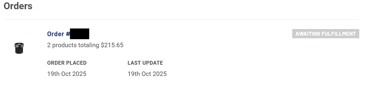

I don't believe that my blueness issue is related to the firmware. Instead, my issue appears to be solely with the hardware. The light source has not been illuminating fully. Yesterday its illumination decreased by ~75% in the middle of a scan, and moments later it went completely dark! I was able to restore ~75% of the illumination by slapping the front of the case. Unfortunately, scans are still underexposed even when the v7.1.1 fw pegs the exposure at ISO 200 and ~6 ms shutter speed. So, I have initiated a warranty claim.
While I wait for a replacement unit to arrive, I hope that the great work here continues, both with the fw and the 16mm macro lens trial. I really want to replace the stock lens, but I also really don't want to void the warranty on these rather unreliable units by cutting into the case.
