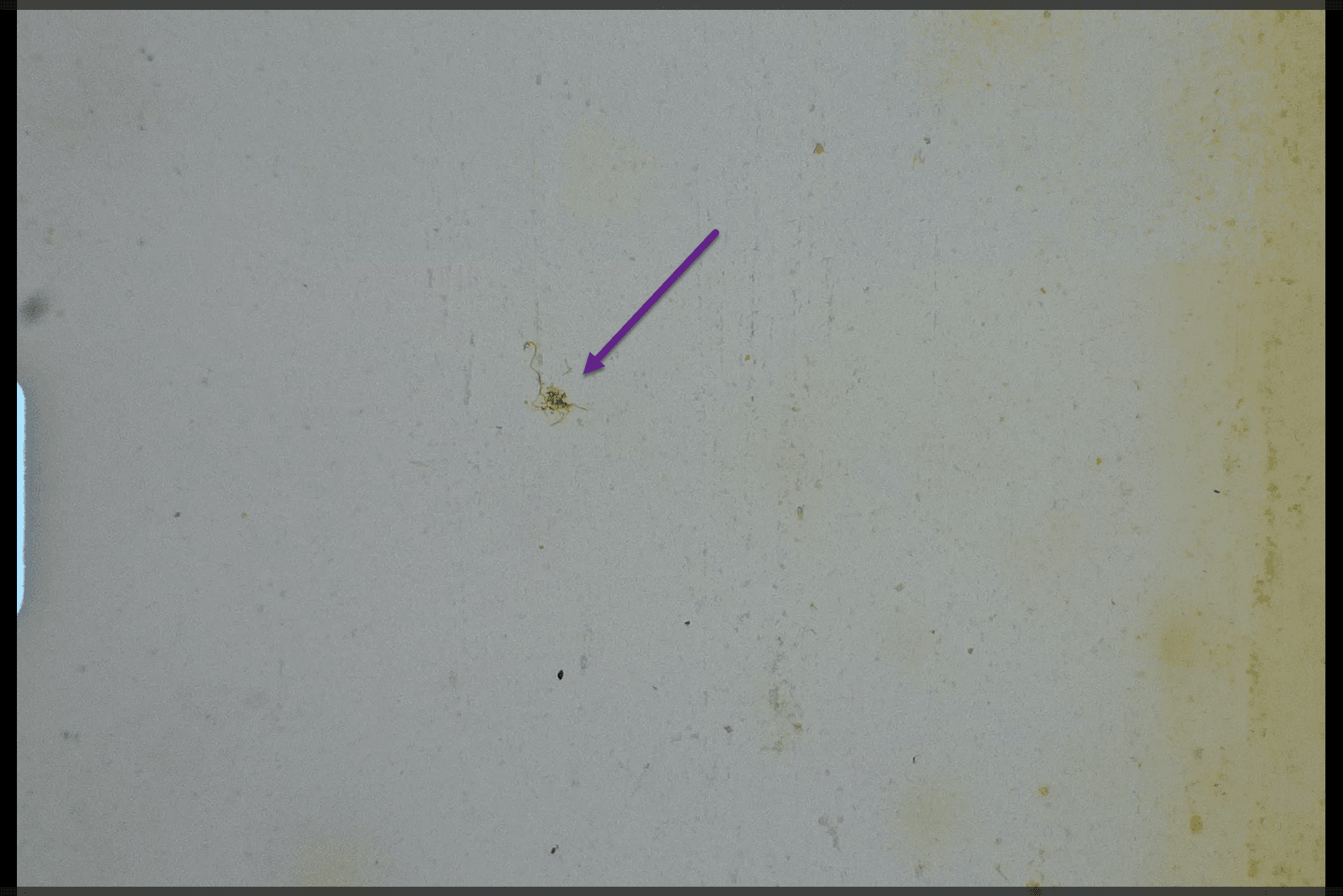

@ThePhage Sorry to hear about your issues scanning 7" reels. I only have 3" reels to scan, so I don't have any 4 GB file size concerns. However, I also had the device "freeze" during a 3" reel scan once... I can live with that, because it hasn't done it since. Regarding the random jitter issues, I can think of a few possible causes:
1. Dirt/gunk accumulating in the gate path during a long scan
2. Not using all of the "rollers" on the right side of the scanner bed
3. Film not under all 4 tabs in the scanner bed
4. Hardware glitch such as a motor hiccup
5. Perforation tear or bad splice on the film
6. Takeup (drive) reel hub not fully seated on the drive spoke
7. Friction: Film stuck together or rubbing against the sides of its reel

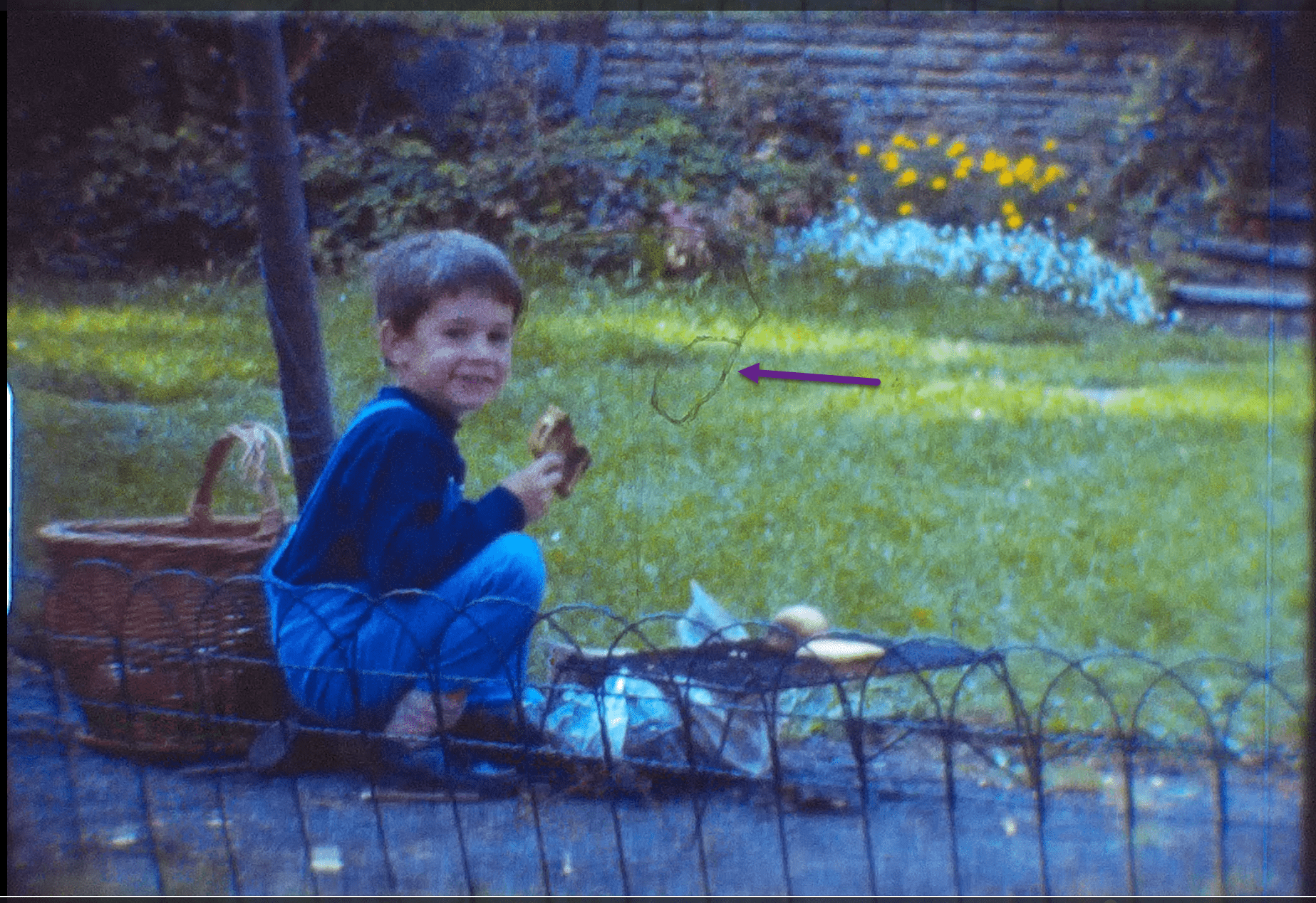

Now that the days are getting shorter (and the evenings longer), I'm finding time to read here again...
I've now converted my C-scanner to a Scorpio lens.
However, I'm still struggling with the quality of my images...
The preview on the scanner display shows sharp images (the preview is - well, not that big...) – but in the film produced, I think the resolution is much worse.
Firmware: odans0 7.1.1
My settings:
WB: -1
Sharpness: -0.5
Green: 304 (432, 304, 320)
ev: 0
FPS: 18
The scanner shows:
- ISO 100
- Exposure: 2891
Yes, I know about this “video compression” – but is it really that “bad”?
Does compression also depend on the image content?...
I think that the image quality is quite good in the white opening credits (deepl, are you sure about what you've translated... :) )...
But when the images start, it somehow becomes “mushy”.
Is that really “grain” – even where there's another bit of fluff – and it seems to me that it's not reproduced very sharply.
(Admittedly, the image may not be really sharply focused...)
I also took a series of shots with sharpness settings ranging from +2 to -2.
In my opinion, the videos with -1.5 or -2.0 look best. But I think Odan0 once said that with the 12 mm lens, a sharpness setting of -0.5 (or 0) would be okay...
Am I doing something wrong?

Compression is very much image dependent. Yes you typically resolve more details from the fluff and the scratches than the image itself from 8mm film. At at 35 mbs the quality for noisy source is good, not great. More of a factor is 8mm film itself is not high resolution. The main reason the stock lens is good enough for most users. However can be worth revisiting the information gained in a before and after comparison
(it has gotten better since v6.5 used to make this video.)
I use sharpen at -1.0 mostly with the new lens.

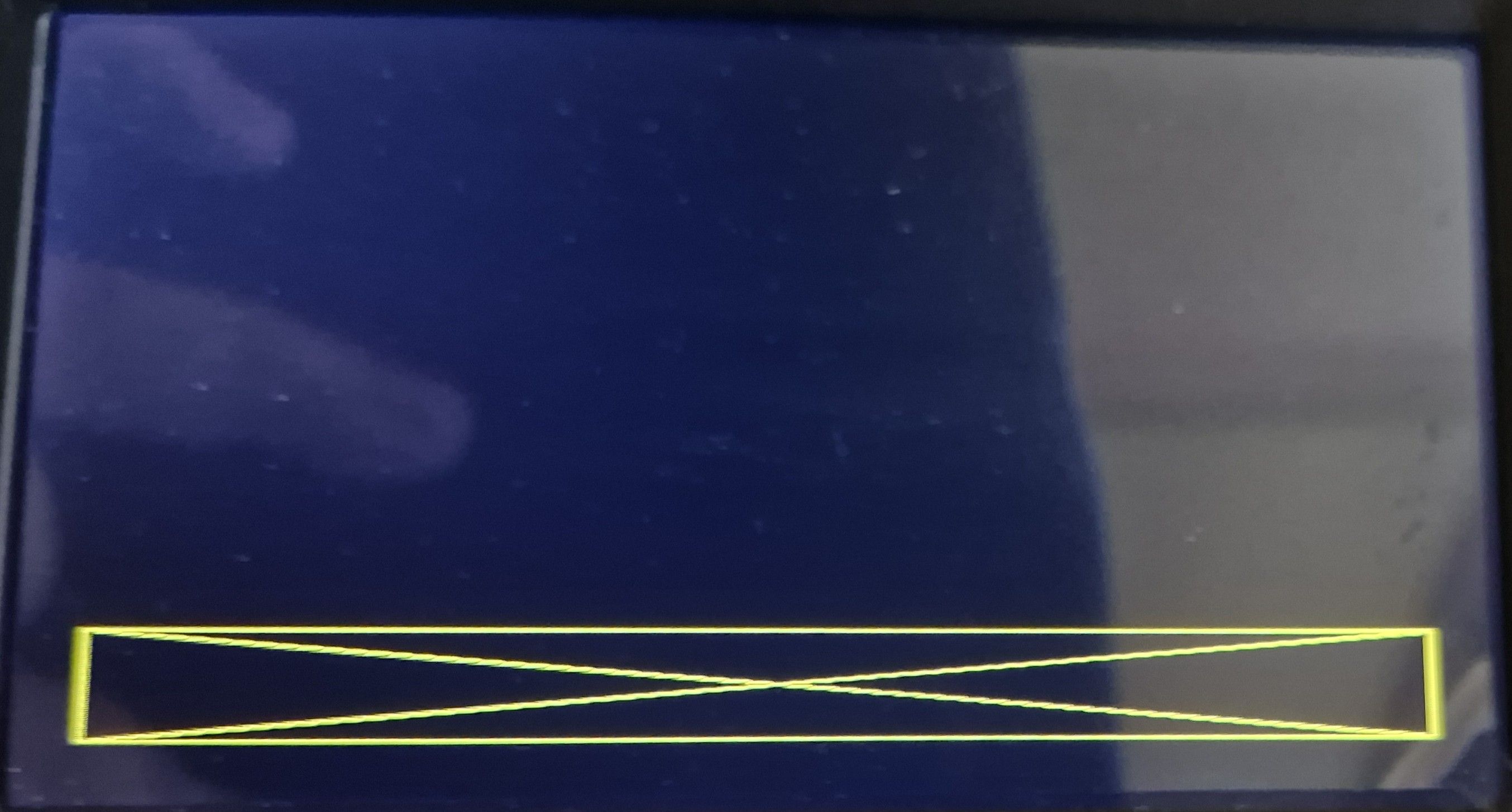

I had to use a new and empty 32 GB SD Card, well formatted. The scanner shows a yellow rectangel with a yellow cross in it when I wanted to start scanning.
I put a text-file on the card an scanning was running. Just to report the behavior.

I don't follow. Attach pictures
Hello TheElk,
I can't reproduce your findings.
My 32GB card isn't recognised (as soon as I try to start recording, this yellow St. Andrew's cross appears).
I can start recording with a 128GB card, but nothing is written to the card....
so I'll stick with the 16GB card for now... :)
I have to correct my expression. I formatted the ard with 8 k, showing the cross with and without a file, 16 k showing the cross with and without a file, 32 k was today workig without additional file.

Hello TheElk,
Kind regards,
Thomas
What Blocksize did you use ? See my answer on post ( #859 ). May be try to put a small file on the card when attached to your PC.
