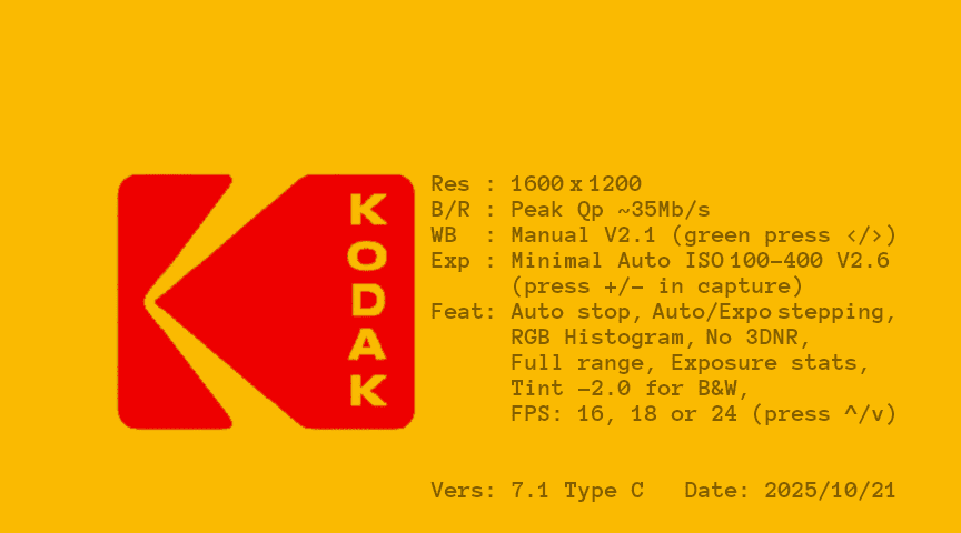

The boot screen, if updated, will show:
I've only used 32GB cards with stand formatting (defaults to FAT32.) If is very new, it likely Type C.

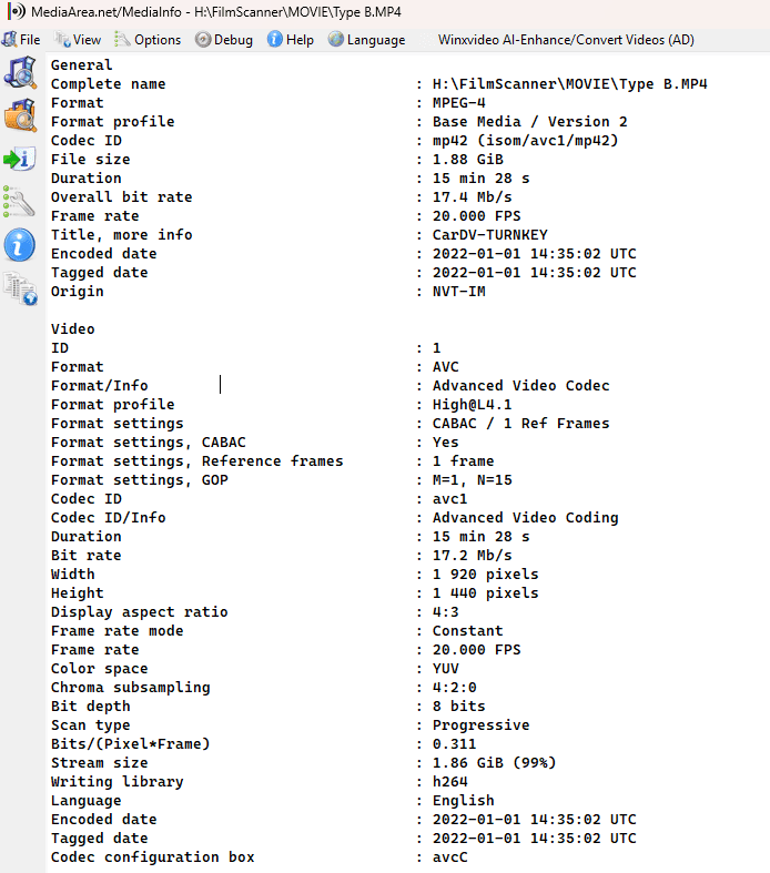

Here’s the MediaInfo for Type B:

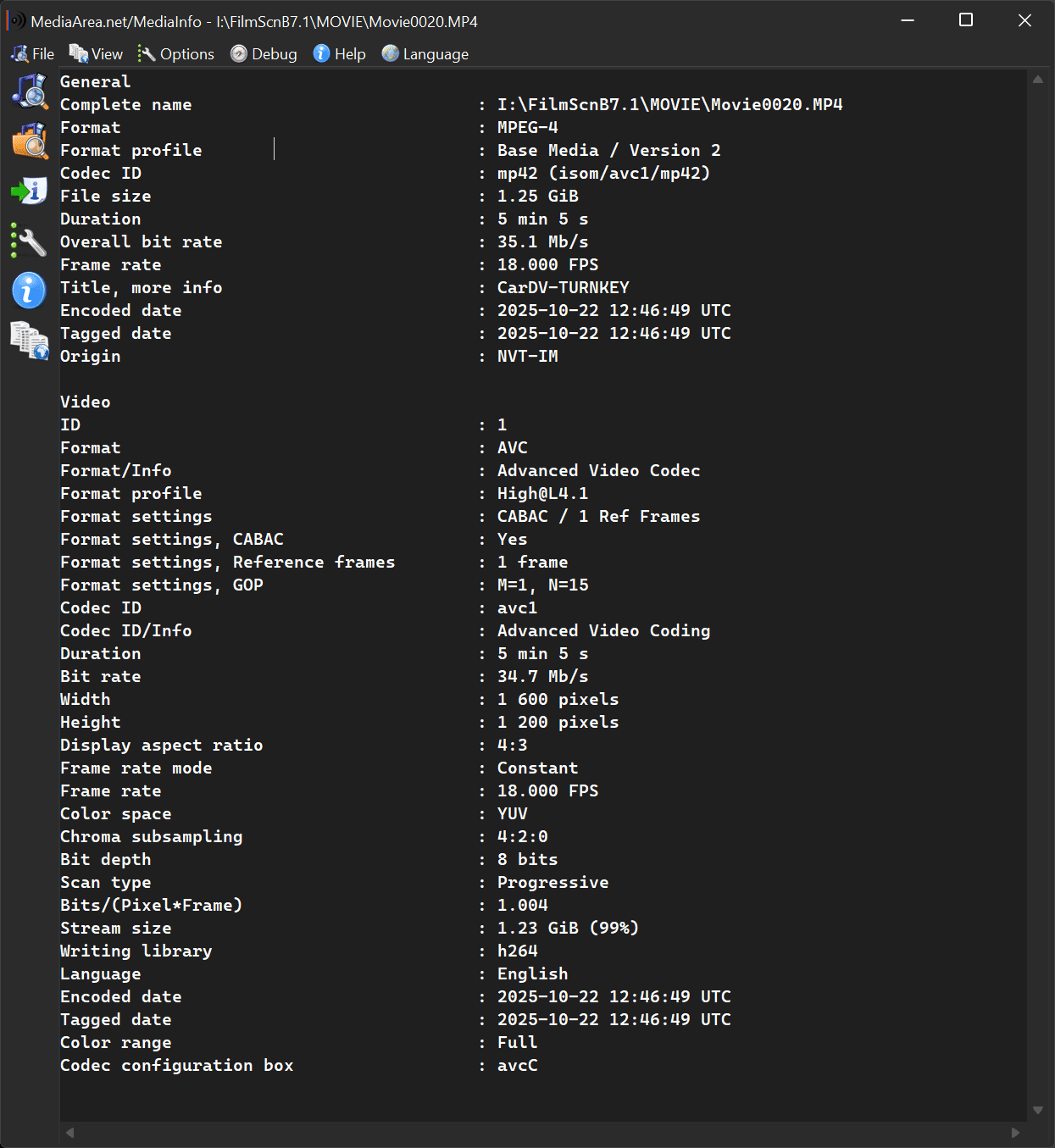

That looks like Mac84 firmware, not 0dan0 v7.1. The original firmware hack didn't modify the boot logo, that is way you didn't see any change on the firmware update.
Other big differences: resolution at 1920x1440 (not 1600x1200, remember the stock lens can only resolve ~640x480, more resolution is not always better), bitrate is lower (not 35Mb/s), and 20fps is the stock framerate (not an 8mm or Super8 fps.) The v7.1 firmware has a lot of additional fixes, more stable exposure and a manual white balance control. My firmware also updates the date to 2025-10-22.
Attached is the latest Type B firmware if you want the above and more.

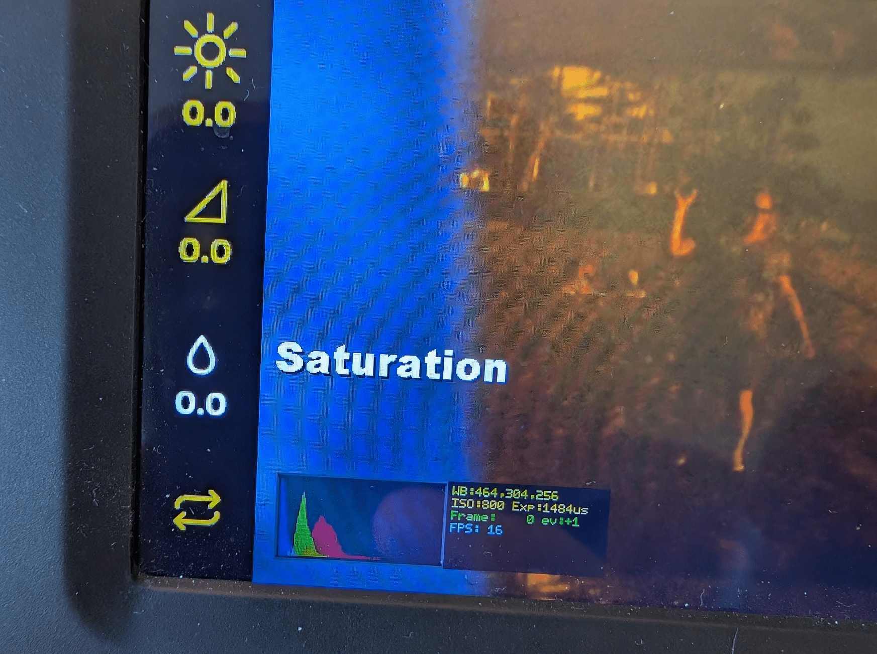

It seems, that I'm recognising something mysterious. I'm scanning one film after an other. After some films I switch off the scanner, take out the SD card, copy the files from the card, erase them on the card, put the card back in the scanner and turn on the scanner again. There is no film in, the color settings are changing, I can see that in the little histogram. OK. He adjusts. I hadn't changed the White bal and green yet. I recognised, that the first value stays always like it was at switch off time. I believe, same to the last value, but the middle value often changes. I hat 256, after switching on it goes to 324 or so.
Second mysteria : I recognized, that in dark shots there was a shine on the capture from the sprocket hole. So I had an inserted film, went back the frame adjust with down arrow five times, checked the scanning window, putted it 2 times more left, went back with up arrow five times. I repeated the back-forth-left adjustment a second time and went back to the recording setting. I also recognised, that the middle value in the histogram was changed, from 256 to 224.
That means be careful if you have many films of the same historic time and vendor and want to scan them all with the same adjustment ( because you figured out that it fits best ) and check if the settings have not changed for every new scan.

Yes, as the firmware is re-using the left and right buttons for green tint, any longish presses while framing may also alter the tint. I should probably make the green tint presses longer.
