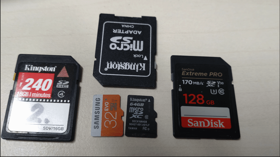

What Blocksize did you use ? See my answer on post ( #859 ). May be try to put a small file on the card when attached to your PC.
What you all knew already... :giggle:
Based on TheElk's suggestion, I formatted a few cards with Fat32 32kb blocks (only possible in Windows with additional tools such as Rufus – Windows does not allow this formatting > 32GB with 32kb block (although it is actually valid according to the FAT standard definition))...
... and what can I say : the scanner scans and scans (y)
maximum test: 64 GB of nonsense written to the 128 GB card – and then continued scanning with the scanner – so far so good
Belongs to the topic: good to know – but not really necessary... :cool:
I'll keep quiet for now that this also works with a 64kb block size... 🤷‍♀️ :cool: 🥳

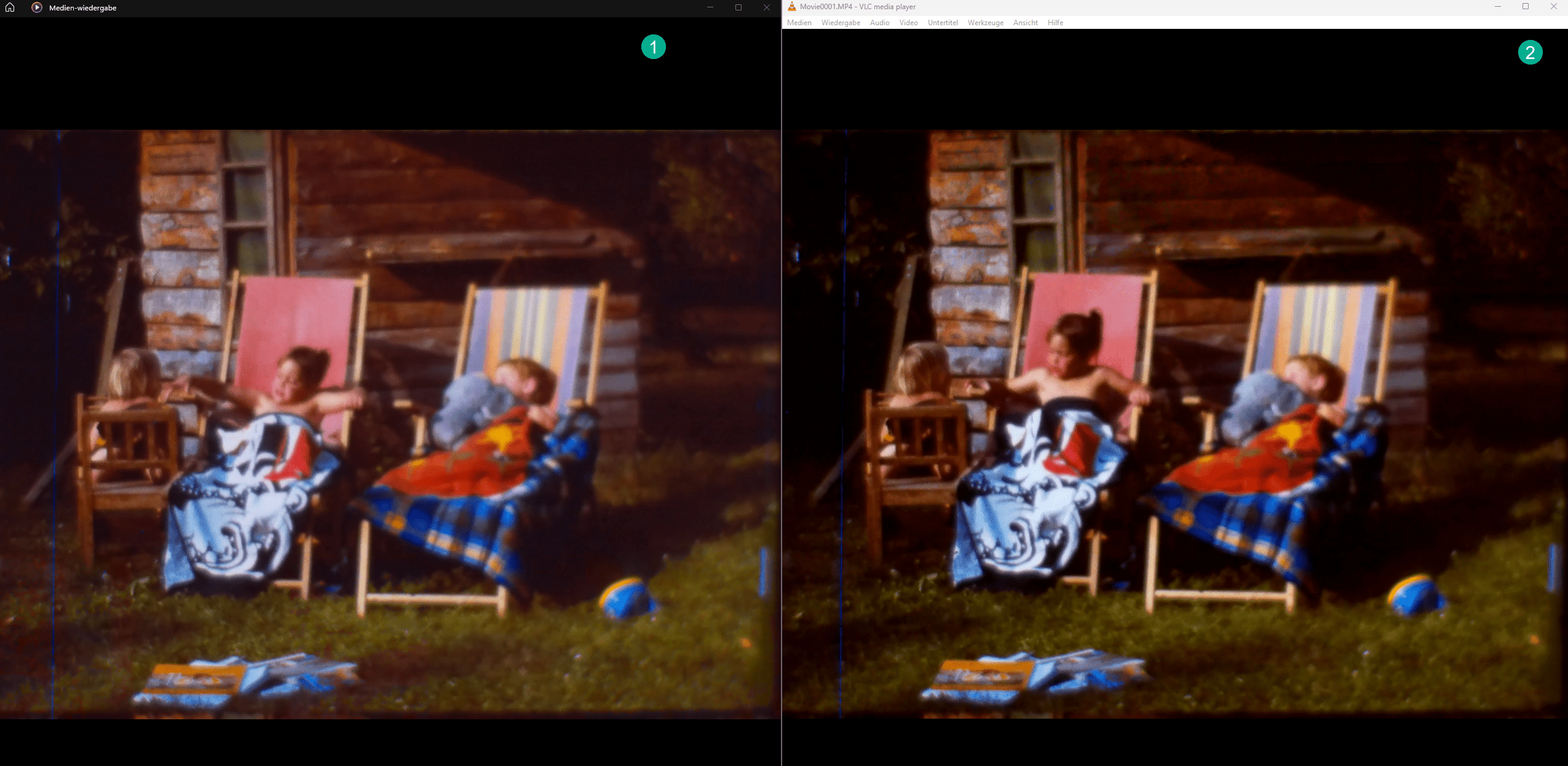

Regarding image sharpness, I just noticed that my previous assessment of the raw material (i.e. the MP4 files directly from the scanner) depends heavily on the MP4 player used...
With the VLC player, the image is much clearer than when using Windows Media Player.
1: Windows Media Player
2: VLC
...as always – all factors can play a role...
2: VLC
Some older players are not acknowledging the full range metadata, that is not sharpness, rather an increase in contrast (also a clipped dynamic range.)

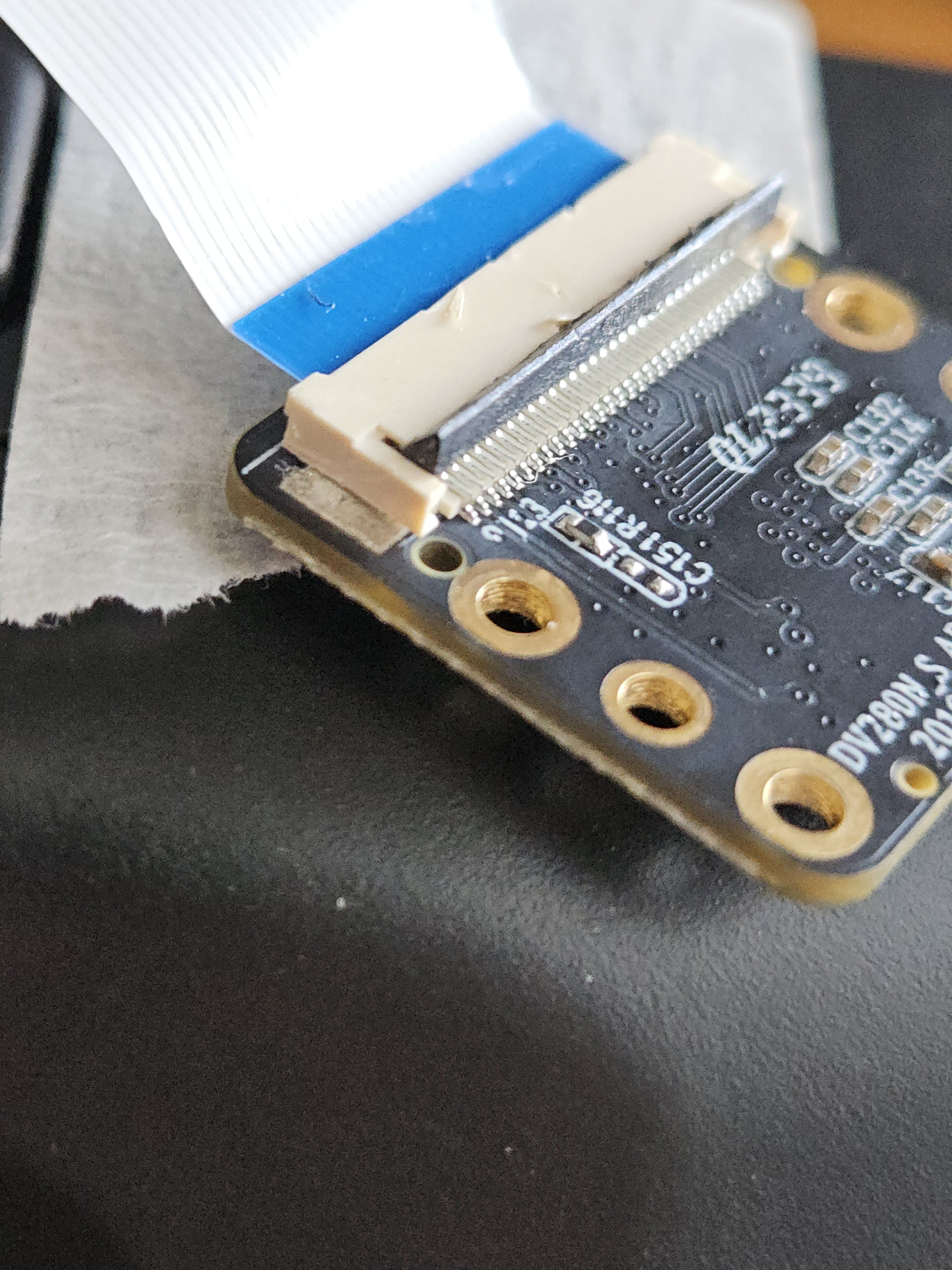

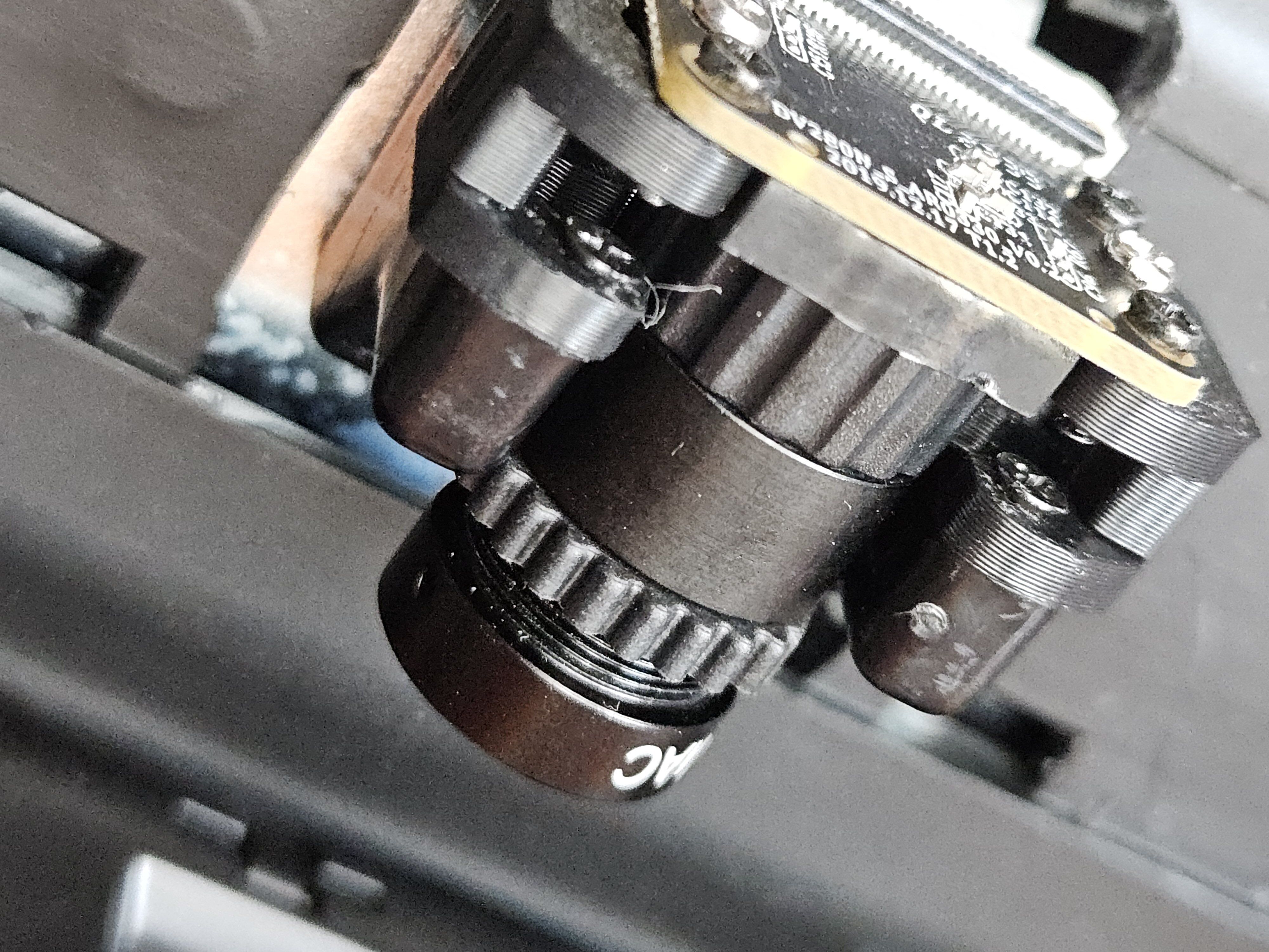

Hi all, I've just mounted the newly arrived 12mm lens.
I live in Hong Kong so I've tried to find the lens around here (China). After a couple of fails, I've finally got this one working perfectly through Alibaba:
2/3" F2.8 F5.6 F8.0 10mp FL 12mm 4k M12 Macro Board Lens​
They will sell a 'sample piece' (there is an option in the price section). They took almost 3 weeks to ship, then the good arrived in 2 days to me in HK.
They have different models, I got the 2.8f, but probably I should have bought the 5.6 for a bit more depth of field, but it is what it is...

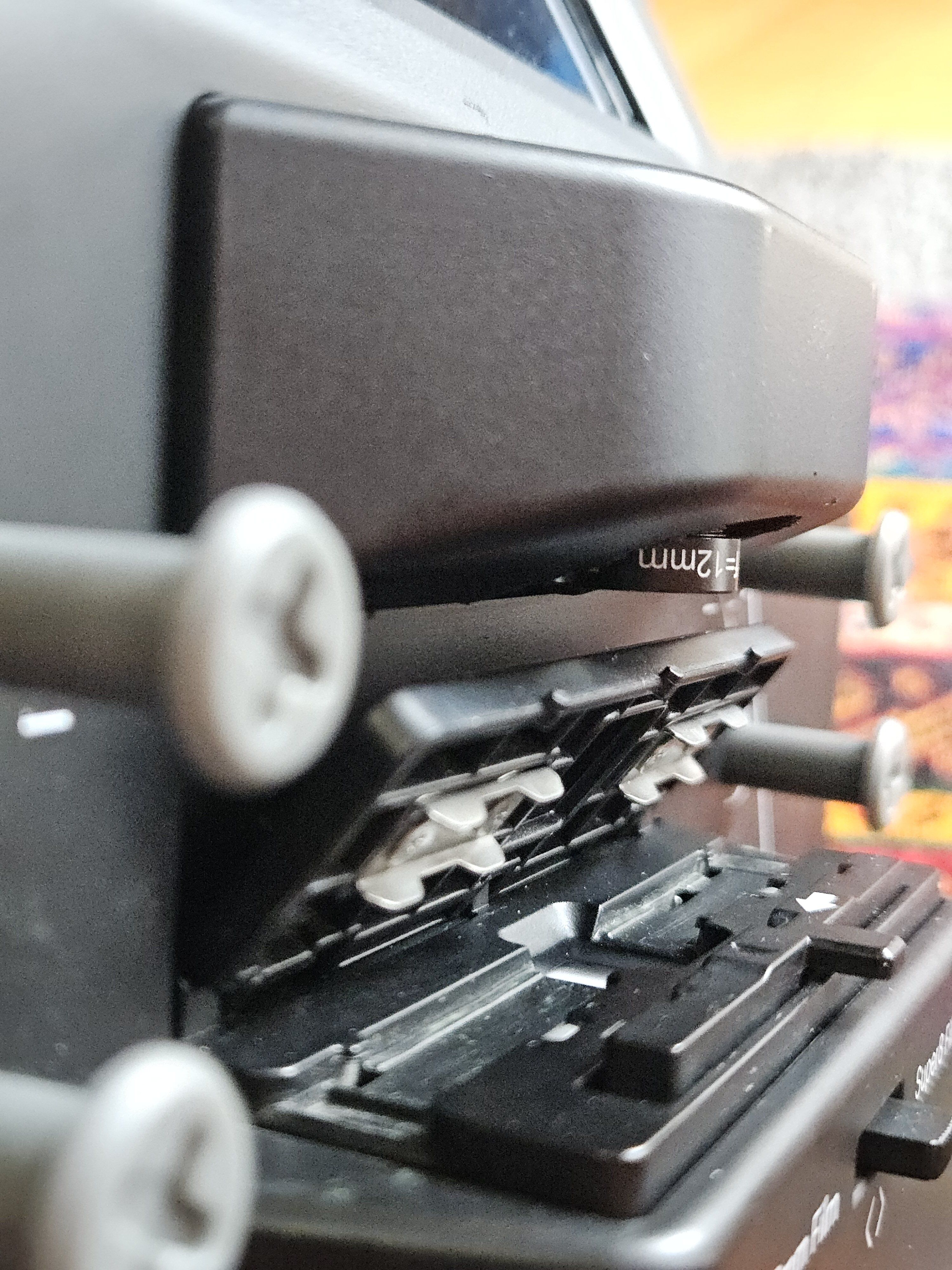

I've used both a new mount (I've bought a bunch of different lengths from Aliexpress here) and the 7mm extender here. with the 2.8f you need to try different combinations. At the end I was tired of try combinations and I stood with this one:
The lock ring was from the same shop in Aliexpress where I got the extender, here.
To remove the lens cover, gently but firmly push up the bottom and the sides (there are two plastic latches at the bottom and one on each side, and it will rollup.

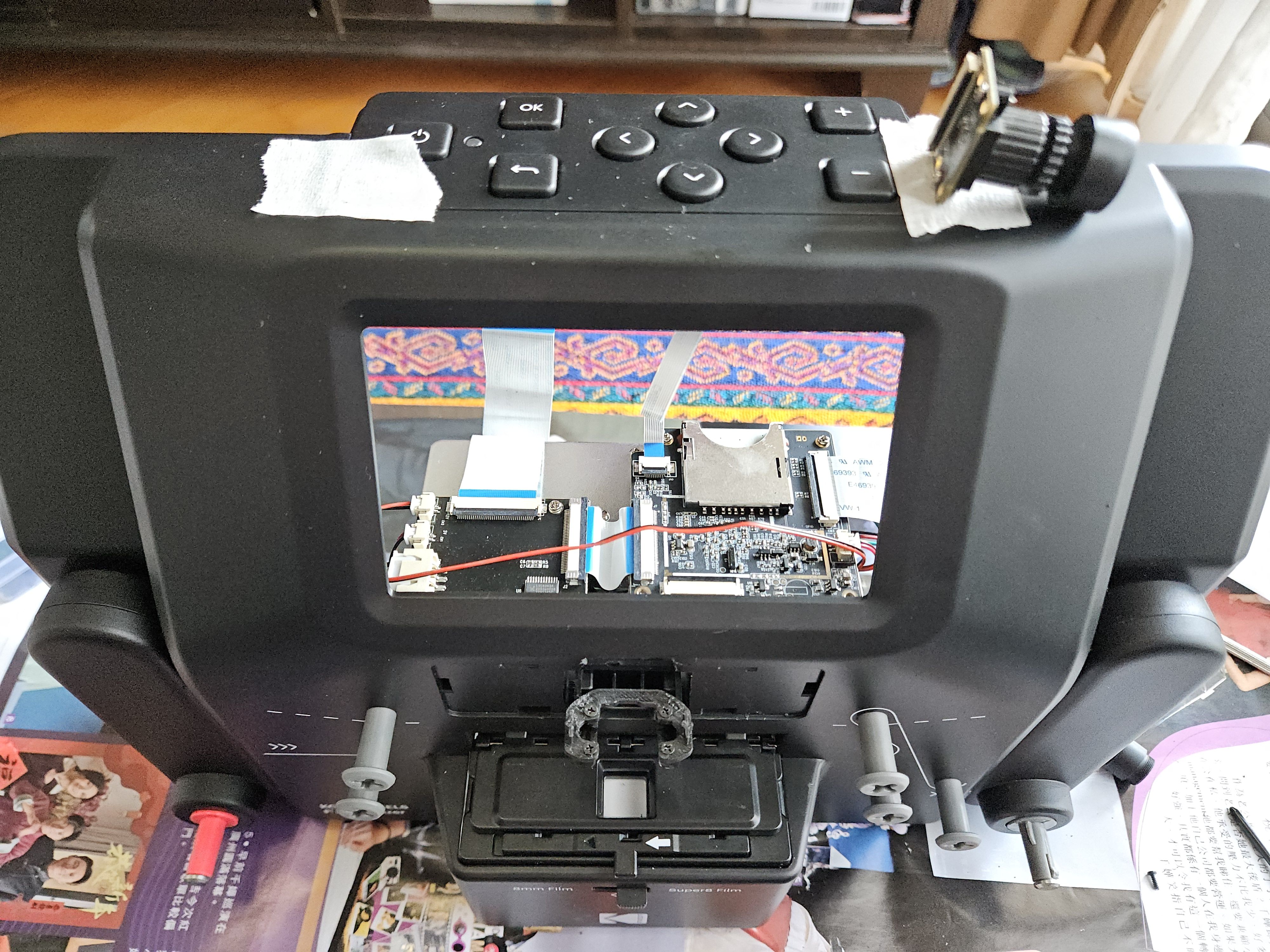

To detach the sensor from the flat cable, the black segment in the connector must to be flipped up, as shown in the picture (I thought it was one of those that opens by sliding but it was instead the flip-up one):

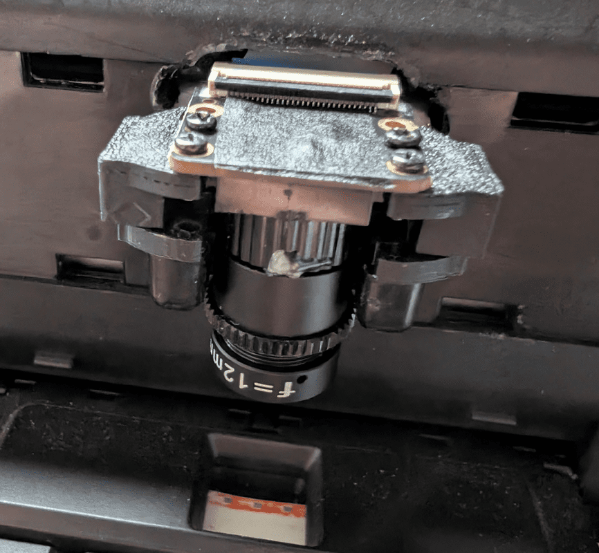

I've opened the whole scanner to be able to cut the space for the cable when the sensor is at the new position:
And used the wonderful 3D printed holders from @0dan0 (can't thank you enough!)

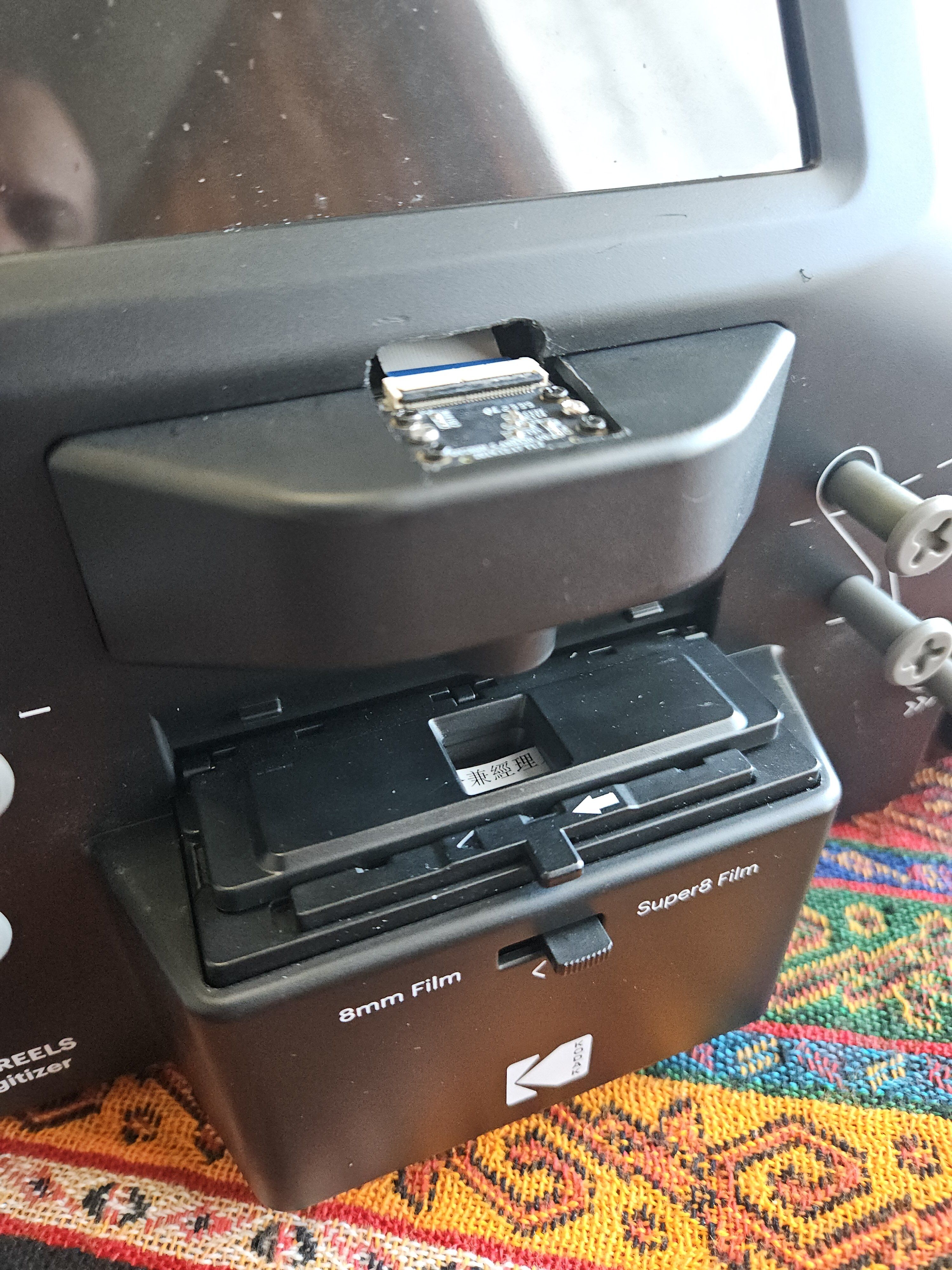

Last I've focussed, tightened the lock ring and cut the slots in the original cover to put it back: having the camera so exposed made me feel uncomfortable...(if you want to do the same, you will have to rotate the cover upside-down, with the flat side on top and the sloped one at the bottom. In order to do so, you need to trim a bit the latches that keep it in place, because they are not symmetrical):
The new lens is not too long and there is plenty of space between the tip of the lens and the opened loading bay door.
The overall process is not difficult, but some parts will need some repetition (for example for me was the right combination of mount+extender).
Hope this helps with the lens replacement.
Ciao, Federico

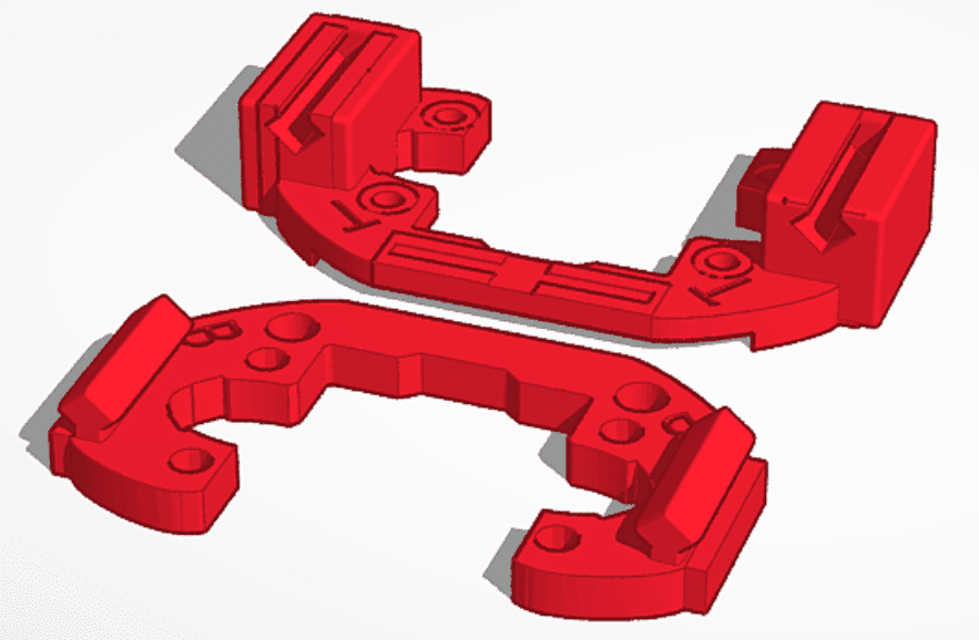

I love how you have restored the camera cover. You should add some cover for the circuit board, as there is a small amount of light that can leak through the PCB. In very dark images, with a lot of sensor gain, you can see circuit outlines, which is a tad bizarre. I just did my third unit, with the same F2.8 Lens.
With a piece of black masking tape over the circuit board.
This is a newer version of the 3D print. The vertical attachment to join the two halves was a little fragile, so I made a newer sturdier design that supports top half siding in from the front. Shared: https://makerworld.com/en/models/2000850-reels-scanner-lens-offset

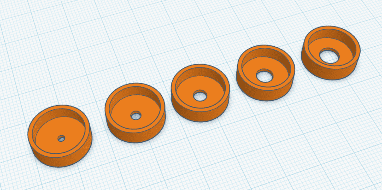

I agree that F5.6 might be a great option, but I don't believe you need a new lens of this, just 3D print an iris for the front of lens.
