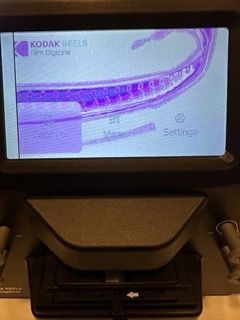

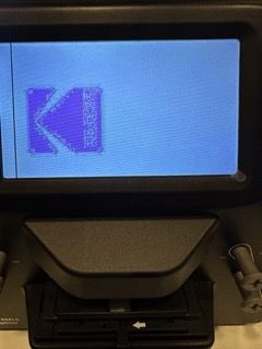

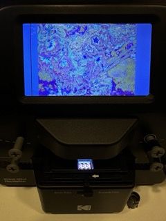

Hello, I am writing from Italy.
I own numerous 8mm films of my dad and grandfather, home material, but also family memories that I wanted to digitize before the films, now more than 50 years old, got too damaged. Unfortunately to convert all them with professional services the costs would have been too high, and digitizing by projector and camera, though it gave decent results, required too much work. I have been following frame-by-frame digitization products for years, I was thinking of digitizing all the material at home and then selecting the best films to have them converted by a professional, but I had not found a scanner model at an affordable price that had the features I was interested, in such as good resolution, acceptable lenses, adequate frame rate and a high bitrate that would allow me to reprocess the video, without losing too much quality. Reading this forum convinced me that the "Kodak Reels" was an interesting product especially because of the great work that Mac84 and all the other enthusiasts have been doing, optimizing the firmware to maximize resolution, quality, and bit rate. Really a lot of compliments for the work done!!!
So I just bought Kodak Reels on Amazon and got version 2.0. I tried it first with factory settings and everything worked fine, so I wanted to try the optimized firmware I found on the forum, with higher rosolution and framerate (V2). Unfortunately, after re-flashing the device's display is completely "stoned" and, although still usable for basic functions such as centering, configurations, etc., it does not allow "understandable" display of the image. I have tried loading the different firmwares, as well as restoring the original 2.0 firmware (again taken from the forum), without success.
I wanted to ask if others also had the same problem, especially those who own European "reels" models received already with V2.0, I don't think it is a hardware problem because it appeared only after loading the first modified firmware. I hope someone can help me "restore" the display. The movie digitizing function, on the other hand, works properly. I'm grateful for any suggestions. Raffaele

View attachment 14876 View attachment 14877 View attachment 14878
I'm sorry to hear about these issues. I only have the US model to test, and I cannot test any mods with anything besides the 1.0 and 2.0 US versions I have.
Sadly, to dump the original firmware someone needs an unmodified device and they need to solder three small wires to the main board in order to invoke a firmware dump command. This is the only way I know of how to dump the firmware, although there may be another.
Do the resulting captures appear okay if captured and then played back on your computer?
If possible, I'd see if you can return your unit and have it swapped out. I'm not an expert, but maybe there's a command in the firmware for language / region. If you navigate to the settings menu and change the language, does that seem to change anything?
I do now have a version 2.0 device. I only received it in December but haven't had time to post about it, that's how the 2.0 firmware was archived here. However, there may be "silent" changes inside the hardware that we're unaware of, or it may be a region-specific thing - therefore not all devices may be the same. The 2.0 mod works on my 2.0 device, but I can't obviously speak for any others. Especially those sold outside the US, they may use different items or different settings (like a screen refresh rate, etc)
Hello and thank you for the answers
I was aware that loading a non-original firmware could create problems, maybe there is some small difference in the hardware and consequently also in the software that caused a mismatch. I have already checked if through the menus some settings were possible, but nothing changes. I don't plan to return the device also because the digitizing works well and the images are correct even with the Higher Bitrate - Original Resolution (V2) version. Maybe if someone in the meantime will be able to dump the firmware from a new version and would like to make it available, I will be happy to try it!!! Thanks again, now all I have to do is listen for hours and hours to that nice "metronome" noise.... Raffaele
