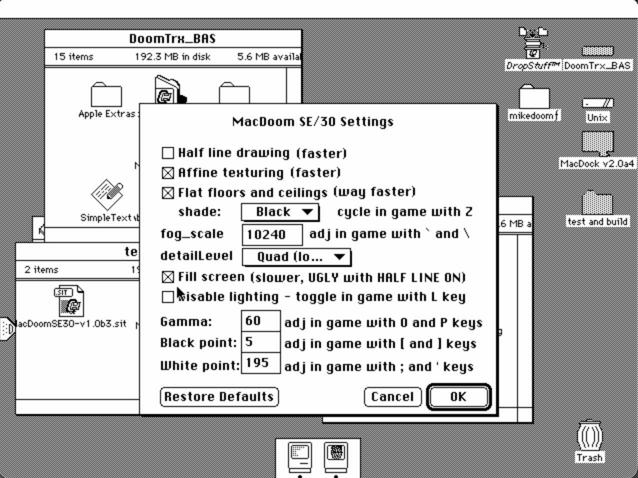

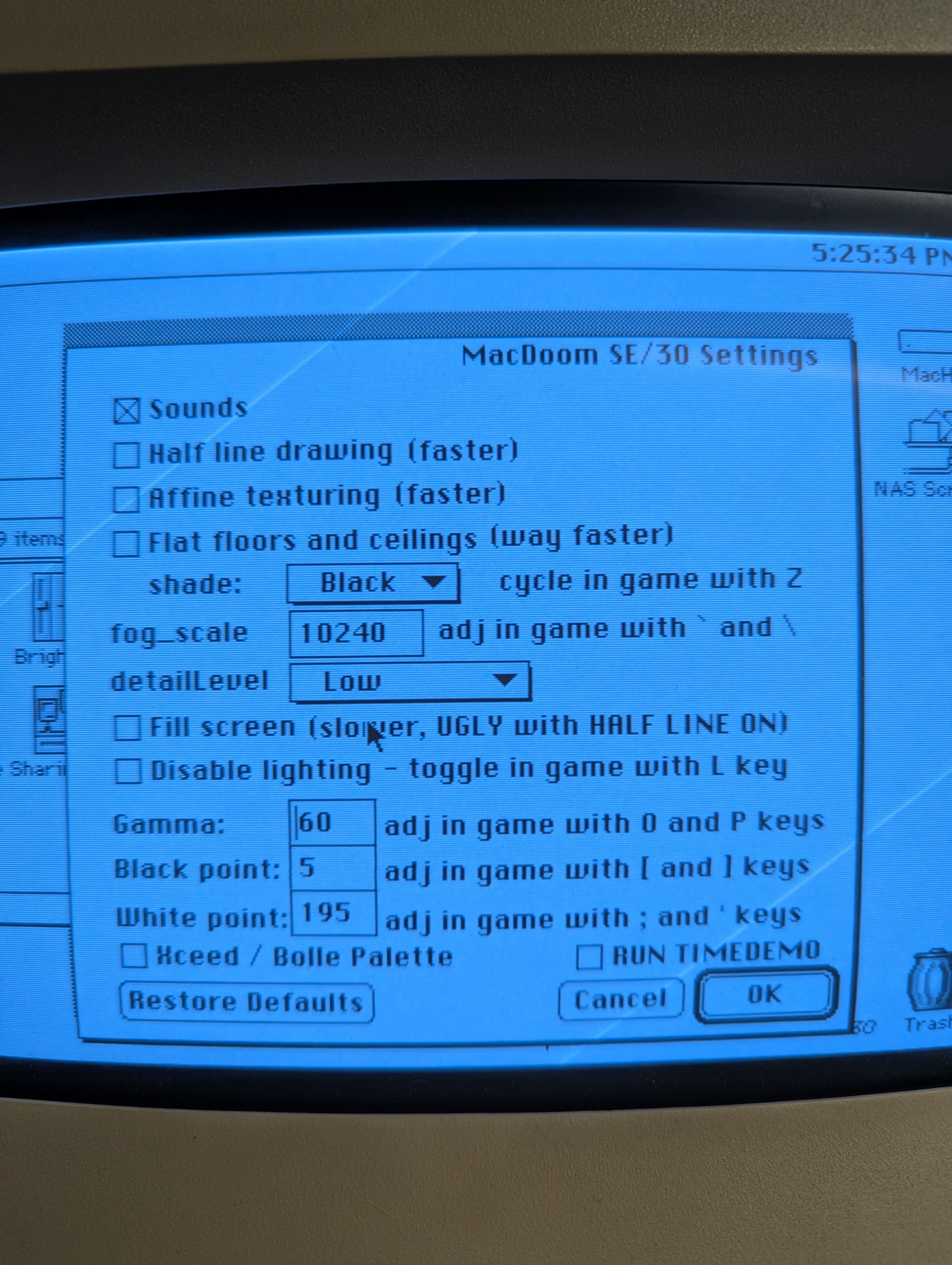

As the options menu state,
  • ‘o’ and ‘p’ keys adjust gamma (more o means lighter)
  • [ and ] keys adjust the black pt
  • ; and ‘ keys adjust the white pt
If you land on nice values, share them by all means. (quit game, launch game, go to options…, and the values will be listed there from your last run). And let me know if you’re happy with the settings with/without the Xceed/Bolle option.
Similarly, if you test on your color machines and land on happier values lmk what they are. Desired end result is to have a good set of defaults for the correction params (gamma, white, black pt) for B&W (already have those, the current defaults), Bolle/Xceed, and Regular color Macintoshes.
True do-nothing values for these options (which you can type into the Options boxes) if you want to start from what the game was before these settings did anything are:
- black pt = 0
- white pt = 255
- gamma = 100

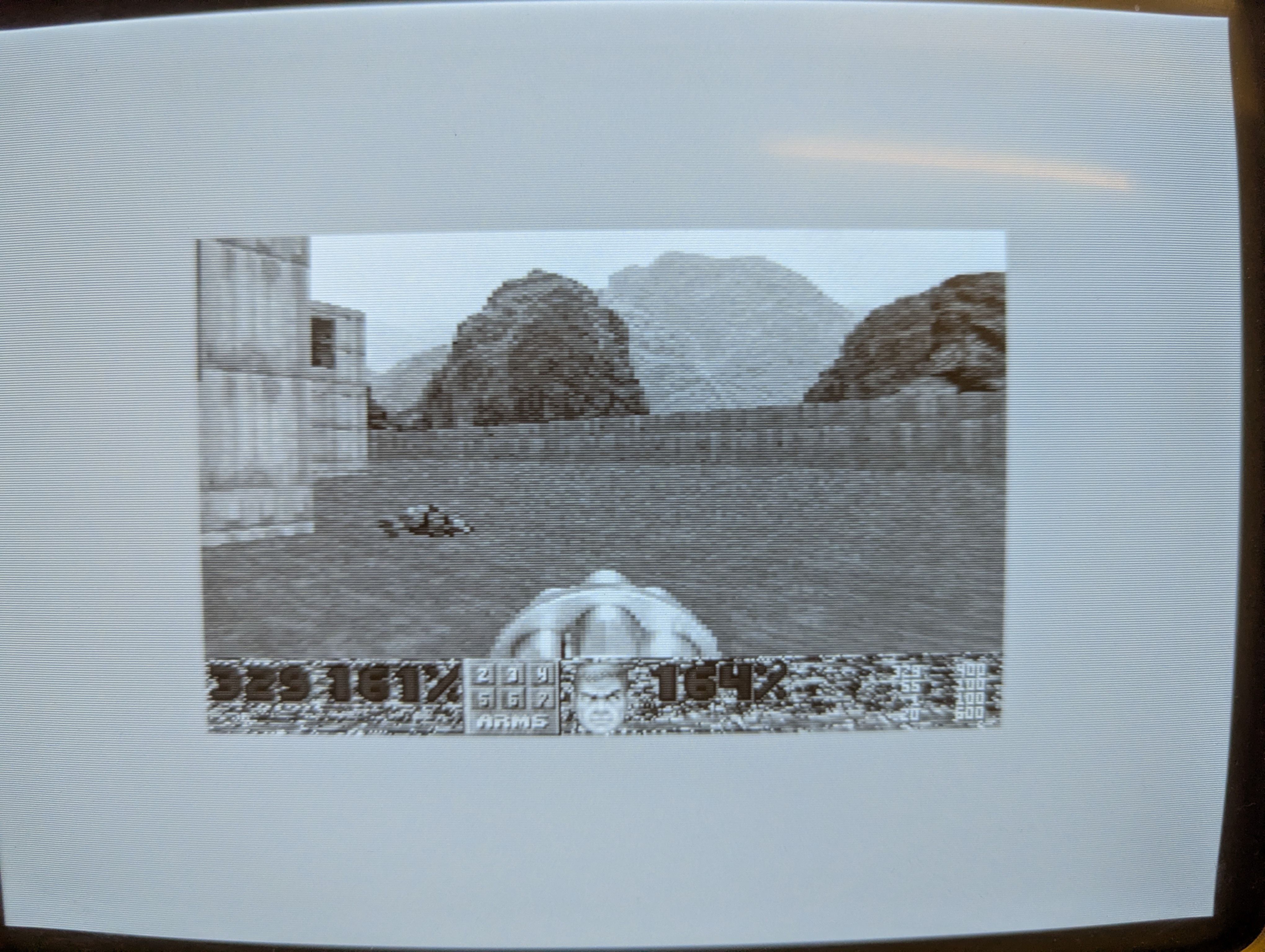

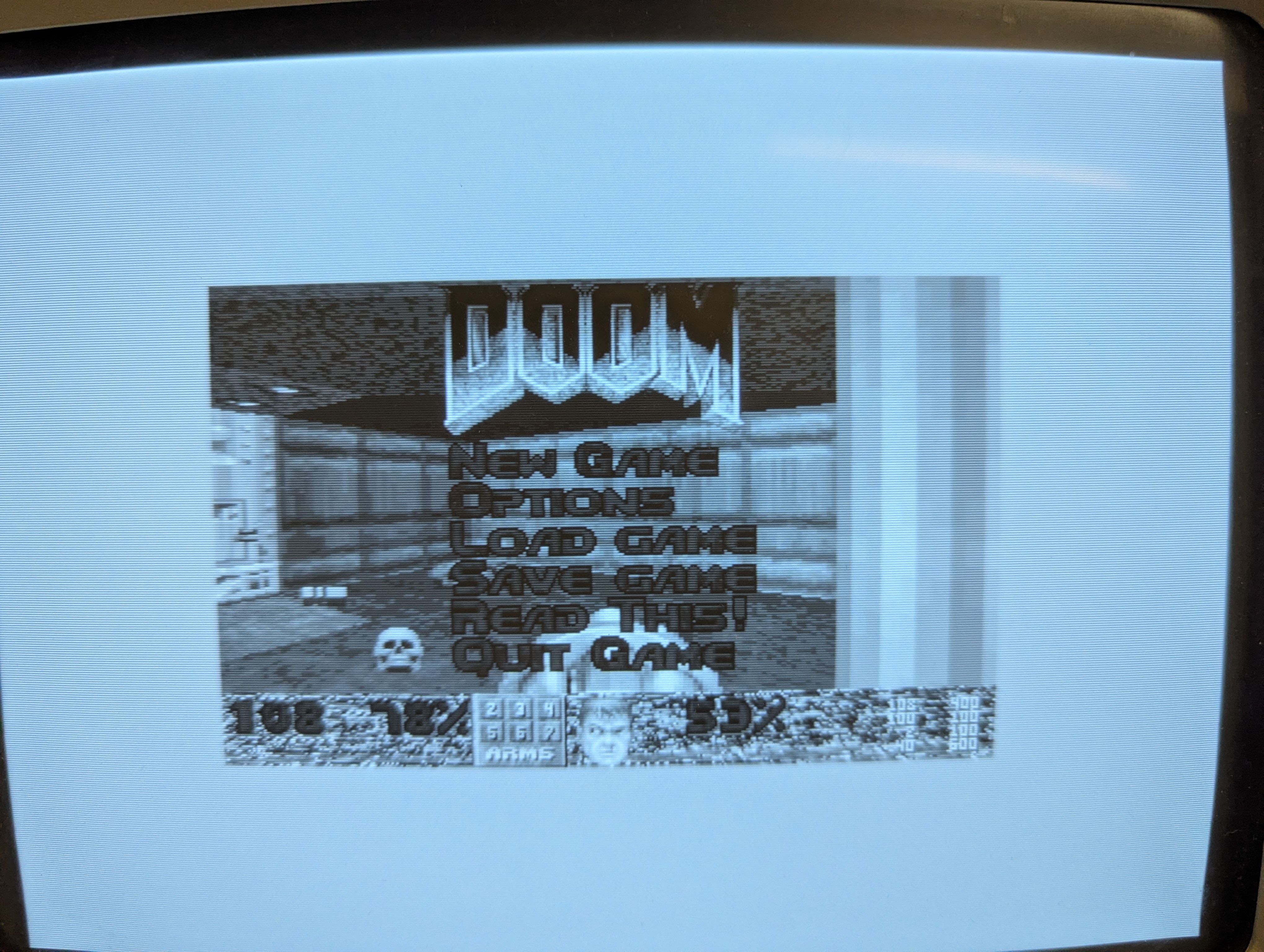

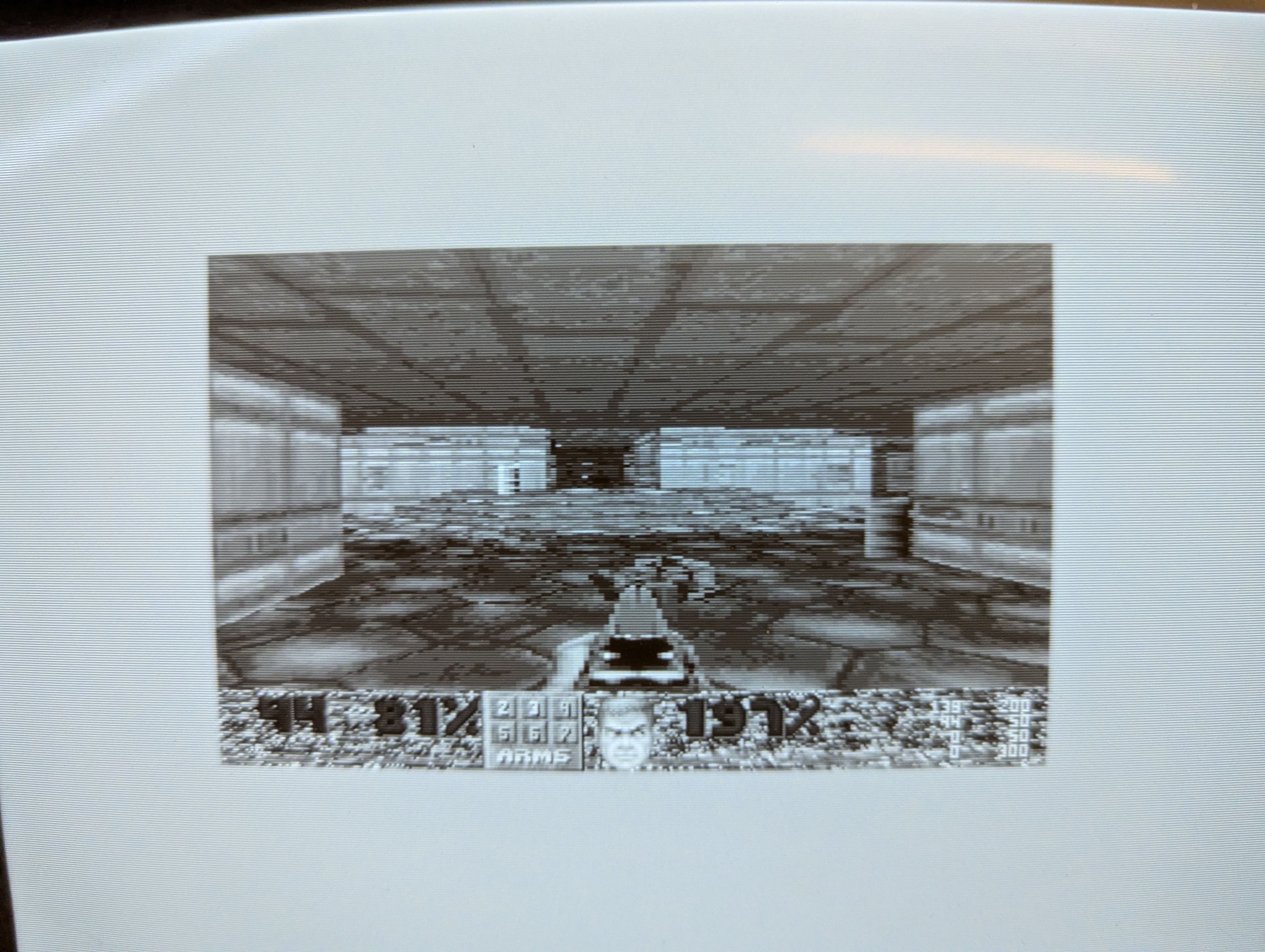

It looks like all that was needed all along was to apply gamma correction and variable white/black points to the color rendering path (and therefore the grayscale path...the game doesn't know the difference, QuickDraw handles the conversion). The default gamma/BP/WP values of 60/5/195 looked great on both my grayscale SE/30 and Color Classic...both grayscale and color rendering were much improved over the 1.1.0 release. Some photos of grayscale with the CRT brightness set to a reasonable level that made MacDoom 1.1.0 much too dark (these looked even better in person...my phone camera doesn't do them justice):
PXL_20260502_220920667.jpg PXL_20260502_221100326.jpg PXL_20260502_222041303.jpg
On an '040 SE/30, it was buttery smooth with these settings...setting detail to "High" was playable, but just slightly less smooth than "Low":

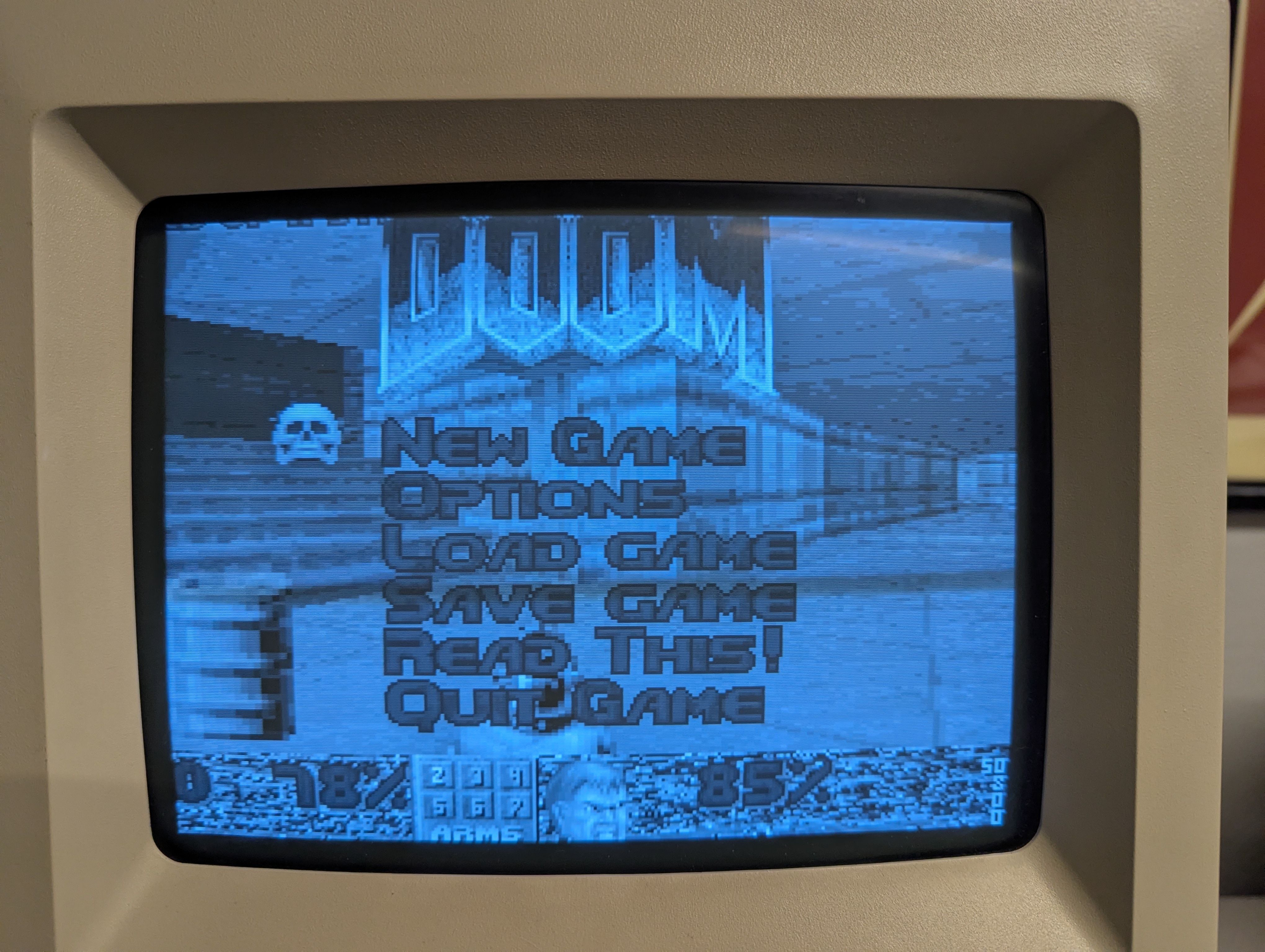

As expected, enabling the "Xceed/Bolle" option resulted in a nearly black screen because QuickDraw was internally converting a bunch of pure, dark blues to shades of gray, which are going to always be really dark shades of gray. I think you can safely ditch this option, as it's unnecessary and doesn't do what it thinks it does.

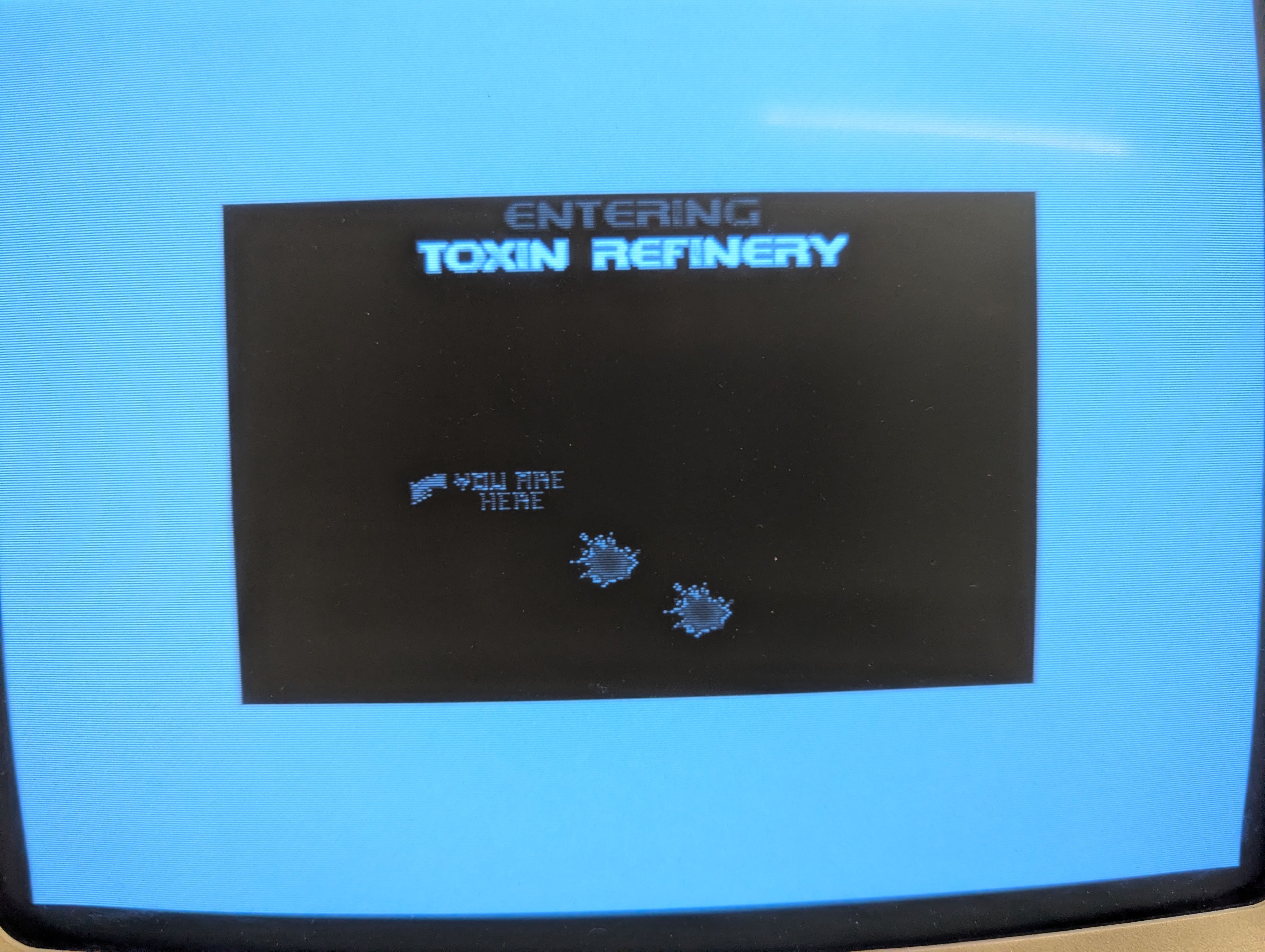

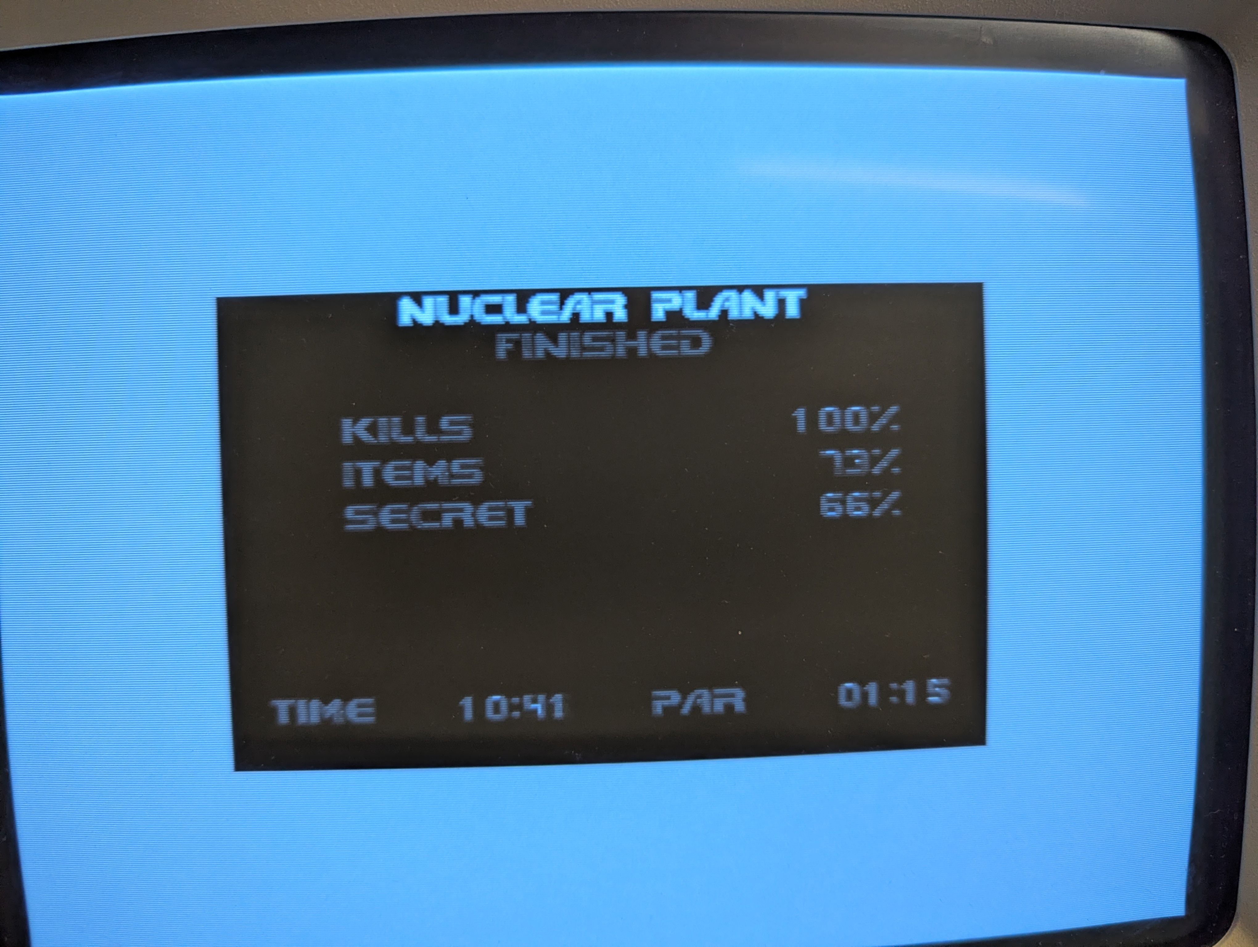

3. The between-level splash screens are black:

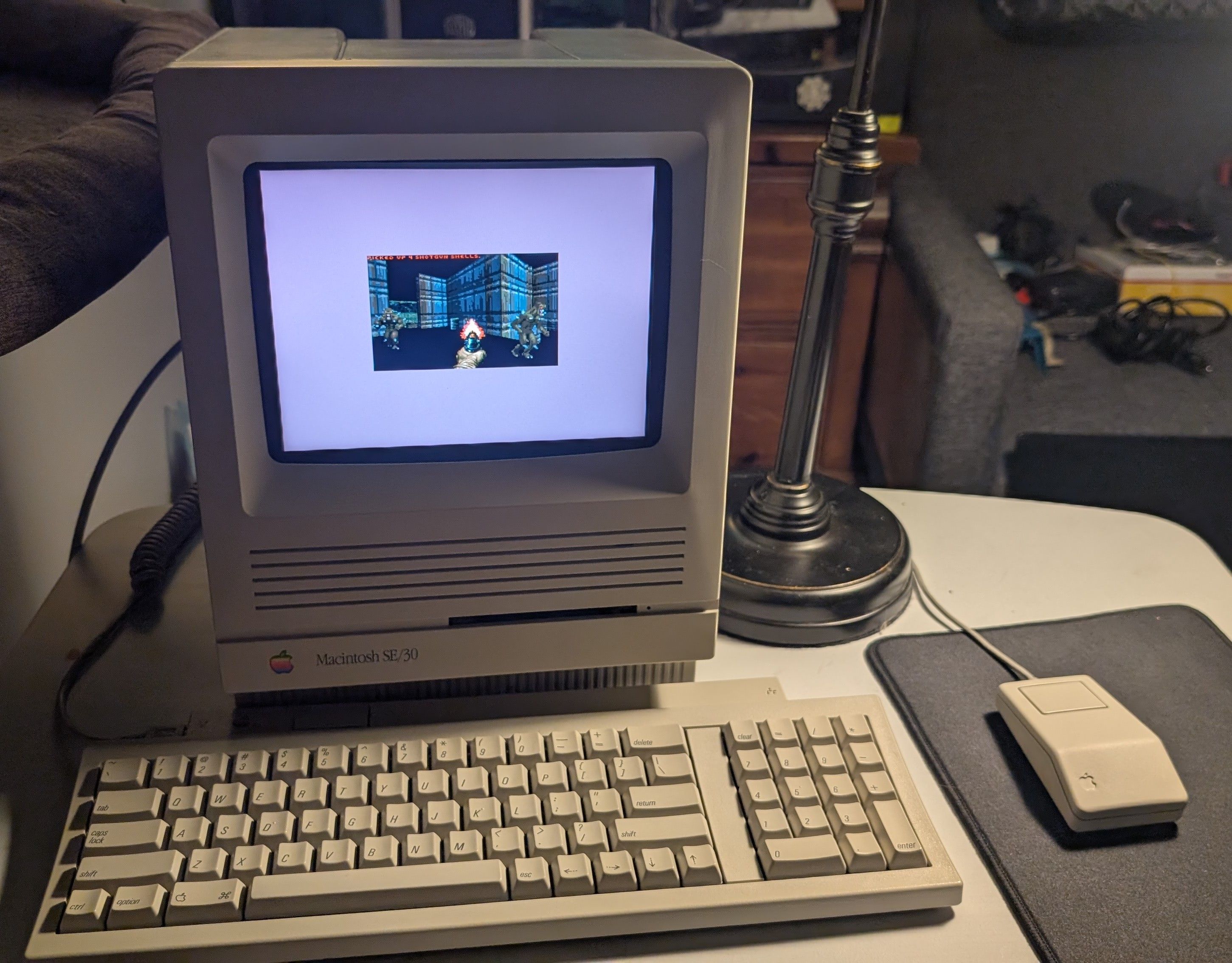

@MacOfAllTrades I gave your Doom port a try with my heavily modified SE/30.
This SE/30 has the following:
> Zigzagjoe's Booster 2.0 - ROM booster enabled
> Zigzagjoe's se/30 color Lcd kit outputting 256 colors @ 640x480 resolution
> Garrett's Workshop GW4402B ROM
> 128mb of RAM
Game runs pretty well, however, I cannot get the full screen mode to work. The game stays small in the center whether the option is checked or not. Otherwise I say it looks very sharp with the color Lcd.
