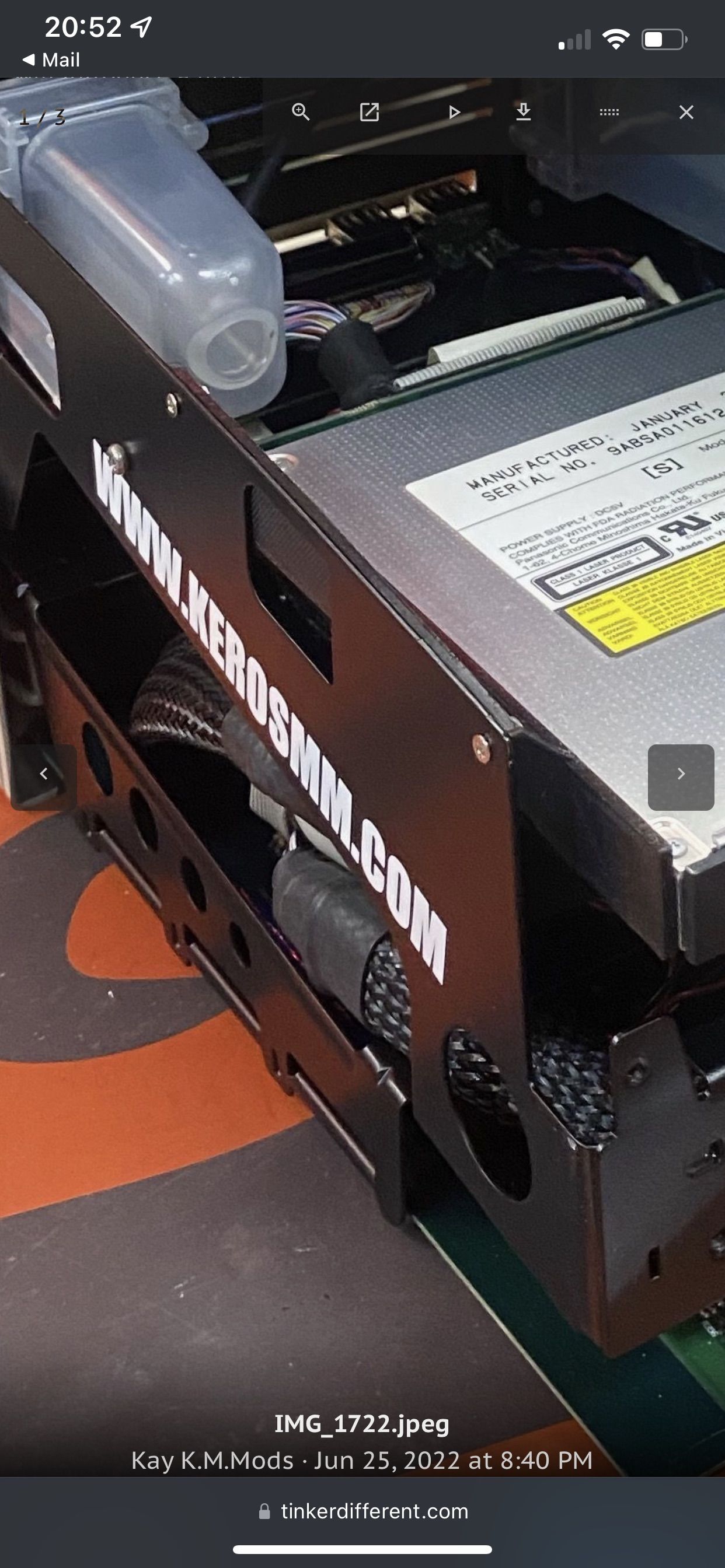

Hi, I have an iMac and it's a little different from yours, but I will introduce a little.
This was made 17 years ago...However, it was out of order, so I was repairing and recreating it this time.
I didn't use the LCD, I'm doing it on a monochrome monitor. I will make another post soon.

I love your black coated chassis.
So do I, @Kay K.M.Mods! :love:
Having the chassis baked black is one option. @JDW mentioned that @MacEffects had the chassis nickel plated. I researched in my area where I could take the chassis to nickel plate it and realized it may be too costly?
I am thinking if there are other approaches? Any ideas?

To be precise, the plating used on the chassis is bright chromate conversion coatings. The HD housing is the same, but I think the floppy drive housing is often chrome-plated (zinc base).
If re-plating is to be applied, the rust must be completely removed by surface treatment. And a clean, scratch-free surface is preferred. The plating is often not very thick so it will not fill the scratches.
If you want to paint the same gray color as the genuine one, you may have toned the matte candy gray. This is closer to genuine.
However, since it is a candy color, spots will appear if the base is discolored. But it's better than damaged.
