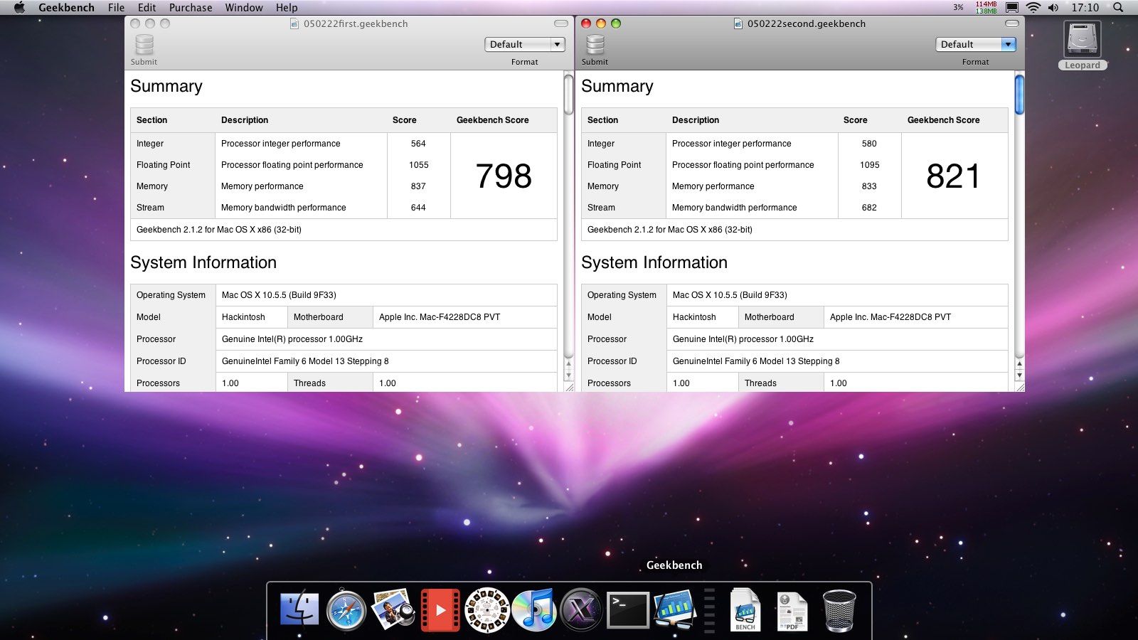

It's not half as bad as I expected and after running my normal Leopard speed-ups I gained an extra 23 points in Geekbench! Screenshots also show MPlayer doing 720P with ease!

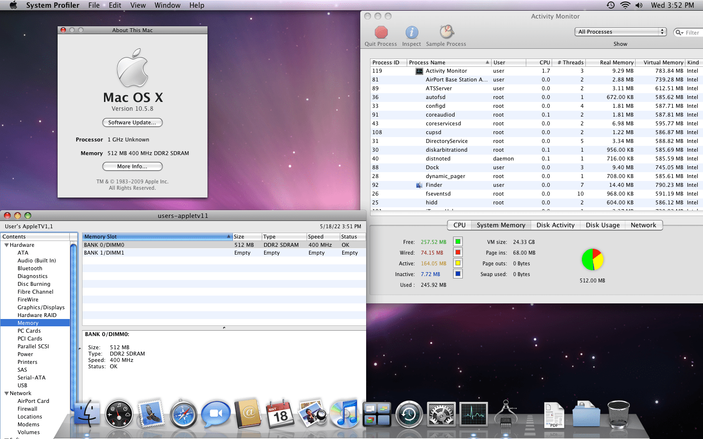

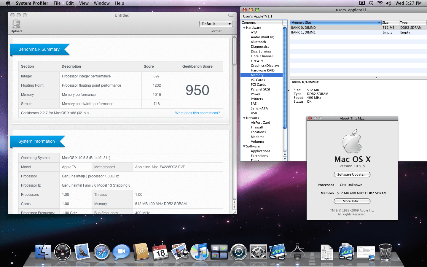

Leopard runs remarkably well on these after upgrading the RAM to 512MB. You can see details about that upgrade here:
One thing I noticed, though, is that the image linked on the OP (10.5.8 v2) was using a Darwin 9.4.0 kernel, which is not correct for 10.5.8. Switching to a 9.8.0 SSE3 emulator kernel, attached, improved the performance of the system by a LOT, but unfortunately broke AppleHDA. I worked around this by using VoodooHDA.kext, also attached, which works, but the audio output is oddly quiet. HDMI audio still does not work. @scj312, I'd recommend updating your image with this kernel, as it really makes the system run a whole lot more smoothly (at least on my system with 512MB of RAM).
View attachment 5059View attachment 5060
Very cool seeing this on 512 MB! I'm sure it is a heck of a lot more usable. While I didn't notice an improvement with the 10.5.8 kernel on 256 MB, I'll try some ideas I have to fix audio and upload the result! Thanks for bringing this up.

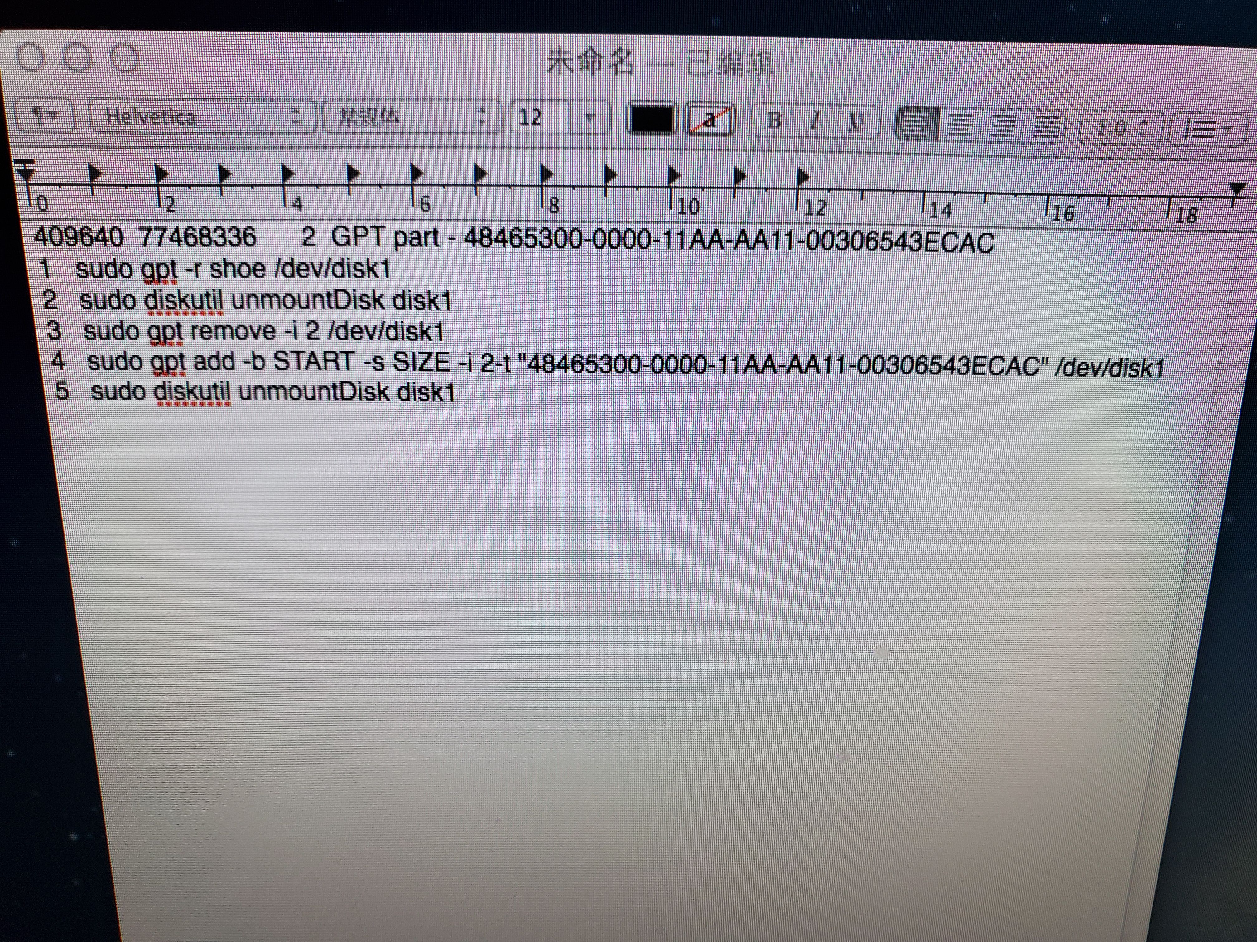

yangbo
Dec 27, 2022
What do you think I can't start it by following the steps? What's wrong

yangbo
Dec 27, 2022
照片是你运行的命令吗?如果是这样:你需要在第4行再运行命令,而不是字面
照片是你运行的命令吗?如果是这样:您需要在第 4 行再次运行命令,而不是字面意义上的 START,使用 409640 而不是 SIZE,使用 77468336
是的,我不认为我在这里得到它。我可以不输入命令行就恢复到内置硬盘吗?
