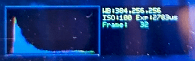

Here is an example of mine during capture. B model v6.8 with a 32GB card. It did the same with 4GB card (just trying anything at this point). I am still willing to hook up a serial reader if I knew what needed to be captured.
Thank you the for video. I think there might be an exposure bias in the non-volatile memory. V6.8 using extra memory locations to store green tint and exposure bias. The firmware assumes these location are zero as initial condition, but what if they weren't. I will work on a variation to test this.
With a serial port it is easy to test. I going to display green tint and ev bias with the histogram in V6.9.

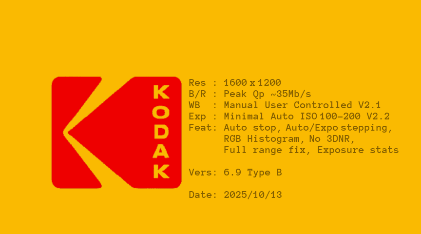

This is an experimental V6.9 for Type B only, just to user with the darkening image.
I might fix the issue, and/or it displaying some of the white balance and exposure settings to help debug it.

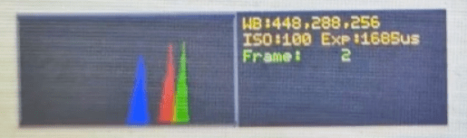

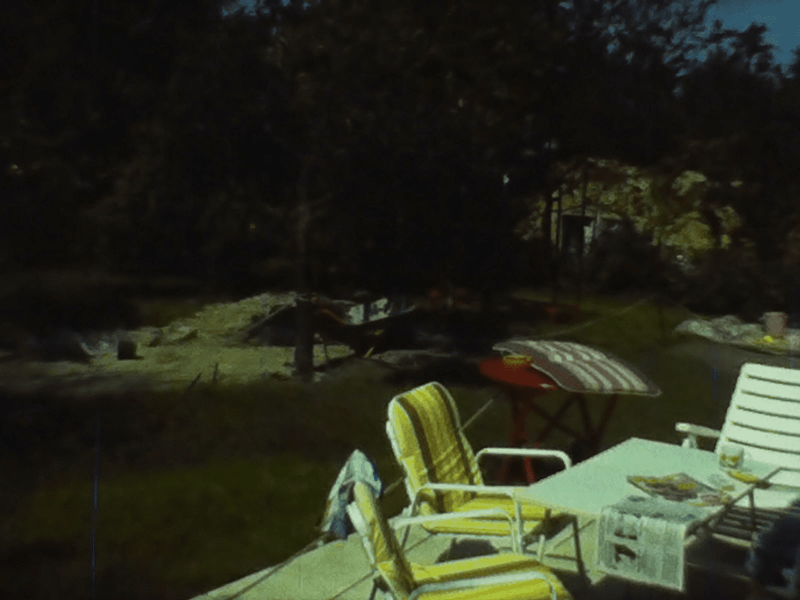

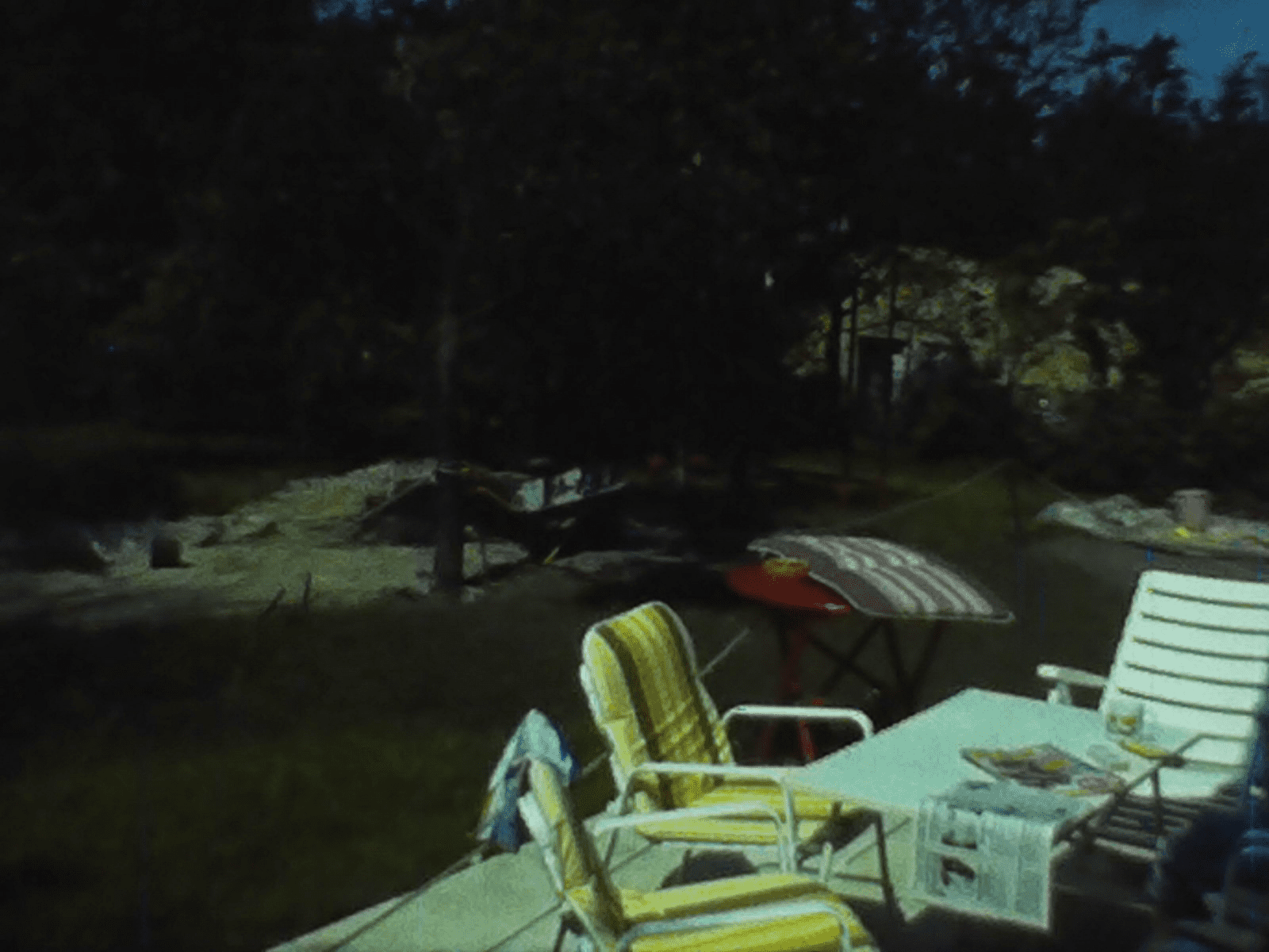

I scanned my testfilm with Version 6.9 and filmed it whit my mobile. I took only the part from starting the scan to the frame 14.. The Exp stayed at 2618 for the following frames White Bal 2.0 Sharpness -1.5 tint 0. V6.9 produces better scannings, I would say the result on the display during capture is OK and is not showing the darkening, but the result in the file is only slightly better. See attached pictures.
Attached the copy of frame with V6.8 and V6.9

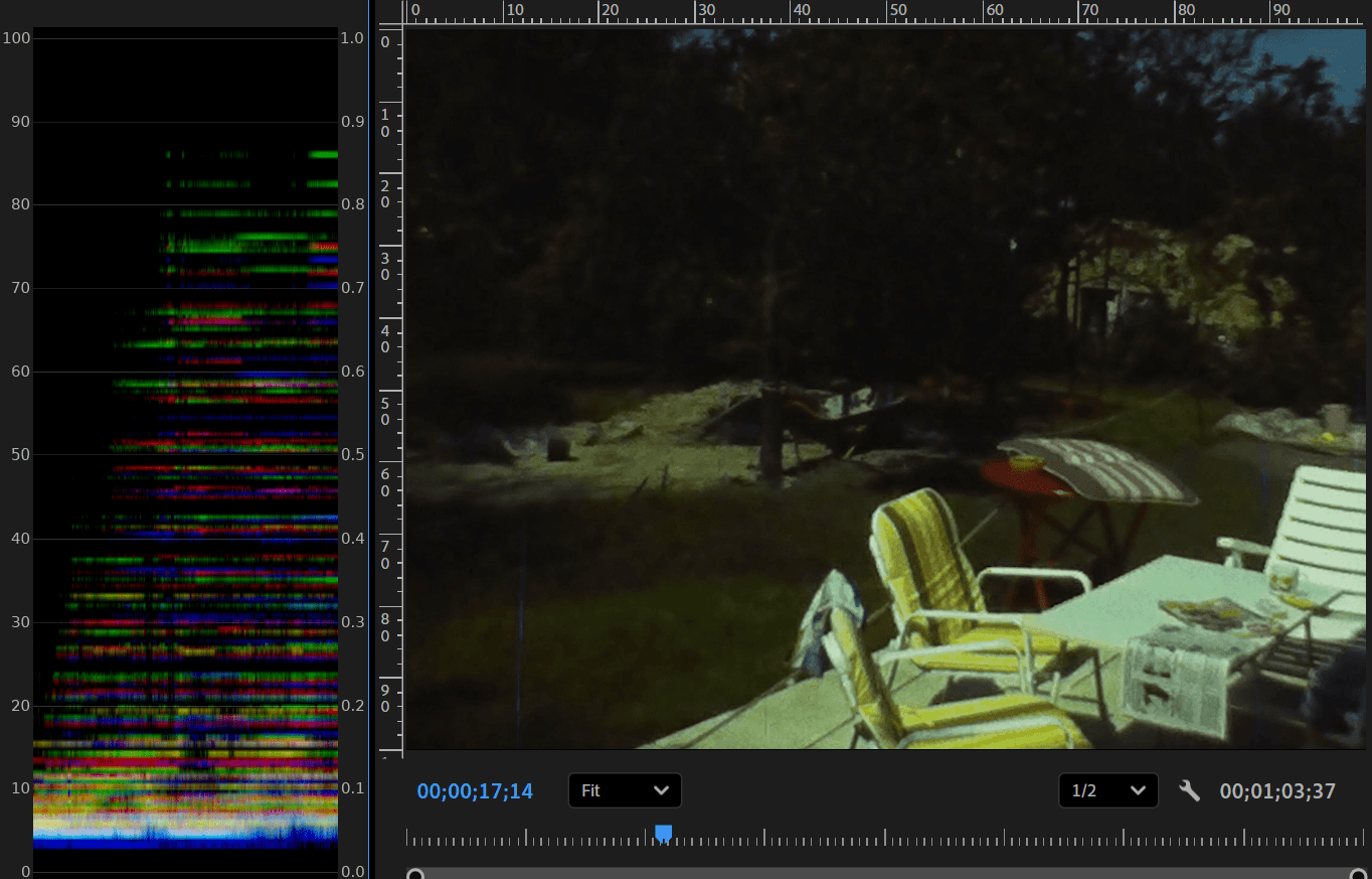

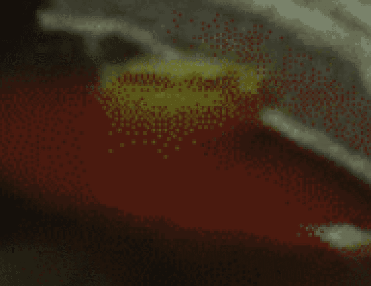

There some confusing element to you images:
Where is this dithering coming from? Was this saved as a GIF, before shared as a PNG.
The image is all posturized.
My scans:
Need to make sure there isn't a hardware issue. You can also do a 50-60 frame scan and share that .MP4.

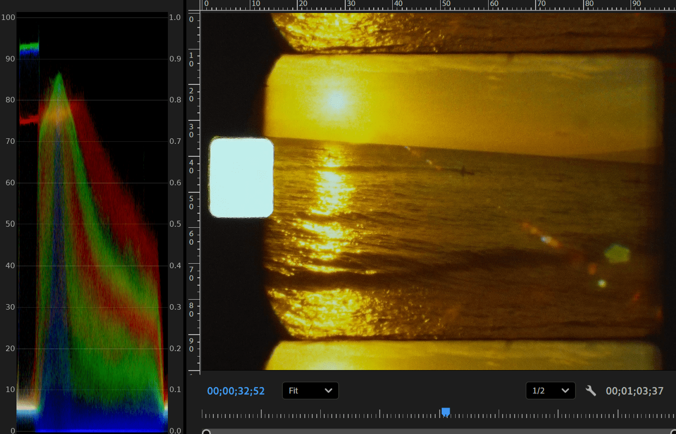

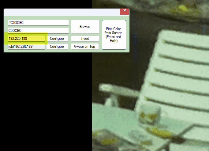

The white level is tad low, yes, also still too green. White is 192,220,188, so red-blue balance is okay.
While this seems to be blue tinted film, as you are setting Red at 448 (448/256 = 1.75 gain), you might want to back that off a bit, say WB 1.5. But the green gain of 288 is also too much. Those three RGB peaks should line up more.
This exposure is based on luminance, which 70% green. So too much green gain (relative to other color), will decrease exposure.
As someone who wants to have non-clipped images, this is close to a good exposure (very correctable.) But I agree it up to one stop under exposed. v6.9 disabled the EV bias code, as that went haywire on your device. We need to determine if there is something different on your hardware causing the posterization.

The "confusing element" is an ashtray in an oval form.
The pictures I attached are only to see the differences, but I use them to modify between 20fps ( in the past ) and 18 or 24fps for normal work with sound.
All films I had reworked seem to be OK, that means I do not have a problem with the pictures. They are produced with

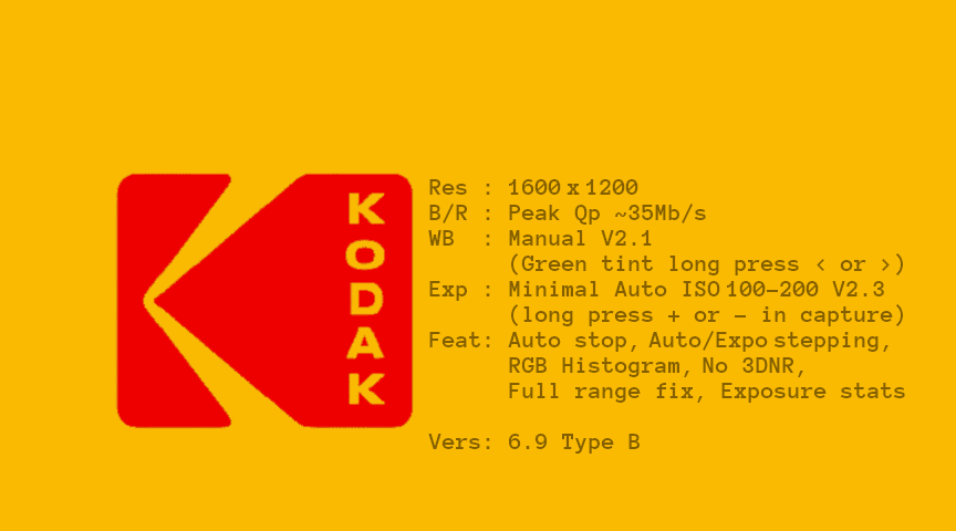

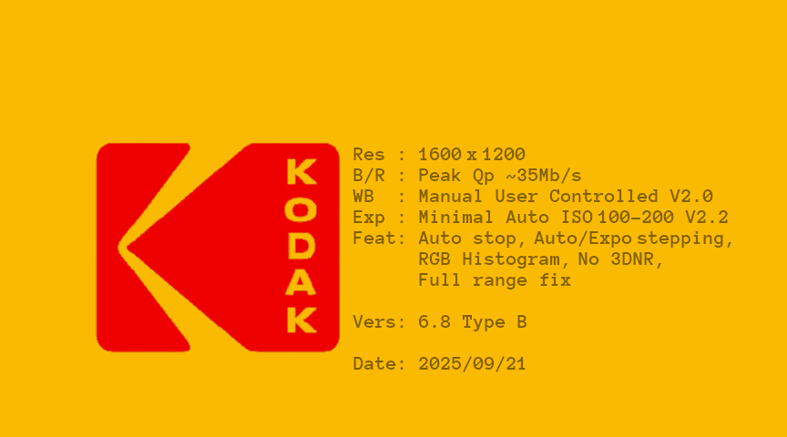

Added EV Bias control + / - key during record only.
Still v6.9 Type B only.
